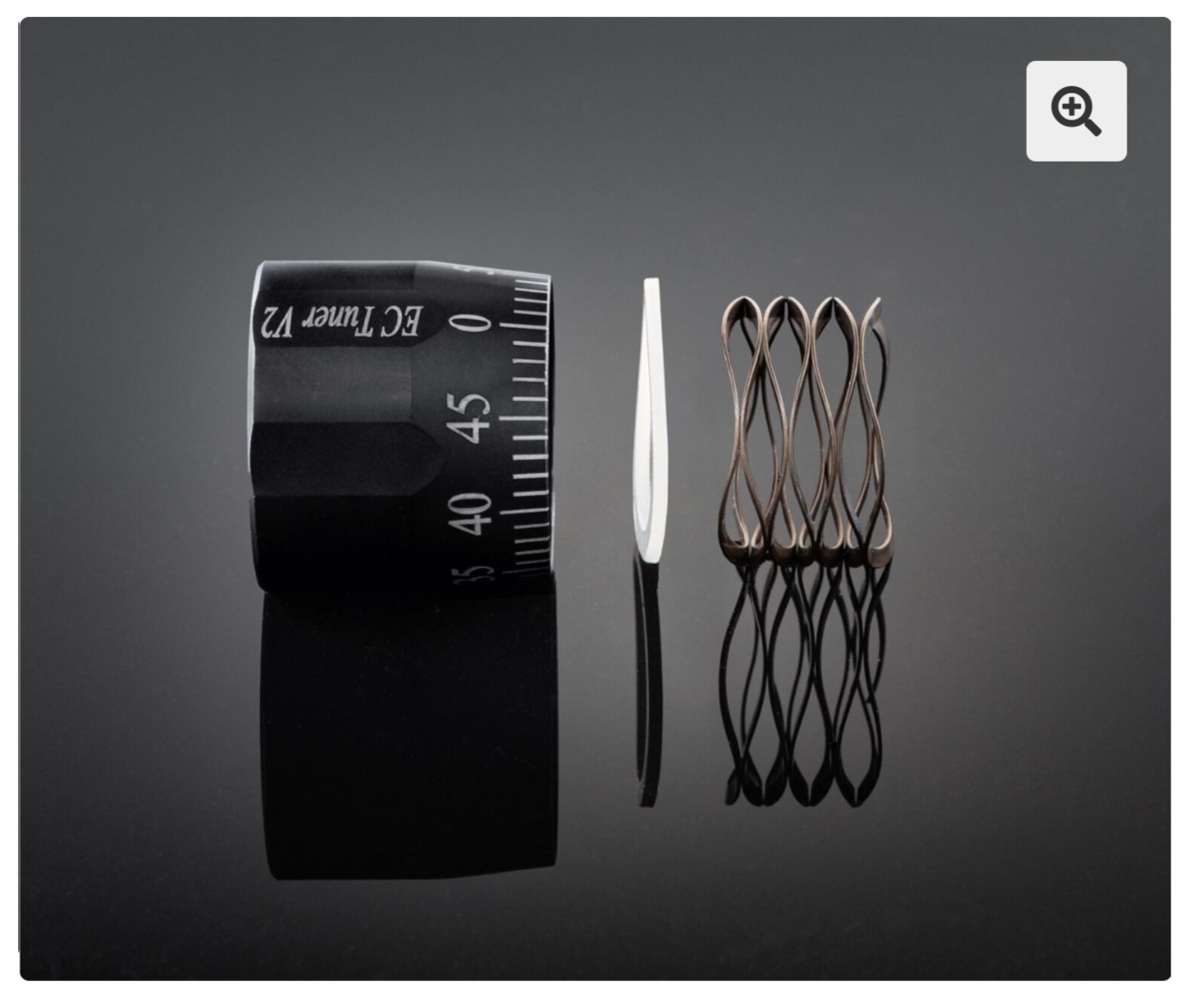

Decided to pick up the EC Tuner V2. Seems to be the only tuner out there that works over 30cal and can be adapted to M18x1 threads. For the steep price point I seriously considered making one from scratch.

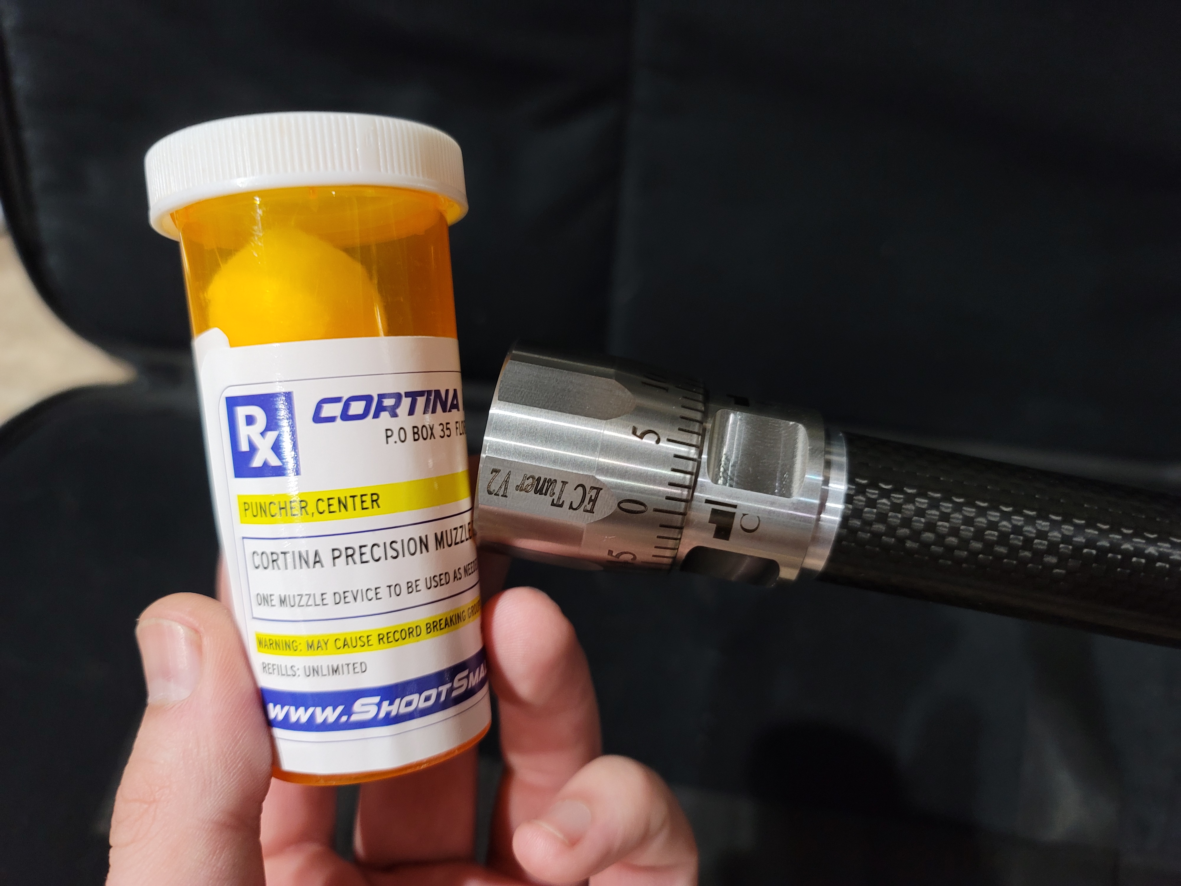

The tuner came in yesterday. Funny packaging!
Over the weekend I had a bit of an Aha! moment... I spent some time at the range tuning barrel tension and wow what a difference. I started by picking a cool looking slug and setting the rattler to max power. From there the only thing I adjusted was barrel tension. That single adjustment took my groups from >4" at 100yd to about 1.5". I think it's safe to say that, after chasing my tail with a million other things, barrel vibration is the main source of my problems.
