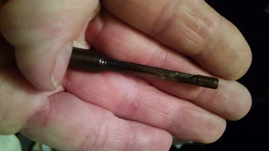

The bbl is a Walther un choked poly , chambered to ,180 dia .200 deep with a 1,5 degree lead. I won't get to experiment more with this gun as it's going home to a nice guy I hope doesn't mind the post...but I thought it was neat and worked well
