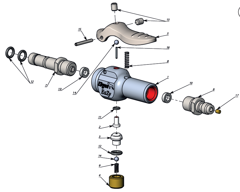

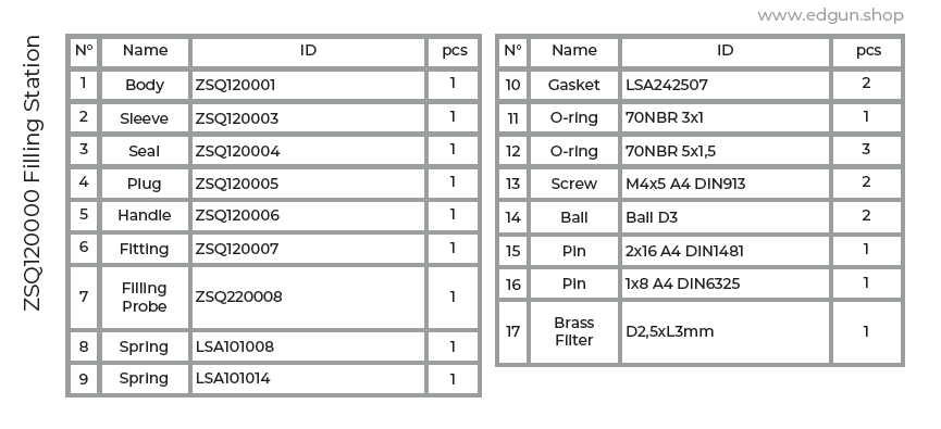

I got some leak from a bottom brass thread cap. I removed all parts in front of me on the table. Looking now for the schematics (BOM), I want to replace both orings ones here. I can measure the smaller oring no problem with that one, but the bigger is chewed up badly, no real ID/OD on it anymore. Only I can calculate from the piston and pocket and come up with my own numbers, I don't think is life critical.
Anybody can chime in?
Reactions: RAMJET66
Smaller oring 2.7x1.0 is on the setscrew side teflon piston, and the brass insert side teflon plug oring is 5.7x1.7 closest I can measure.

Here is the schematic....
Also, here are the O-ring sizes....
