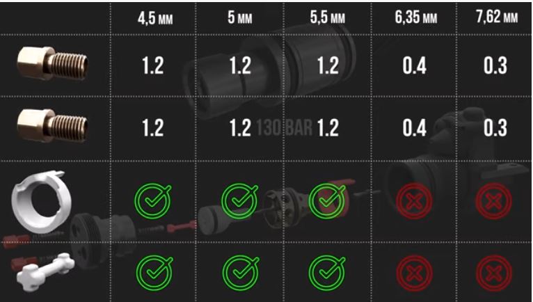

I've got an L2 with 350mm barrel. I was hoping to shoot the .22 25g Monster Redesigns at 975 fps.
I can adjust the REPR regulator to squeeze out 900 fps but that requires the reg to be set much higher than I'd like (about 190b).
Without going to a longer barrel (or using such a high reg pressure) I'm guessing the only way to increase velocity is to change the jets?
Anyone shooting the Redesigns out of a similar setup?

Stock jets in the .22 L2 are 1.4 Stock Jets in the L2 .25cal are 0.4 That's a big difference! So, if you're wanting to shoot Heavy .22 you're going to have to go with different jets. For a pellet that heavy I'd suggest starting with 0.8 and work your way down till you hit the sweet spot. This will also allow for lower Reg pressures.. Just gotta find that sweet spot then Leave it Alone and shoot :)

I'm not running the stock jets. I'm running a 0.5mm and a 0.3mm set of nozzles. One thing to note is that I am running original valve from a first run L2 with an upgraded REPR reg. Newer valve will give a little more efficiency I believe.

Yes, mine came out of the box (repr .22 350) shooting 830fps at 120b reg, but raising it to 145b where it sits now only net me 860fps. I don’t see high speeds being possible with this setup without removing the dog one and collar that were put in the new valve. This is supposed to lower es, and quieten down the valve a bit, but it looks like it comes at a sacrifice of much higher reg pressures. This paired with the larger jets is probably helping hinder our FPS gains. The .25 and .30 don’t seem to have these issues, and they lack those parts, plus come with the smaller jets.
