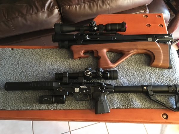

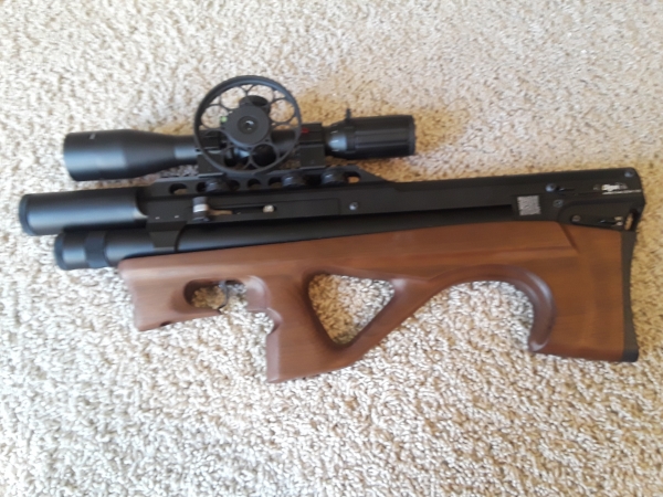

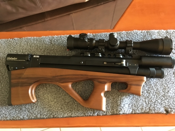

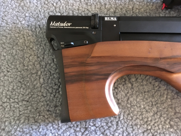

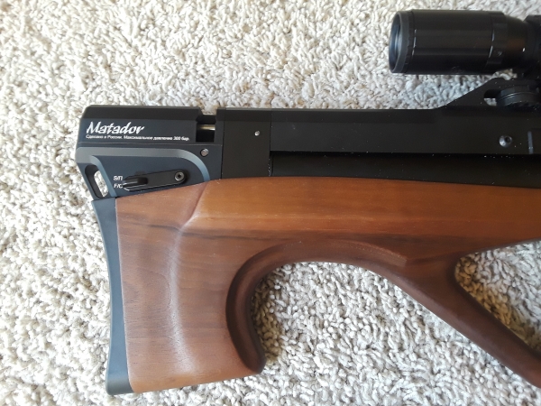

Last week I received my .22 cal Edgun Lelya 2.0, from Edgun West. Beautiful compact gun and very accurate, but I don't know what to call it. Nowhere on the gun is printed Lelya, but instead has Matador boldly printed on the bolt block. I really don't care what model name is printed on the gun, just wondering if Ed ran out of Lelya parts and used a part from the Matador R5M, or if it's just how the Lelya comes now. I've done a search on the internet and noticed some Lelyas come as mine did and some come with Lelya printed on the bolt block.
So far it's been a great little gun. Have the Huma regulator installed, set at 103 bar, shooting JSB 18.13gr pellets at 857 fps, and getting 43 shoots before the gun goes off the reg, from a 245 bar fill.

Just spoke with Brian at Edgun West. He said in order to get the first Lelya into our hands (fill orders) they had to use the Matador receiver. Since the are the same gun, parts can be swaped. Think of it as only the first pioneers (with the lowest serial numbers) get the honor of getting the Lelya-Matador hybrids.
