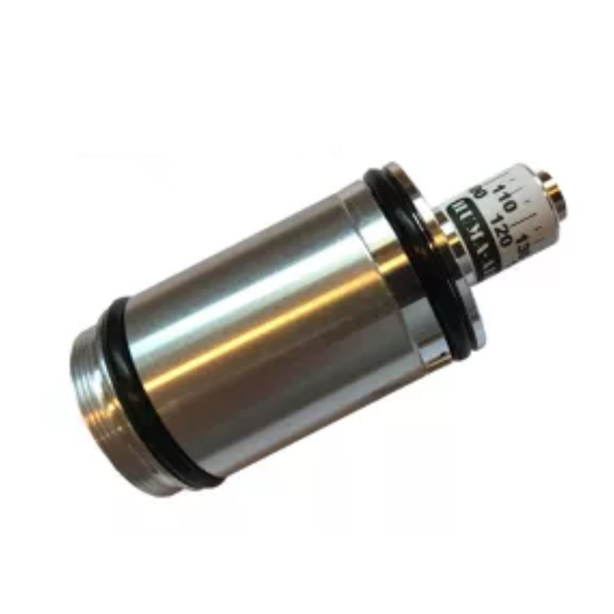

Thanks for this info- I was contemplating getting one from them and he said that the Lelya can't fit a huma reg. Turned me off. Can you post a picture of your stock? I asked for photos but nothing. TIA

2. Asked if I purchased the gun can he install the huma reg from his web site: Brian emails that the new Lelya can NOT fit a huma reg.
