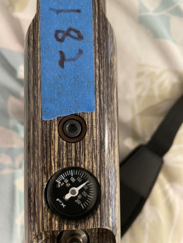

I have an Edgun Leshiy 2 with the largest bottle, which has a max fill pressure of 300 bar. I've only put 16 shots through it so far. After my last shot, I refilled the bottle to just under max (298 bar). However, after a couple of days, the pressure dropped to 286 bar.
I refilled it back to 298 bar, but after a couple of days, it dropped to 290. I topped it off again, and after a few days, it was back down to 286. No shots were put through it...only pressure added.
I reached out to the manufacturer, and they suggested that the pressure fluctuations were likely due to temperature changes. My only other PCP, a Huben GK1 (which has a much smaller air volume), doesn’t seem to experience the same issue.
Can anyone confirm if this is normal, or should I be concerned about a potential leak?

Thanks for the reply. I'm going to let it sit untouched for a week or so to see where it bottomes out at. In your opinion what would be a bar level that would cause you concern on your pcp?
It’s not about the bar level, it’s about the change. Once it’s cooled down it should stay the same. After 2 hours it should be cooled. Write down the pressure. And then check again the next day. It should be close. but not exactly the same. Differences in room temperarure can change a few bar.
example
was 298 next day 296 next day 290 next day 286...I'll check again tomorrow
