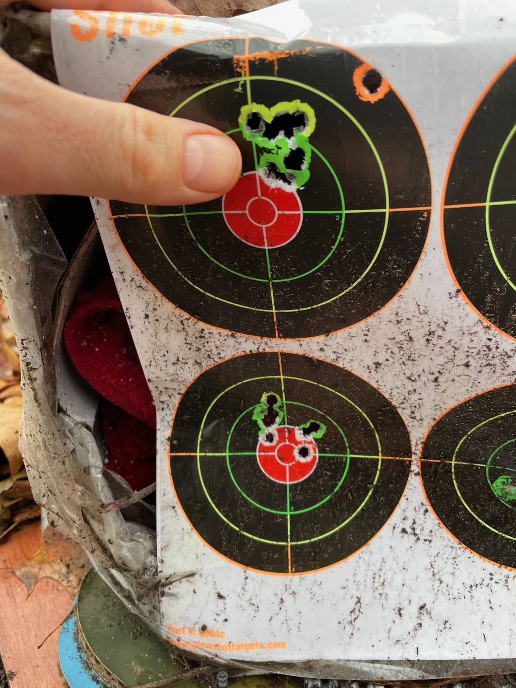

One thing that I've failed to hear mentioned (besides 2nd and 3rd hand reports of accuracy issues) is whether or not the gun was tuned for the ammo. Out of the box the barrel could need a good cleaning - maybe even a lapping (my .22 LW 250mm and 350mm did, but my .25 and .30 Alpha's did not need anything besides a good cleaning of the protective greases).
What ammo are you using? And what speed? Most stock .25s will be shooting the 25gr .25s around 960-080 fps which is just too fast for them and groupings are scattered. Slow them down to 880 and groups tighten up.
Just like any other airgun you need to tune the gun for the ammo you are using or else it may shoot like poop. I've very good 50 yard groups in the huge Leshiy 2 thread but I'll post it here again if it helps. This is 8 shots in .25 34 gr pellets. 7 within close to 1/2" and one random flier.

Here is a 5 shot group , not 8, I got today with the 30 cal 450mm barrel at 40 yards. This was the first time I tried the FX Hybrid slugs. The slugs are a loose fit in the cylinder magazines so if you want to use loose fitting slugs it’s best you leave the magazine in the gun and remove just the backer plate to load. Be also aware that when you tilt the gun muzzle down, the slug aligned with the bore will slide into the bore. This doesn’t create any problem unless you don’t look to see if there is a slug in the bore and load another slug on top of it. That is what happened to me and I marked the first shot on the target I took sighting in a new scope which was two slugs in one shot. It is easy to see the base of the slug in the bore through the magazine. At the same tune I get 910 FPS with the JSB 45 grn pellets but the Hybrids seem to shoot a little tighter groups but this is the first magazine of the Hybrids and the faster I push the pellets the better they shoot. I’m at 160 bar with one .20 nozzle. For what it’s worth I also shot my new FX Maverick 30 compact today for the first time that came out of the box with 150 bar reg setting and with max hammer spring setting I get 850 FPS with the Hybrids and the Leshiy shot a tighter group today. I will be getting the power kit for the Maverick which should up the velocity past the Leshiy and I need to try other slugs in both guns but I thought it interesting how close these two different guns are performing for me. now I expect it will be different another day.
