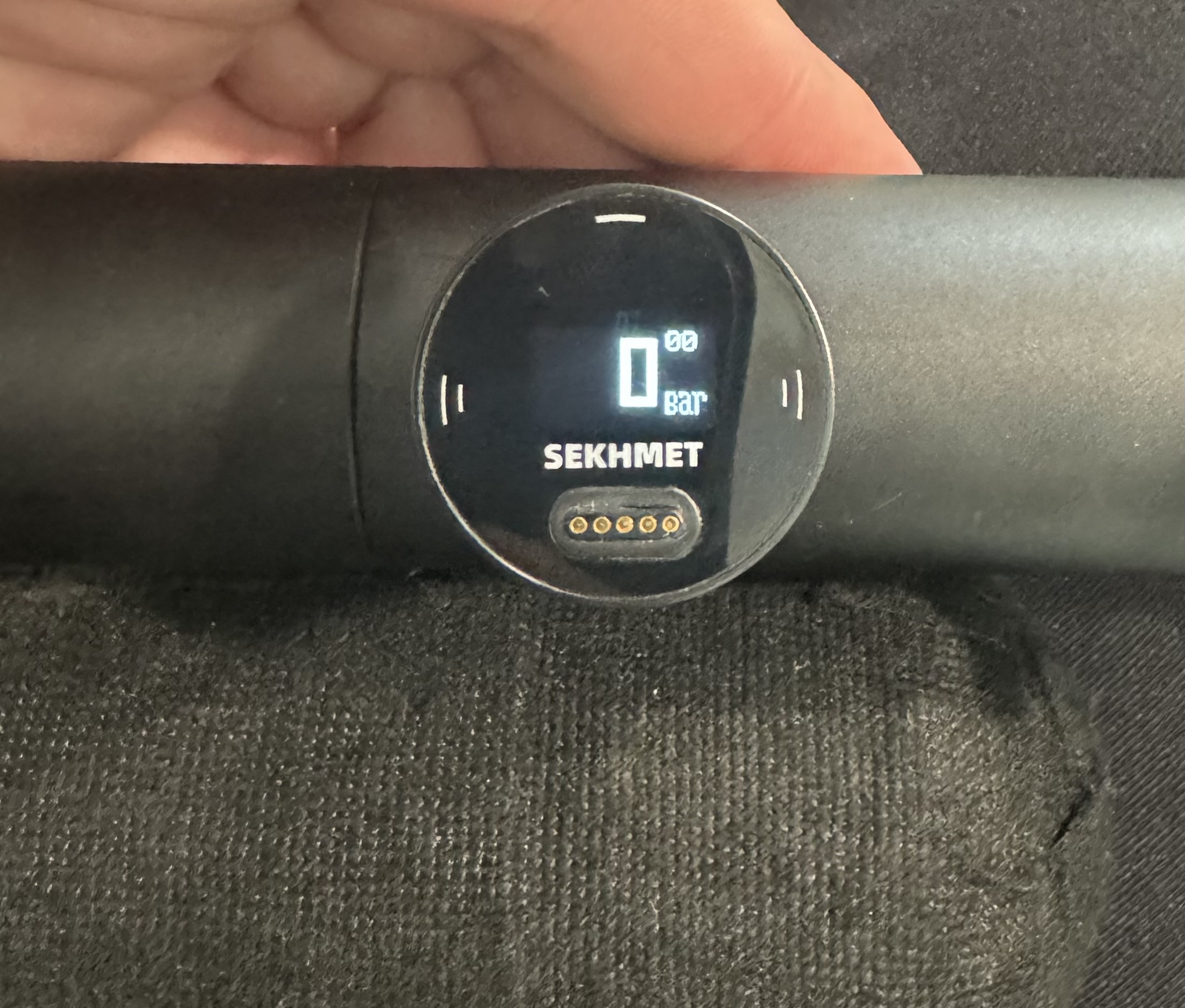

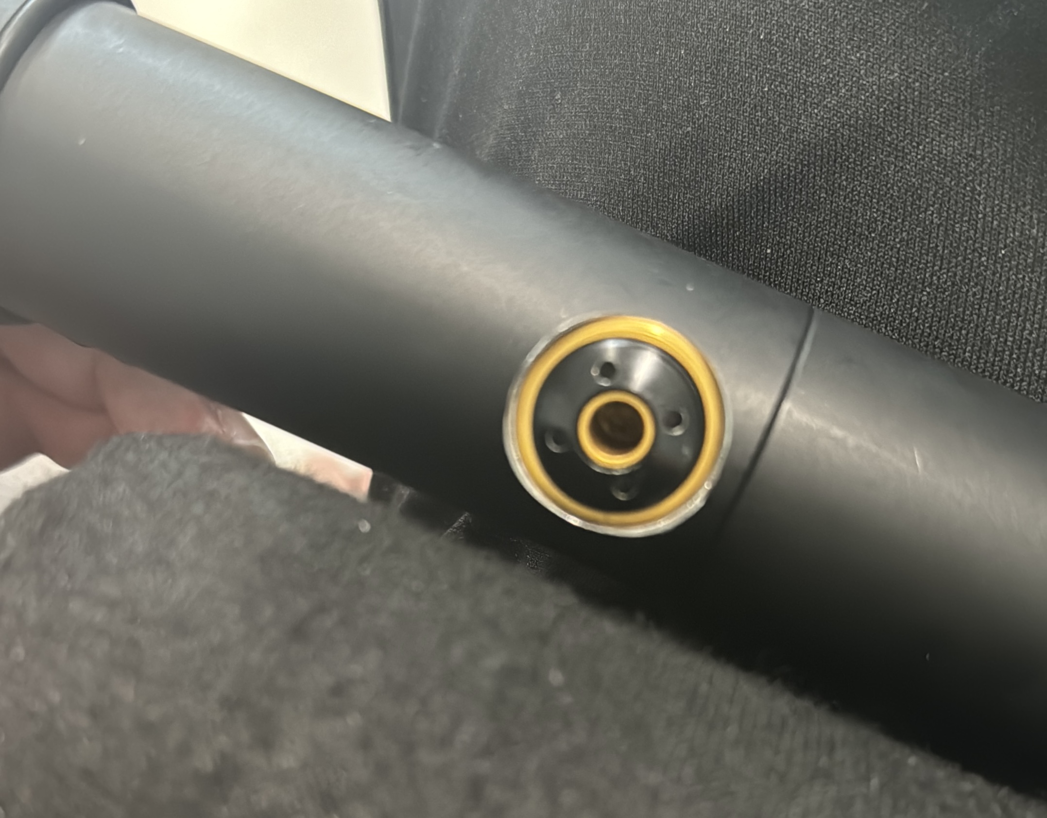

Guys i need help the Repr gauge in my Leshiy 2 is locked and i dont know how to fix it. My Leshiy doesnt have the secondary bleed screw in the rear so thats not an option. I tried loosening the black adjustment cap and it feels like its under pressure and idk what to do.

High pressure side has a check ball (very small) that keeps the air from entering plenum. The piston has a probe that pushes the check open via spring pressure. As plenum fills, pressure counteracts the spring. This pushes piston probe back away from check ball.
At this point, the oring can extrude and basically lock the piston in place. As pressure in the plenum drops (from shooting), the spring cannot push the piston back to open the check, creating the locked regulator.
