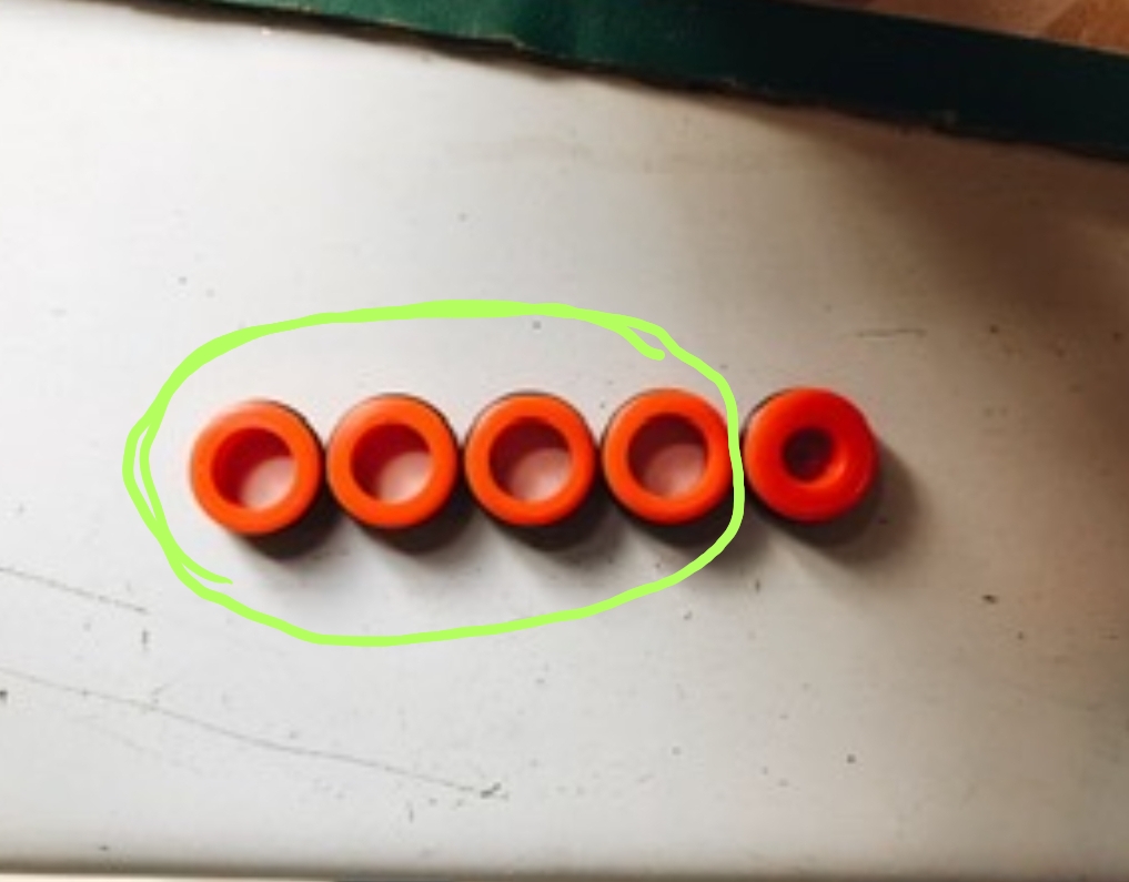

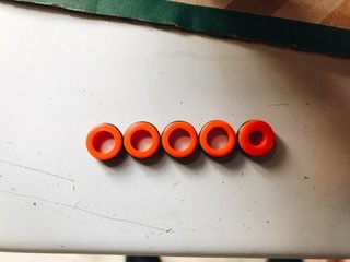

Pucks are removable and you get 3 extra spares of same size and one that is solid/closed for 3 Joules of power per Brian’s report.

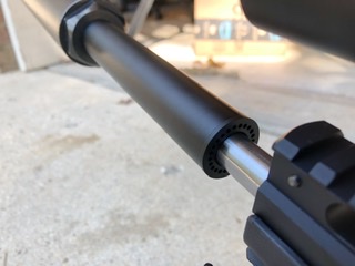

Noise: Gun sounds exactly like a nail gun going off. So be aware it is loud, at least in .30 cal. This is with stock suppressor. I will test it with the Valkyrie kit soon to see.

Here are the pucks I was referring to.
Noise level is extremely important to me for the shooting I am able to do. Please let us know how well the Valkyrie kit softens the sound.
Also - without the hammer is the entirety of the sound just the pop/rush of air?

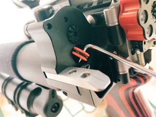

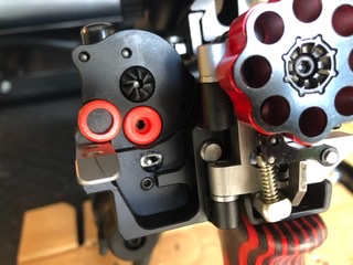

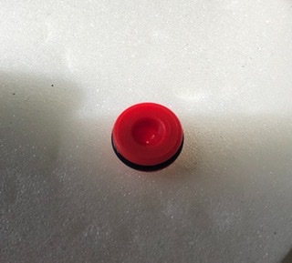

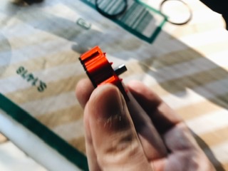

So I took the small puck that has a tiny pinhole in it rated at 3 Joules and went ahead, for science, drilled it out stepwise with larger diameters and checked velocities using 44g JSB’s. Here are the results.
The first pic is the stock restricted puck. The second is the diameter of the drill bits used to enlarge the hole. The last pic is a comparison of stock 805fps puck installed in the gun out of the box and the drilled out puck shooting 603fps with same 44 grain ammo.
Also, the noise of the gun is now SIGNIFICANTLY QUIETER, like mouse fart shoot all day in your back yard quiet!

I wonder why you would get 4 of the same diameter iso varying sized, is it because the part is wear sensitive?
Because someone is going to shoot the gun without the magazine installed, it will fly and end up in the same dimension as one of your socks end up when they go missing from the dryer
When Ed has an extra few I will order more 3J pucks
I will make a video but I want everyone to know you should not use the 3J puck as it comes, the hole needs to be enlarged, there is too much pressure on the locking mechanism while using the pinhole 3J puck ...ok back to work
