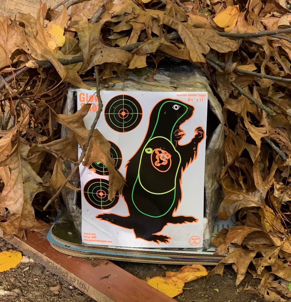

Is the Leshiy 2 accurate? When was the last time you did a 4x tap into less than 1" at 40 yards?
Above target @ 42 yards with 8x scope. JSB 15.9 @ 700fps. First shot upper left in the green. Then three shots into the red. The a 4x tap into the red. I mean seriously - pop, pop, pop, pop in under 3 seconds and under 1.5" group at 42 yards. I am pleased - my neighbors probably not - the Leshiy 2 is not backyard friendly even at 80 bar. I had a thwump sent back at me from the end of the yard at ~50 yards that I felt.

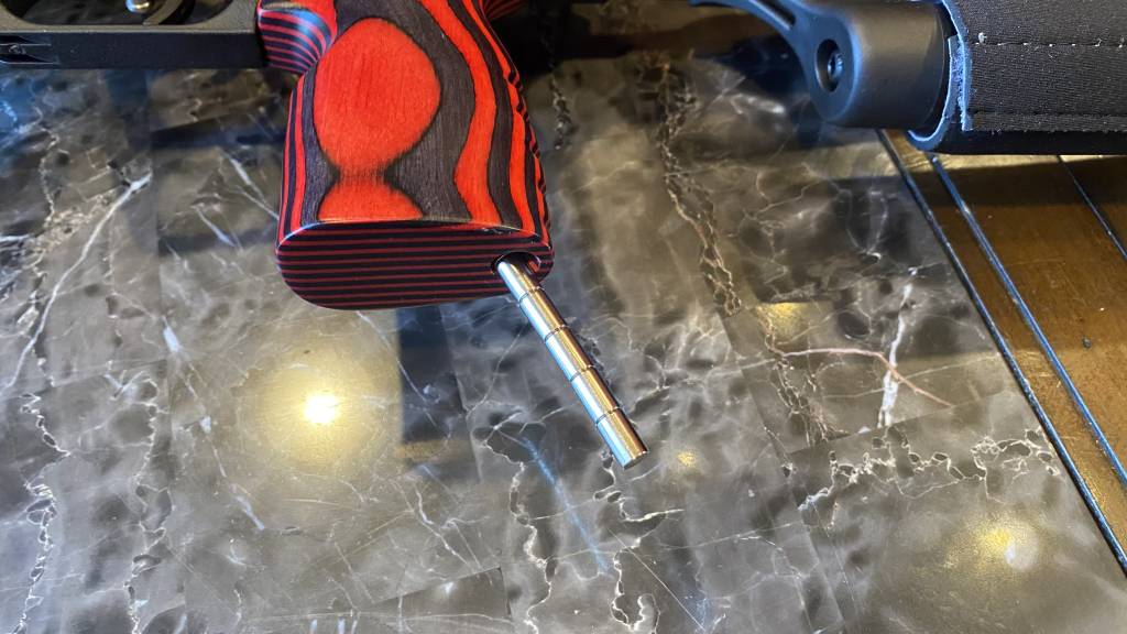

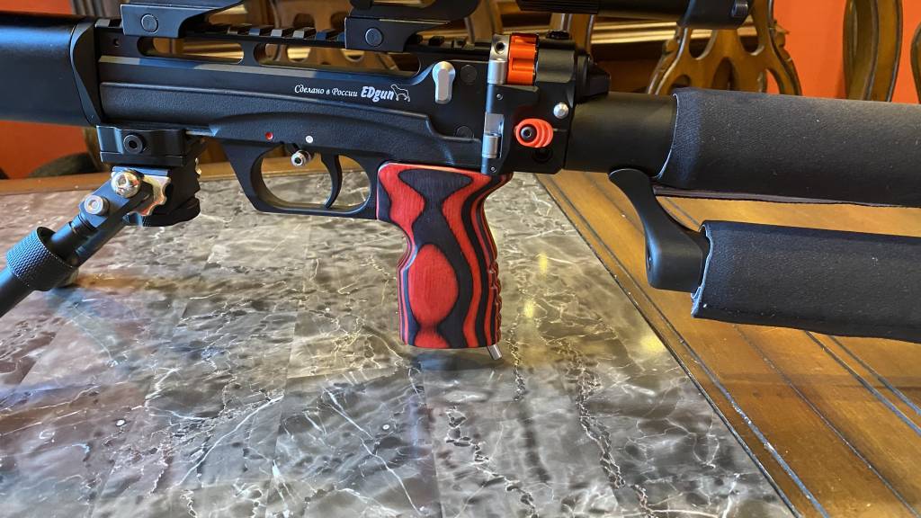

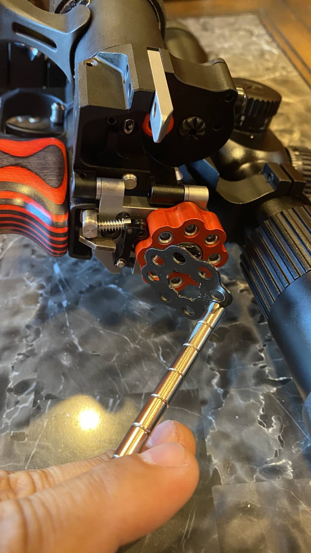

The regulator seems to adjust at about 10-12bar per hour of rotation. Access to the regulator is well thought out. Bleed the air (see pic above), slide back neoprene sleeve and the top tube unscrews in the middle for easy reg access.

The reg is pretty easy to get to. Bleed the air using the tiny grub screw - it's in a picture circled if you go back a few posts. Then slide back the neoprene sleeve and you'll see the split in the upper tube. Unscrew at that split. The reg has to hex screws - the top one I believe is just to hold the setting in place and it's a 4mm hex. It's threaded CCW rather than CW so keep that in mind. Under that is the reg set hex which is 3mm. As I mentioned it's about 10-12 bar per hour of rotation. CW to lower pressure, CCW to raise pressure.

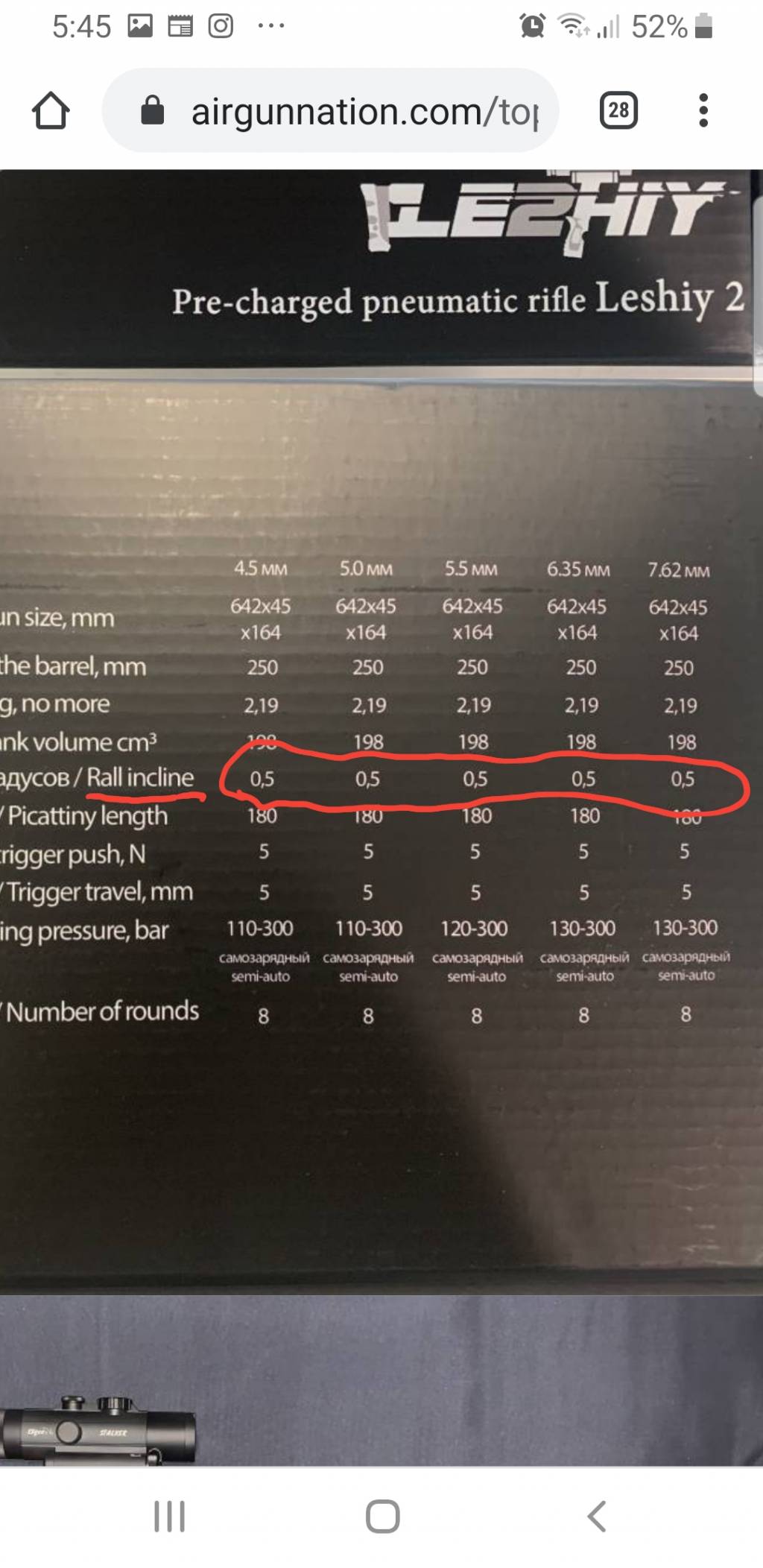

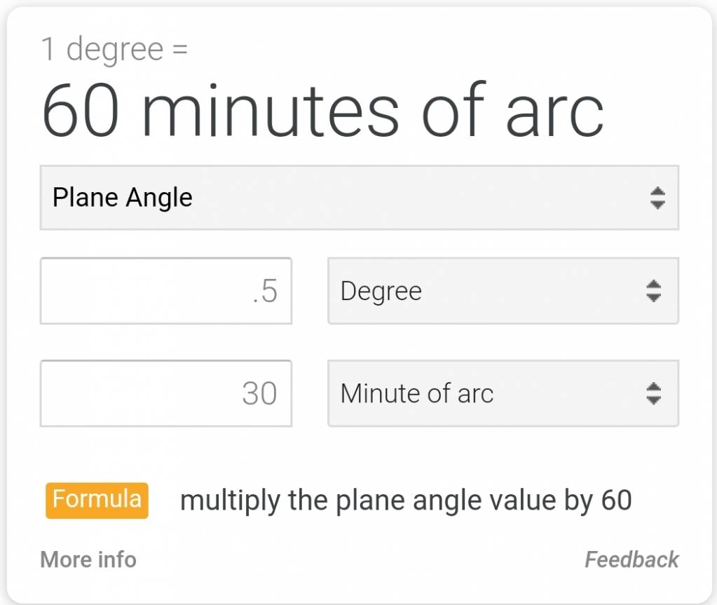

I pulled a scope off an old Matador R3, and after moving to the Leshiy 2 it was about 5 minutes high. Pretty much everything I own inc. powder burners has 20-30 minutes built in.
Just sharing the info because a lot of other manufacturers still don't take this into account (FX, Daystate, etc). Sometimes, special rings or bases with fixed or adjustable MOA have to be purchased. Considering that shooting .25 and .30 calibers at slower speeds or pushing them further out, it's reassuring.

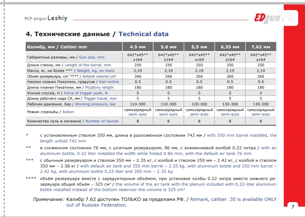

About the trigger. let me explain the situation.
1. That is semi-auto. Plus to that fact that is semiauto gun which is ready to shoot immidiately as soon as it is unfolded if the pellet is in the magazine.
So, we decided that it would be more safe to have not very light trigger from the safefy reason. So, it weights about 0.8 -- 1 kg. OK, for exemple my Remington R-25 .308 win has 2.3 kg.
https://youtu.be/Iz_8PEA3RaA?t=293
and that still allow me to have the accuracy at 100 meters 17 mm on the edges of the holes with RWS 12.3 grams bullet.
2. While pushing the trigger the shooter pushs directly to the valve.
No doubt we would make some intermidiary mechanismus to make it smoother and lighter, to use a very light hammer etc. But our task was to make as simpliest (read relaible) gun, as possible. That is why not hammers, not intimidiaries rods, levers etc. In fact you just direct pulles the initial valve to open.
3. The small amount of air released if you are able to push the trigger slowly.
That is the system of the valve. To open the main valve one should open the initial valve first, by pushing to it directly. There is a ball inside, 2.5 mm diameter, so you are directly push that ball, which is pressured with the 130 bar (if the regulator is set to 130 bar). If your fingers are sensitive enough you can keep it a little be opened to hear the sound of the air going out of the main valve chamber to the atmosphere, as soon as the volume of that air gets the definite amount, the main valve opens.
Don't forget that is not the classical PCP valve, that is something new. To me it has more advantages, than disadvantages in comparison to the "classic" sheme. Just get used to it, like you get used to a new car, house, wife... :)
4. The power regulating.
The simpliest is to regulate it with the setting the regulator. Yes, to regulate it with the puck :) doesn't give you too much adventage from poin of view the air consumption, it can just decrease the speed of the pellet. Here we go again, like with Matador and other guns made by us -- too much energy for the backyard use. And that is a real nightmare for me regarding guns shipped to UK with their stupid energy restrictions. Just take into consideration the fact, that I develope the guns to get as much energy as possible and all is focused on that. No doubt I know how to depress the energy not with the regulators or pucks, but I doubt that majority of the users can do that without the special skills. For those with the right hands growing from the right place that is not a problem, no doubt, but having the experience of what people are able to do with the guns, considereing themselves a real masters, not being in that status holds me not to tell how to do it :) Sorry for that, but I prefer to tell everything directly and honest. So, I am thinking now about the best solutoin regarding this. For now it seems to me that the best solution woulcd be to instruct the representatives how to do it. but they have to get the instructions from the users, what energy they would like to have with their guns :) But people are so changable, you know, today one wants to kill rats on the backyard and tomorrow to shoot 200 meters long... Those are contradictory tasks... I am thinking...
With the best regards
Ed
