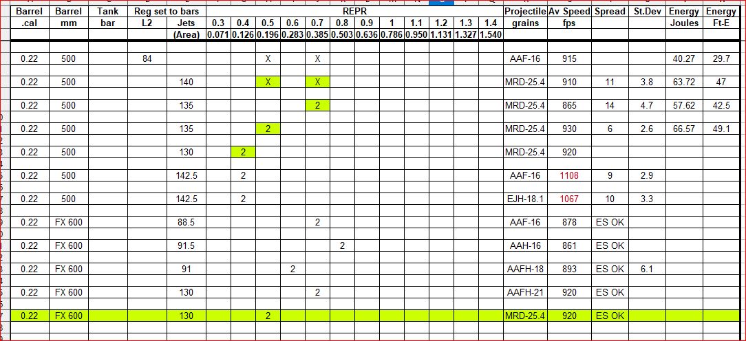

And then you would want to write down everything, eventually in a spreadsheet... you know that, literate people writing it down and iliterate remembering?

So fps is 727-720 shooting 25gr so not as fast as I thought but still from a 200bar fill is right at about 4mags. I think its terrible but hey what do I know. Thinking m3 might be the better option or just be happy with my commader xr and wolverine r 2
200b or 300b? 200b is super low if the reg is set at 130 or so. You have 70b to play with, so that’s 36 shots on 70b or less than 2b per shot. That’s pretty good efficiency from a gun that not only uses air to fire the pellet, it the cycle the magazine also.
