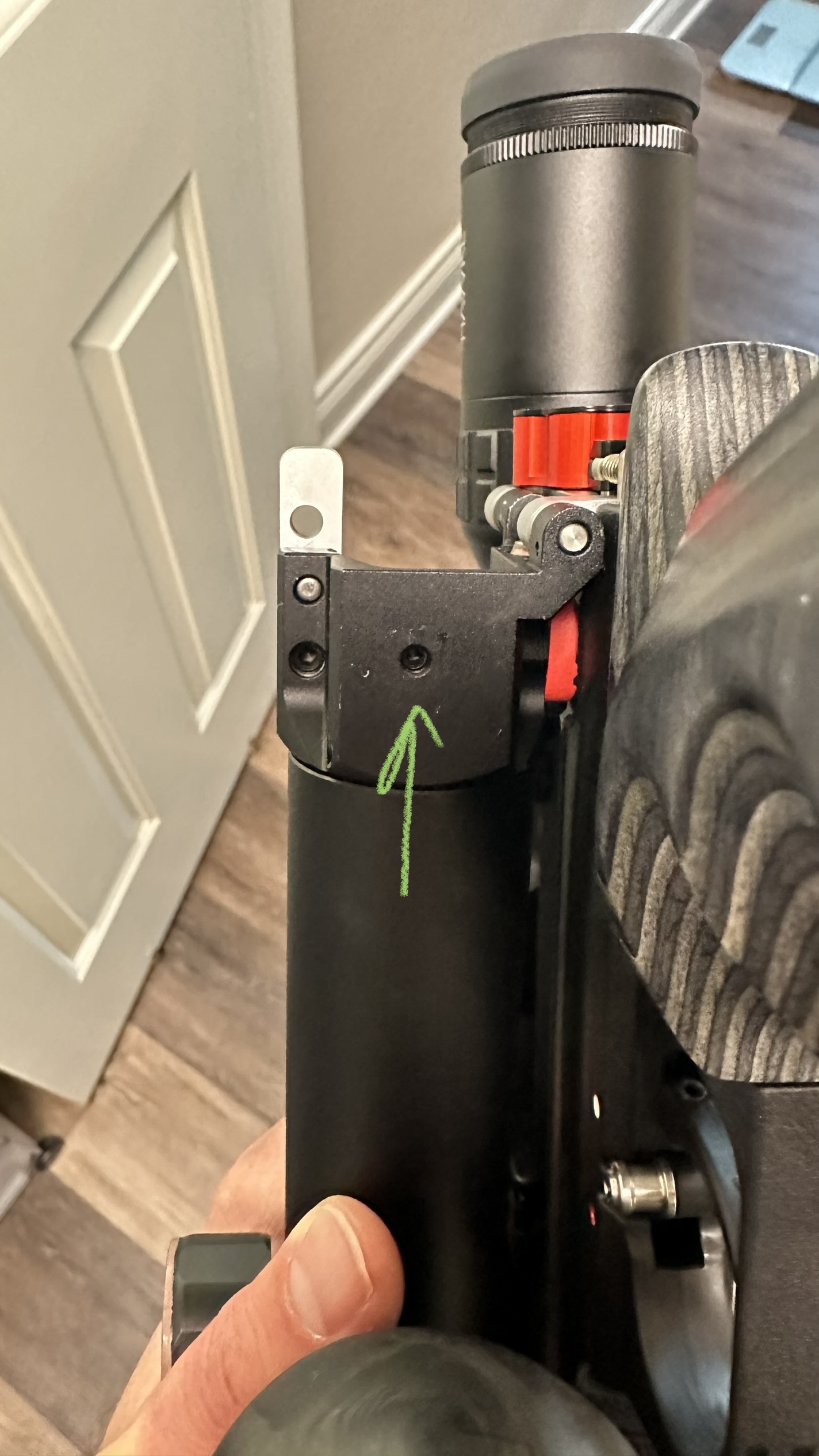

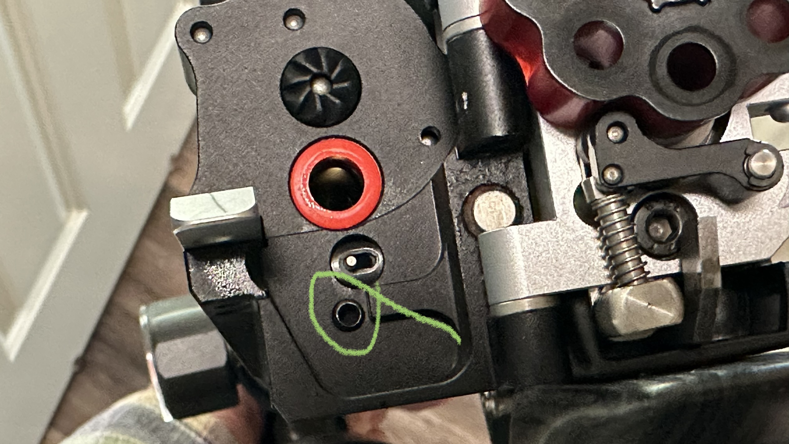

Y'all forgot to mention that the trigger waste-gate can be adjusted. This can also minimize the noise level and wasted air. Loosen the grub screw underneath the air cylinder, back out (increase the length) of the grub screw on the rear, tighten the grub screw underneath to lock it in place. Note that backing out the grub screw too much will restrict the airgun from firing. I like to adjust mine “just enough” to fire.
View attachment 305855View attachment 305856
that was the first thing Brian told me to do, but it didn't work sadly enough

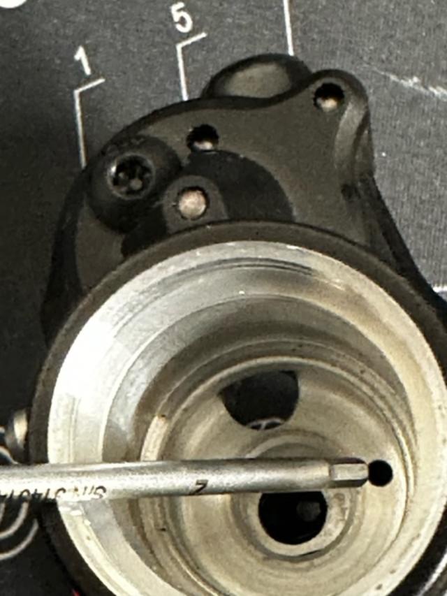

You might need to open up the valve and check all the parts. It could be a stuck nozzle or maybe a part in the valve. Tear in an o-ring, something basically preventing the valve from closing up in a timely manner.
When this happened to me I had tear the valve down and adjust the trigger stopper. Just the trigger stopper was insufficient. Something got stuck because of the dump.

thank you, i just disassembled and checked everything, nothing was broke like the ball, springs or struts, maybe it jammed up?i did the stopper adjustment previously first and didn't work. i'll try to test it out later and see if it worked from the value dissasembly

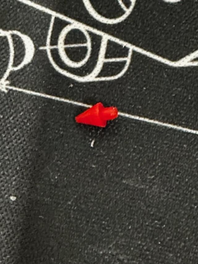

so it seems like one of my Poly Mags red tips was defective and got logged into the value, therefore causing all the problems. would this be a one-off defective ammo? i will just stick to NSA bullets and slugs, JSB's that are proven to work and not a gimmick maybe?
i'm kinda kicking myself also since I disassembled the value and didn't even catch that red plastic piece stuck there.
ETA" Brian said it took him quite a while to find out what was wrong too, now i don't feel too stupid, lol
