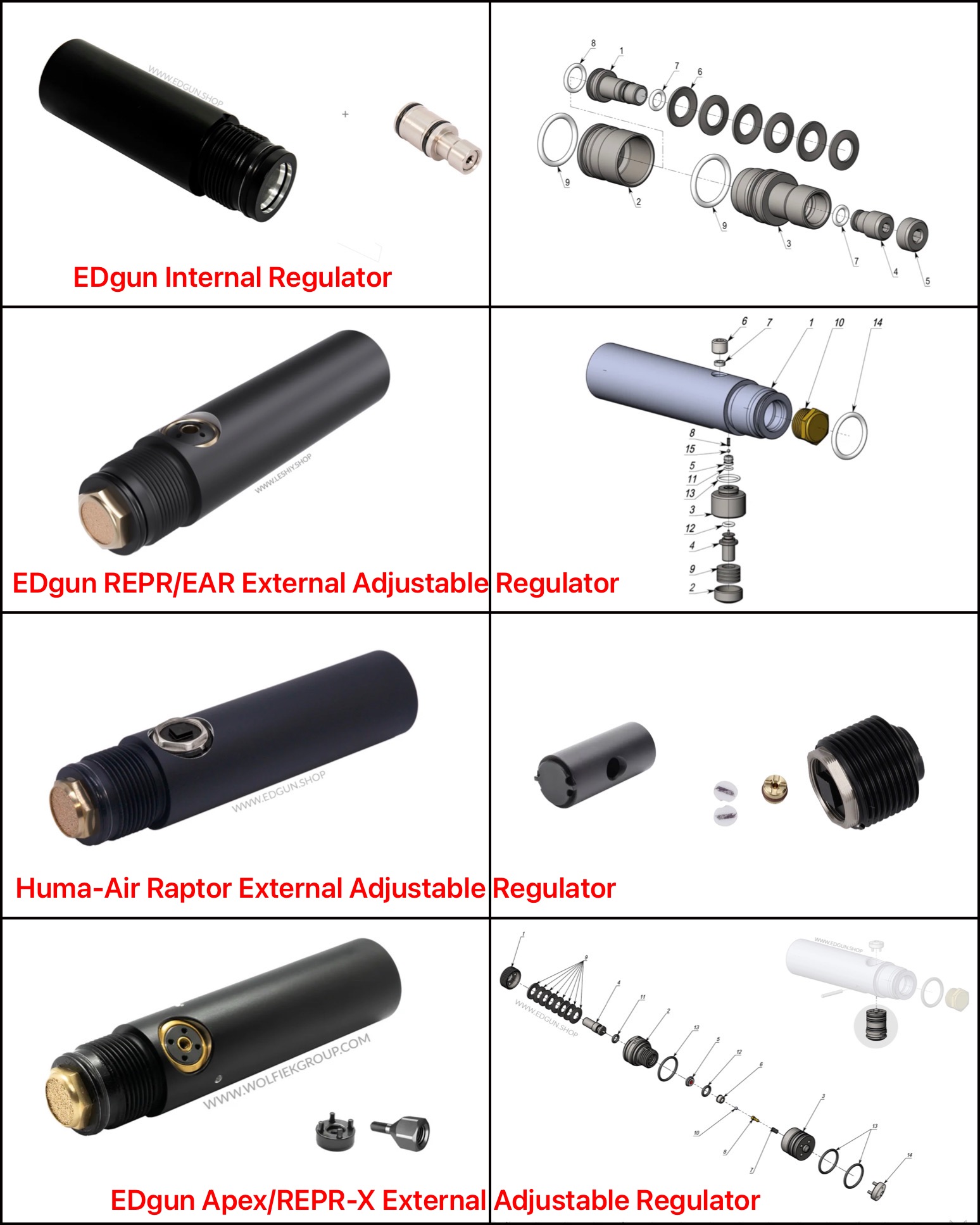

REPR or EAR = old external regulator (works fine on my gun)
Raptor = new version of the regulator
Wolverine and Raven, Valkyrie = variations on the look of the gun

REPR/EAR is the 1st generation EDgun Externally Adjustable Regulator
Raptor is the Huma-Air upgrade to the 1st Gen EDgun REPR Externally Adjustable Regulator
APEX/REPR-X is the 2nd generation EDgun Externally Adjustable Regulator

So this is very useful. Thank you! Is there any information of what got better with the latest REPR-X? I am looking at a listing here with another member in this thread, and I was wondering if there is way to tell which L2 regulator he has got for sale. It is a 2024 L2.

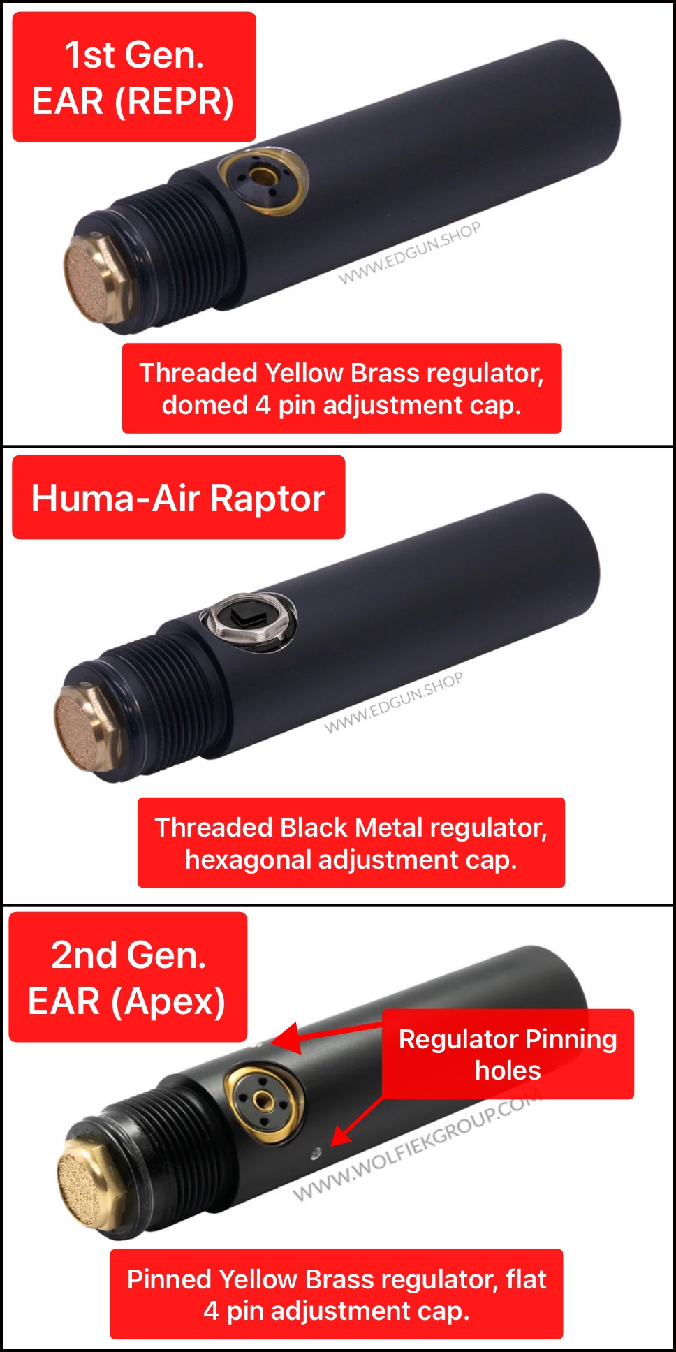

Sorry for the late reply!
For reference:
1. The 1st generation Externally Adjustable Regulator is threaded into the Plenum.

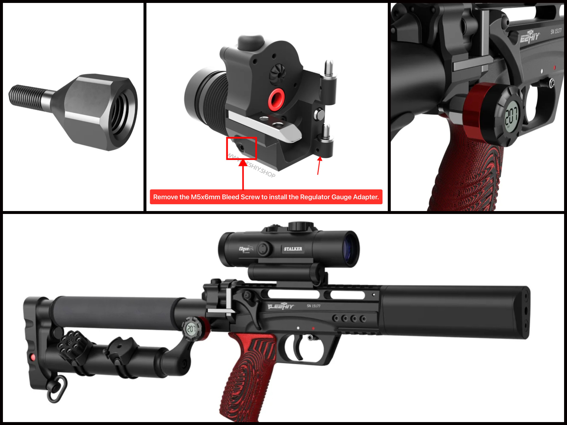

2. The 1st generation EAR has a gauge port, on the Plenum, opposite side of the adjustment cap.
3. The Huma-Air Raptor Regulator can only be installed onto the 1st Generation EAR, with the threaded Plenum.
4. The 2nd generation EAR is not threaded into the Plenum, it is held inlace by a pin.
5. The 2nd generation EAR does not have a gauge port on the Plenum.

Sorry, late reply. I did not. I haven't seen one I am set on. I do see one listed in the classified, but it has the gen 1 EAR (REPR). Any real benefits between the REPR and the REPR-X? I would say not having to thread the regulator?
A benefit of getting the Gen-1 REPR is that you can upgrade to the Huma-Air Raptor. Both the REPR and REPR-X have been reported to have the same pressure drift issue. Also, you can install a Regulator gauge on the REPR Plenum, if you like to monitor your regulator pressure.
