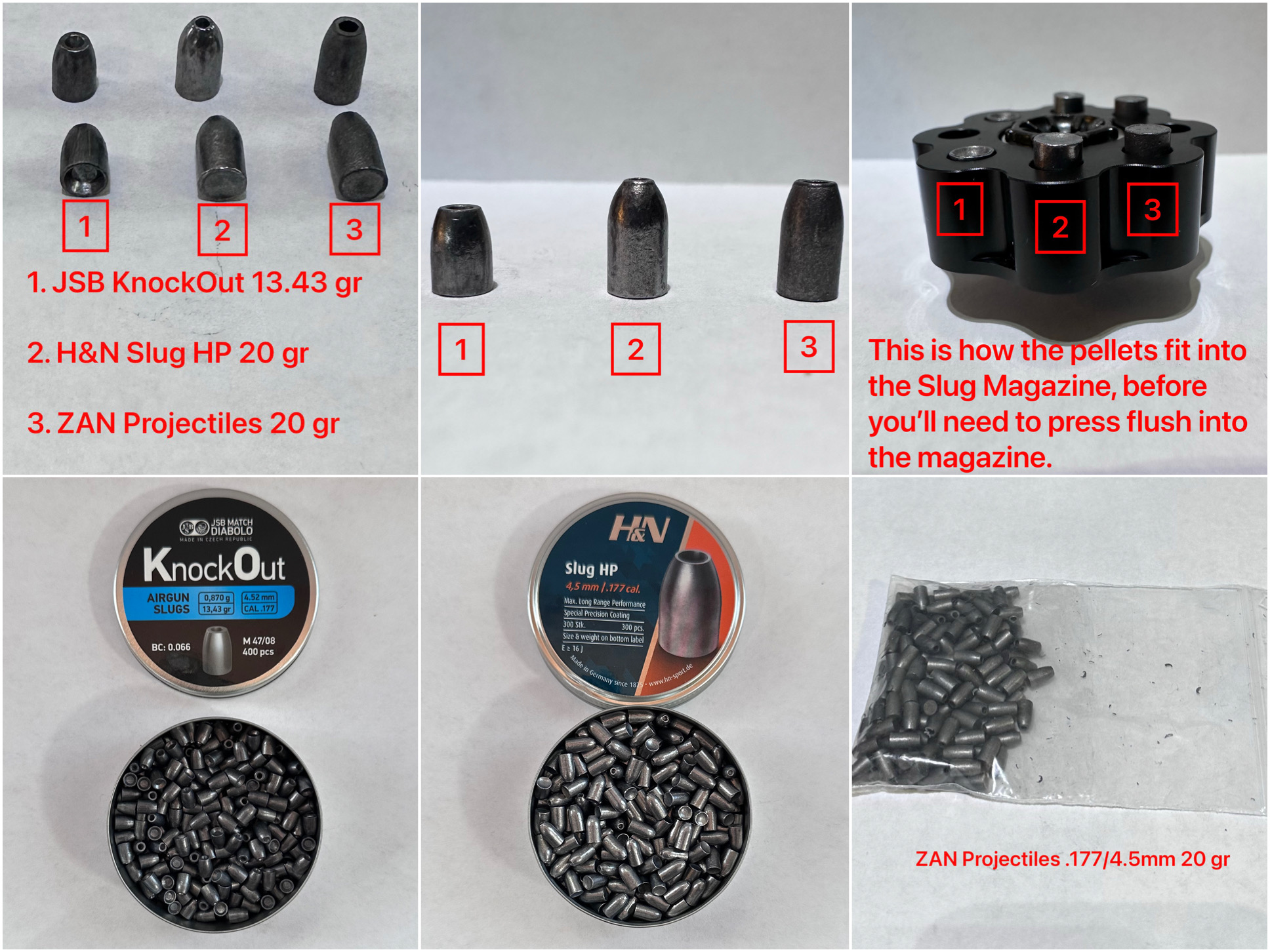

Here is an illustration of how .177/4.5mm slugs fit into the EDgun Leshiy 2 Slug Magazine.
The 13.4 gr slugs drop right into place, just slightly proud, and become fully seated when the magazine plate is attached.
The 20 gr slugs require a bit of thumb pressing force, followed by a final seating by pressing the magazine plate on each slug, to seat the slugs into the magazine.

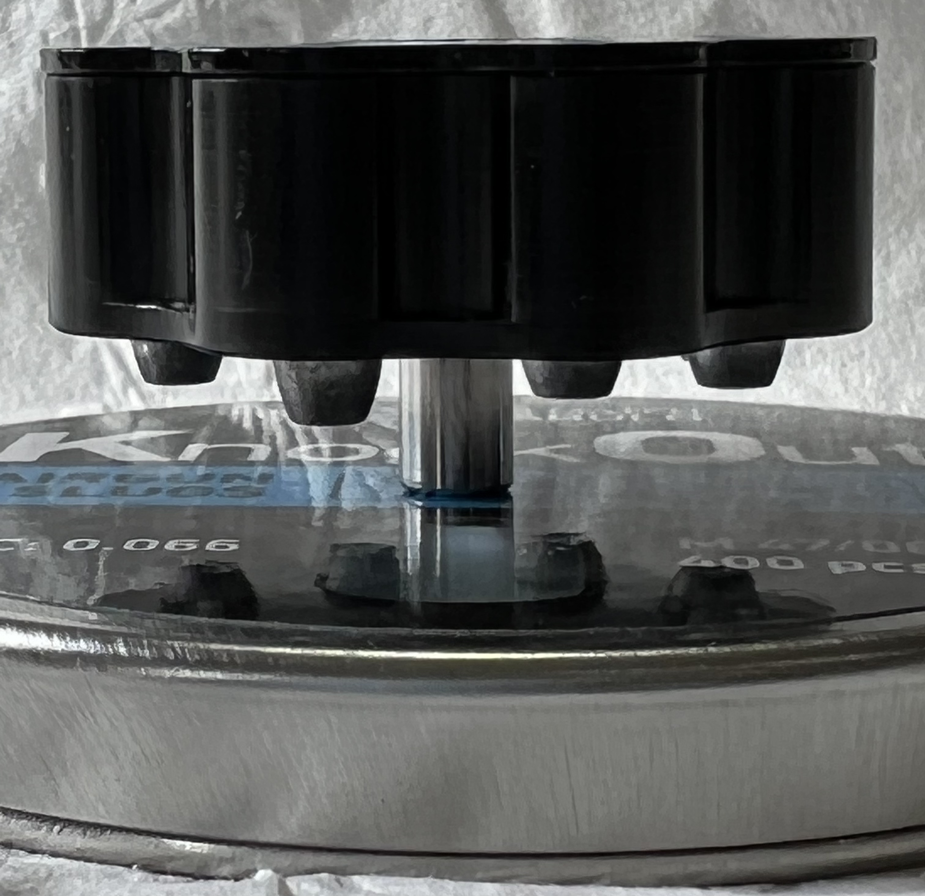

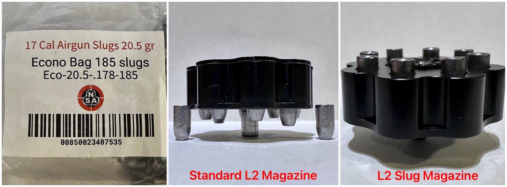

The 13.4 gr Slugs will partially protrude from the bottom of the stock magazine, as pictured below.
The 20 gr Slugs, will mostly drop right through the stock Magazine.
