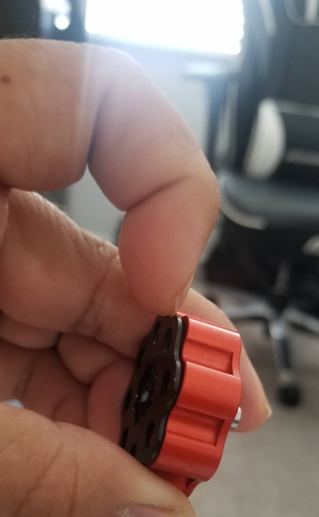

- List of Pellets that fall through the magazine (mostly anything with smaller diameter like JSB Hades 15 grn)
Etc.
Interesting, I haven't had any problems with the JSB .22 Hades falling through.
Here's a list of pellets in .22 I've tried that haven't slid through for me:
  • Falcon 13.43
  • JSB 14.3, 15.9, 18.1, 25.39
  • JSB Hades 15.9
  • H&N Sniper Magnum
  • H&N Barracuda Match 21gr

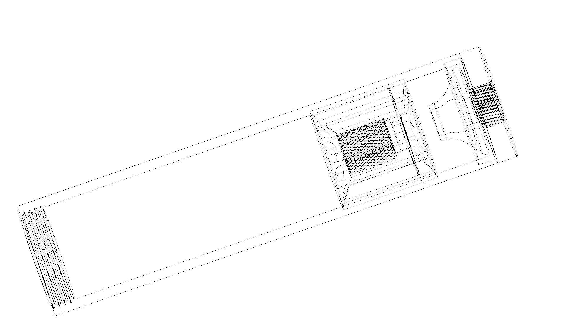

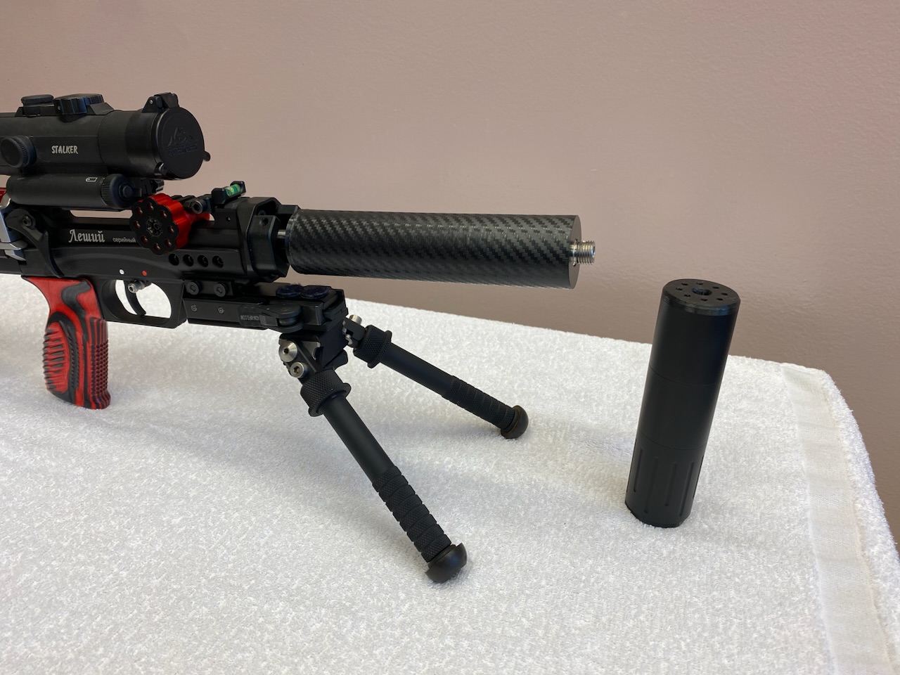

I’ve updated design of the blowback shroud. It is much more efficient and now supports a standard 1/2 unf threaded moderator.
This video was made by one of AGN member here demonstrating the sound comparison between the Leshiy 2 vs the pellet impact sound at the target.
This is really similar to the Behemoth design, with the reflex shroud. Looks great.
Are you selling these updated versions?
@Jack.K Do you have any of these shrouds for sale I am very interested in one for my 350mm .22 barrel
