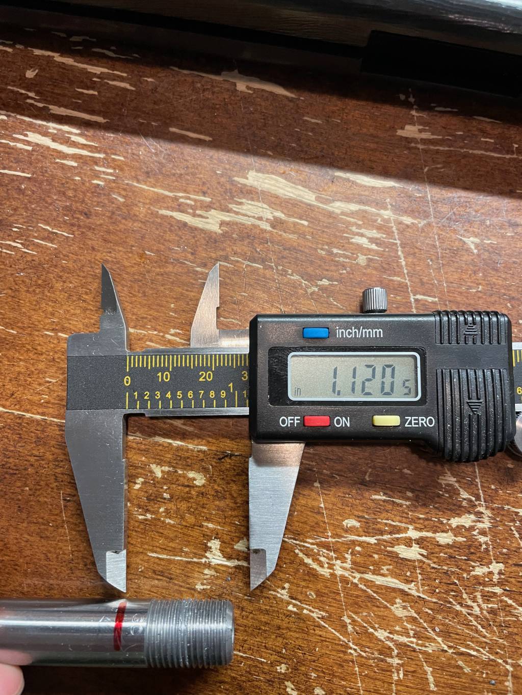

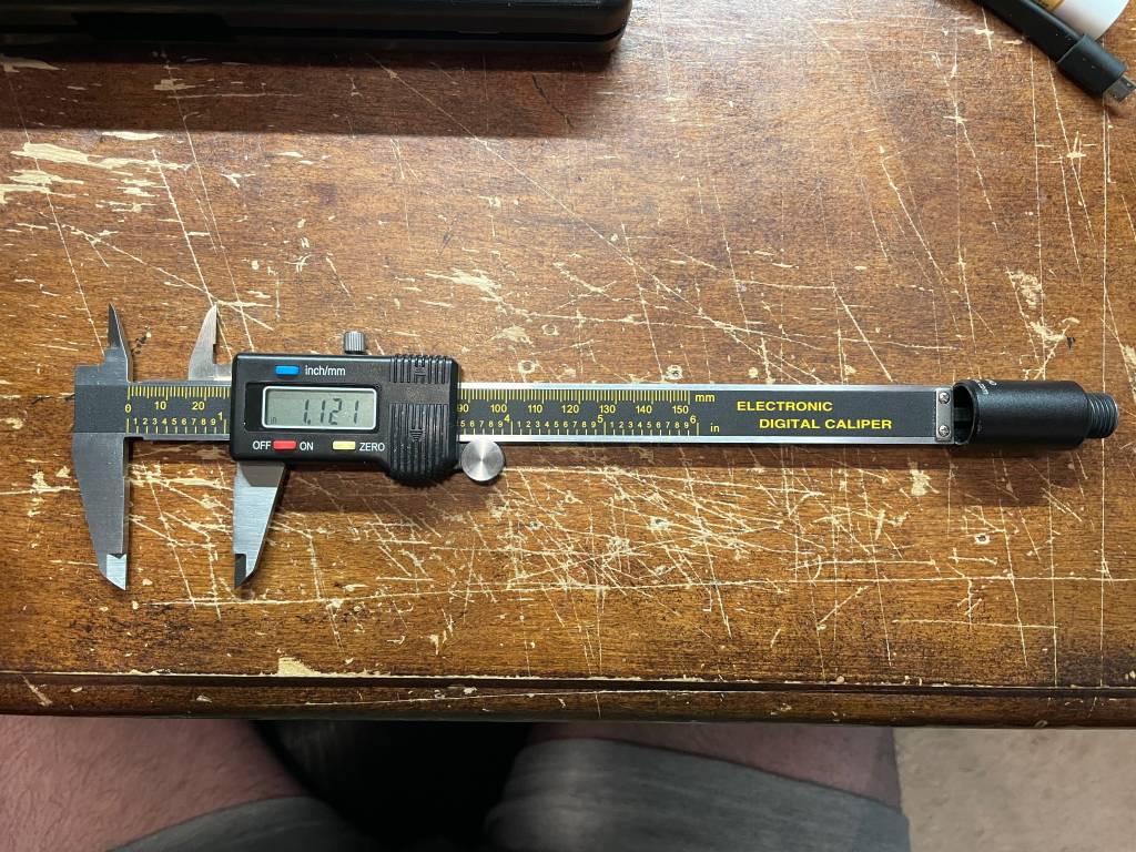

Caliper time:
Internal depth of the VCB-2 = 1.12"

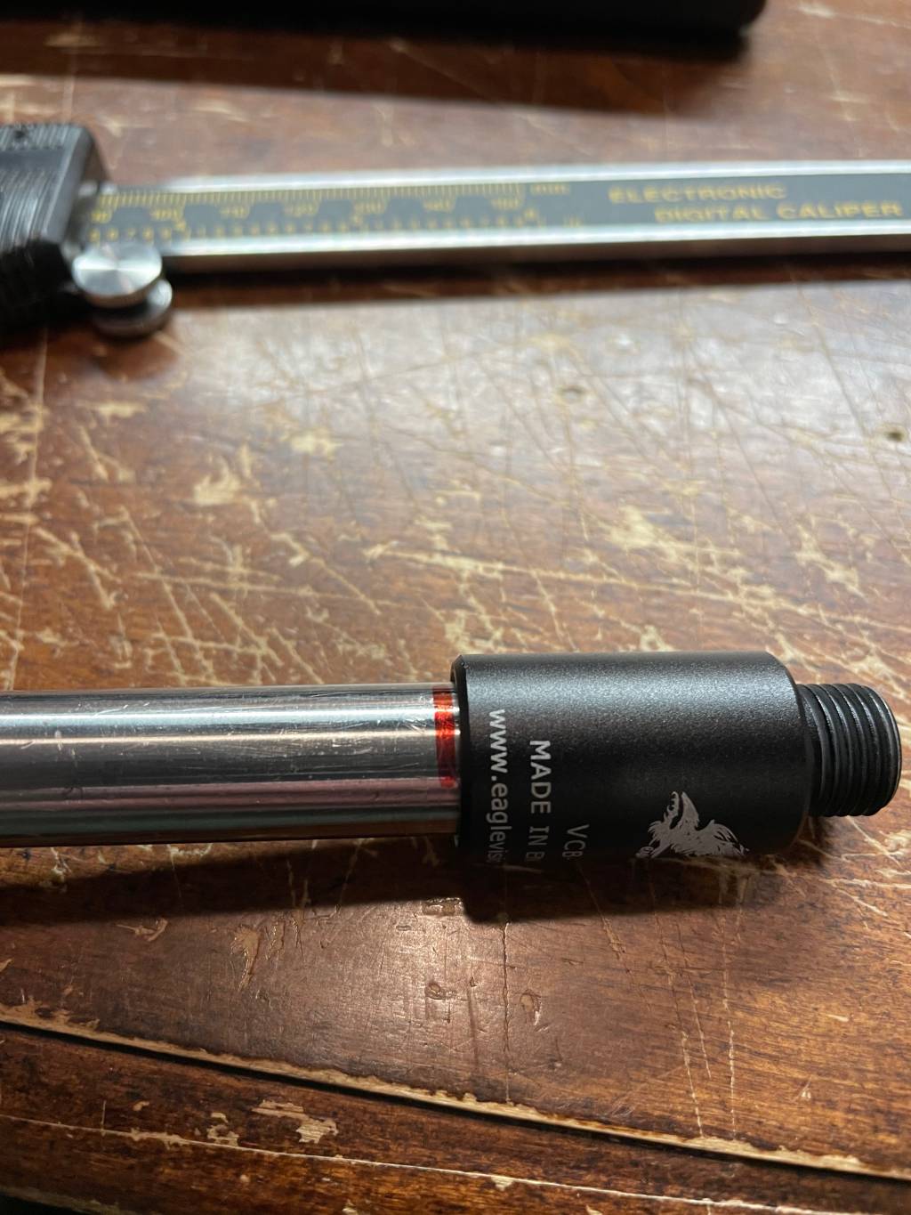

Installed the adapter tightly on a barrel and put a Sharpie mark.
Compare the two measurements and there's definitely ~1/4" of space between the barrel end and the adapter end.
I removed the VCB-2 and replaced it with the VCK-2 and back to single hole 8-shot mags.

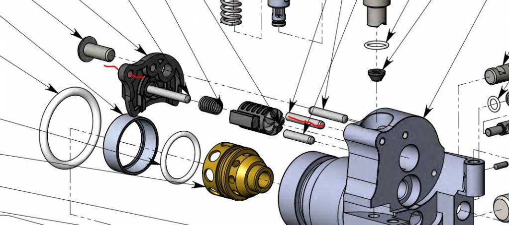

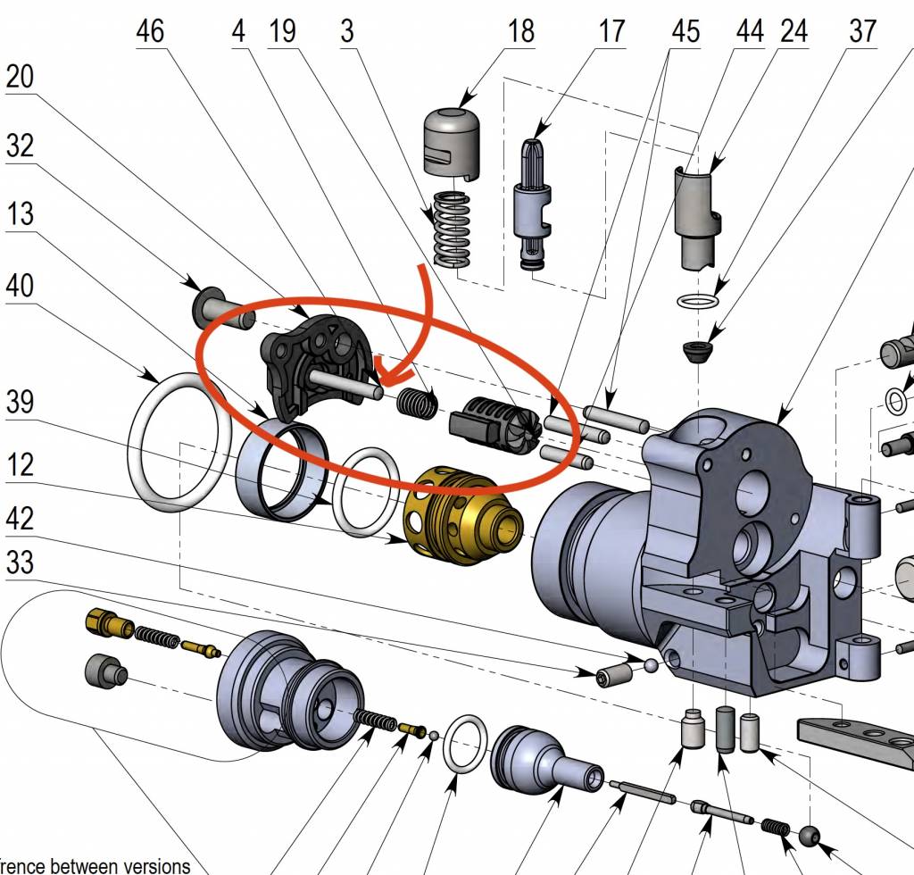

I experienced a mishap of the semi-auto function today. My mags were not rotating on all of the shots and it was very firm to rotate the mag by hand. Spent a few hours trying out different things, cleaning everything, adjusting the top screw to the hole the mag goes in. Nothing seemed to make a difference until I started inspecting the the notched piece on the valve part that rotates the magazine and noticed the pin protruding what seemed like a bit too far out. Knocked it back in so the pin was flush with the back and everything seems good again. What I can assume is that is the pin had pushed out far enough that it was pressing against the hex screw in the middle of the magazine causing binding.
Just a heads-up of something else to check for those with semi function issues. I'd say about 5-6,000 rounds in before this happened to me.
Part 46 below:

I wonder how that pin is held in the part 20? Pressed or perhaps loctite? Thanks for the heads up. It got up to 57 degrees today so I took the Leshiy for a walk around my property. Shot a couple sparrows in the low undergrowth switching from scope to my Hallosun red dot. The 30 really pops those sparrows. I had 2 shots that sounded a little strange, underpowered. And I didn’t hear the pellet hit any background brush as I should have. I opened the action and there was a pellet inline with the barrel and a couple of empty chambers from previous shots. I rotated the magazine 360 degrees and fired it and it shot fine so I don’t know if I was just hearing the muzzle blast without the pellet hitting anything solid, there is still snow on the ground. It is really interesting how much noise the pellet hitting something solid adds to the overall sound of the shot. Especially the 30 caliber JSB’s going over 900 FPS.

... Knocked it back in so the pin was flush with the back and everything seems good again. What I can assume is that is the pin had pushed out far enough that it was pressing against the hex screw in the middle of the magazine causing binding...
Part 46
Thanks, I also find this pin to move back over time but do not interfere with function in any way

So if the pin moves forward, part 19 can not retract far enough to disengage from the magazine right. If this is the case seems we can inspect by pressing 19 back to ensure it retracts beyond the face correct? The hole in the index mechanism allows access to reseat the pin without disassembly as well right?
I just don’t want anyone disassembling unnecessarily. Mainly me🤪

Not exactly. Part 19 was still moving back and forth fine. It was just the silver pin in the middle was pushing into the middle of the magazine causing too much friction for the mechanism to spin the mag.
Definitely nothing to take apart here, just tapping a pin back into place.
