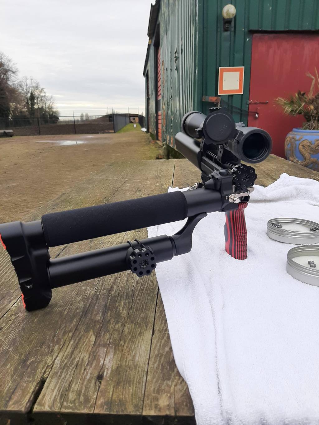

EDgun Edgun Leshiy 2

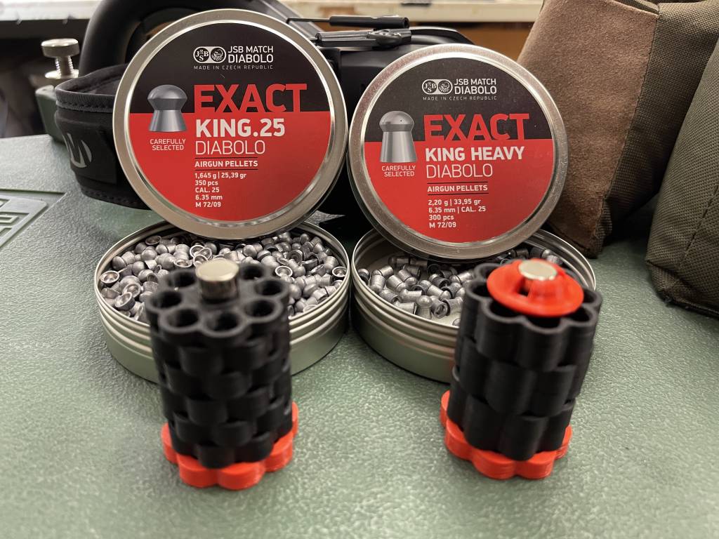

The 3d printedvversion i have works flowless .
It is competable with ,22 heavy's upto 25 kings because off the length restriction of this particulair version it does not take longer pellets as standard but a small top cover does make it competable
Only taking 24 pellets with this mod in stead of the 40 pellets standard.
But there will be new versions created for sure.

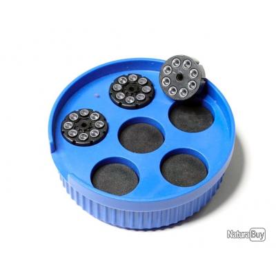

I read on one of these forums about speed loading the mags by simply laying the mag on a towel, or in the pellet tin, and sprinkle the pellets on top and most of them fall right in the holes proper nose down.
Same principle but here a fancy hardware one I use for a Röhm Twinmaster, pushing the bottom part raise the mags over the surface

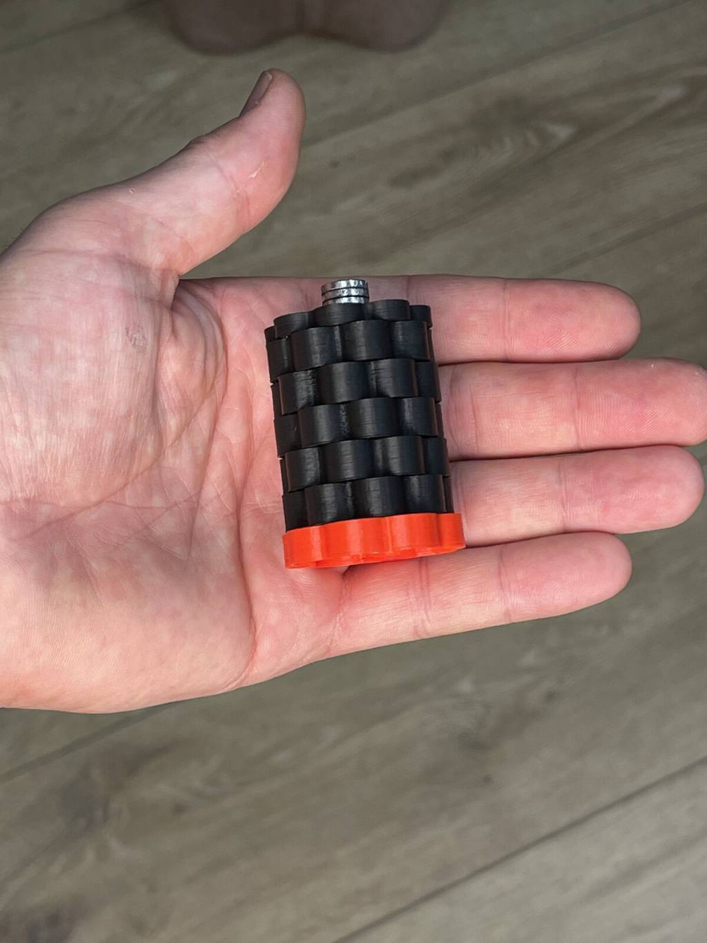

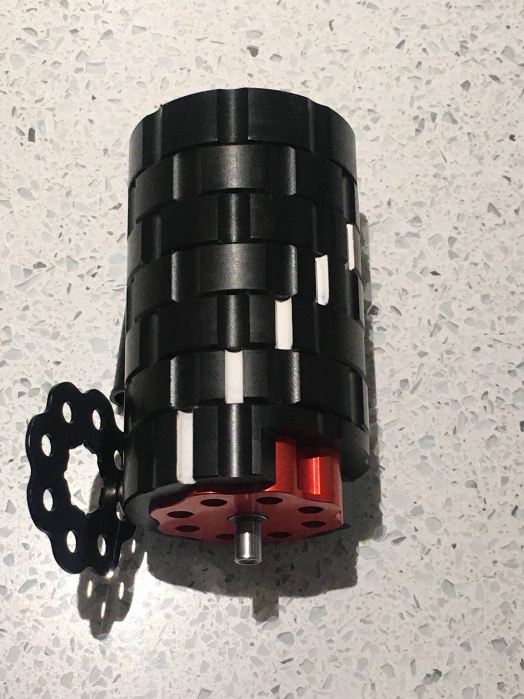

This will work with the speedloaders I produce too! (pictures a little higher up above this post) With the speed loader block the red bottom part and almost the top level, so the pellets can only fall into the highest container level (the #5 storage level) , grab that top level in a pinch between your thumb abd index finger, sprinkle some pellets into the cup you made and most pellets will fall heads down. Some will double up, stacked on top of each other. Take out the ones sticking out, and then there are maybe some that are tails down and heads up. Simply put your fingers over the correct ones, leaving the heads up one(s) exposed. Now turn over the speedloader and the wrong one(s) will fall out. Fill the now emty hole(s) and rotate the top level so the pelets will fall into the bottom level. (container level #1) Lock the bottom level and the top level and repeat till all levels are filled. (which takes lees time than to write and read it here). If this sounds too complicated you can also load the speedloader one by one, and when a whole level is filled, lock it and fiil the next level up one by one.
These speed loaders work perfect and cost half the price of a mag.
you don’t have to take out the mag. every time, just place it above rotate and put backplate on the mag.
one hand holding the leshiy and the other on the speedloader quick and easy.
you can place it in your pocket and have 40 shots worth of refill , on top of your 2 mags.

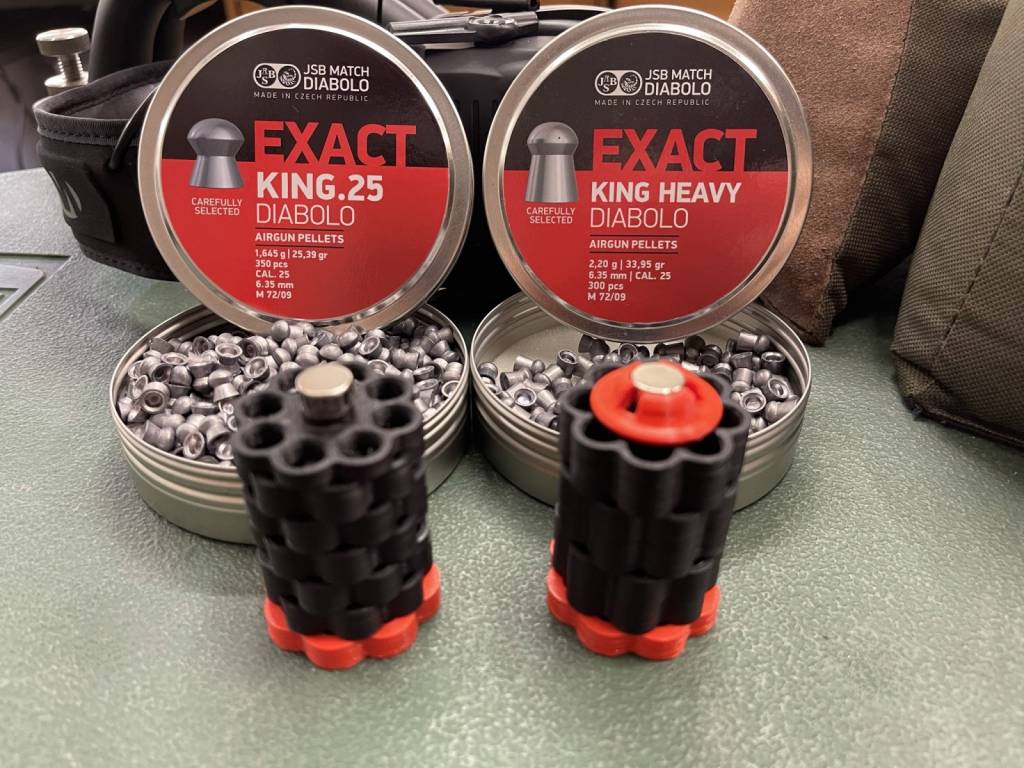

BTW I make and sell these (as pictured below) and have only 3 left of the current batch... They load 40 regular pellets (as seen on the left in the pic (red top hat not required), and 24 very long or extreme heavy pellets/slugs as seen on the right with the red top hat)

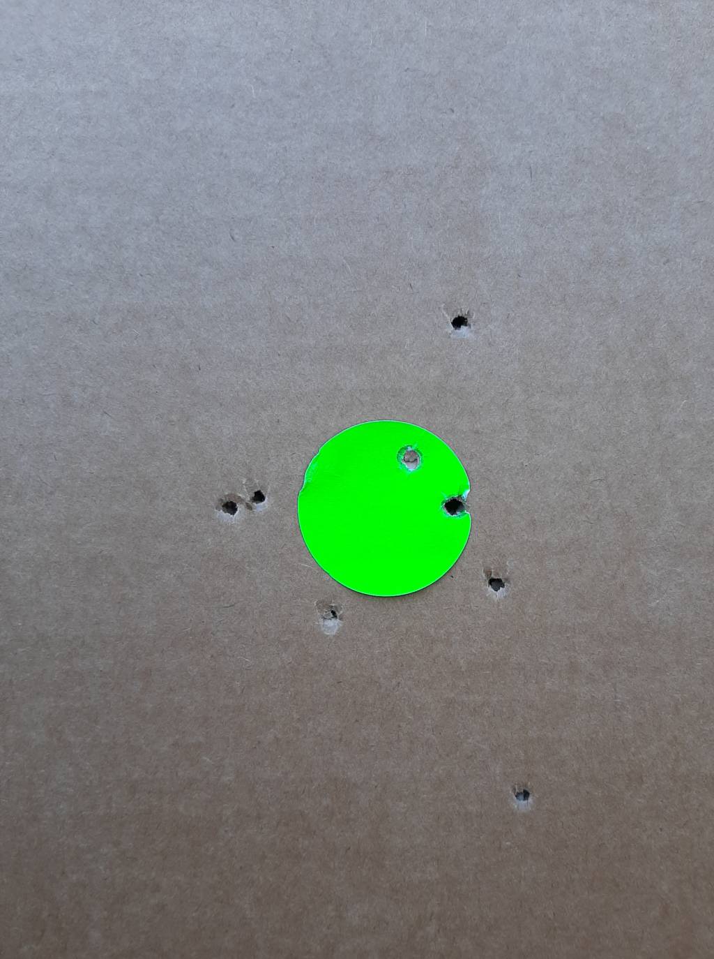

My Walther barrel on the L2 get dirty real quick (black grease from pellets only, no lead flakes) so I usually run 4-5 patches trough it after 10 mags or so, comes out really dirty
Tried to spray the pellets with silicone oil, the idea was to shoot out the dirt and keep the barrel clean, did not work, instead it opened the group to about 4 moa
So started to de-grease the pellets with Heptane, something we have used in the shop for more than 40 years so I know this stuff is not specially dangerous to work with - it's no biggie, just roll the pellets around in a container, then dry in oven a few minutes at 60 degrees C
This has kept my barrel clean for a long time and patches comes out nearly clean
2 mags at 35 yard, 247 m.sec/ 810 fps

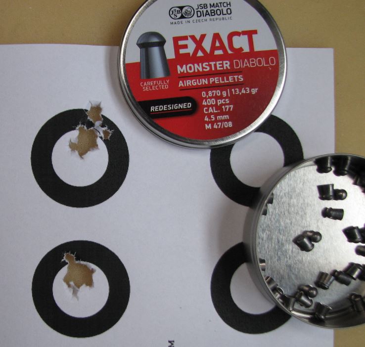

This begs the question, what pellets are you shooting? I have the .22 350mm shooting JSB 13.4gr @850fps. Just pulled my first patch through since my initial cleaning. After around 1100 shots, my barrel was very clean. I'm not really surprised though, because I practically NEVER clean my AG barrels, and I've owned over a 100 AG's of all types over the past 38 years. Many have the LW or CZ barrels, However, I always use high quality (more expensive) pellets.
So, I guess I'm wondering if the pellets lead formular has a lot to do with it? idk

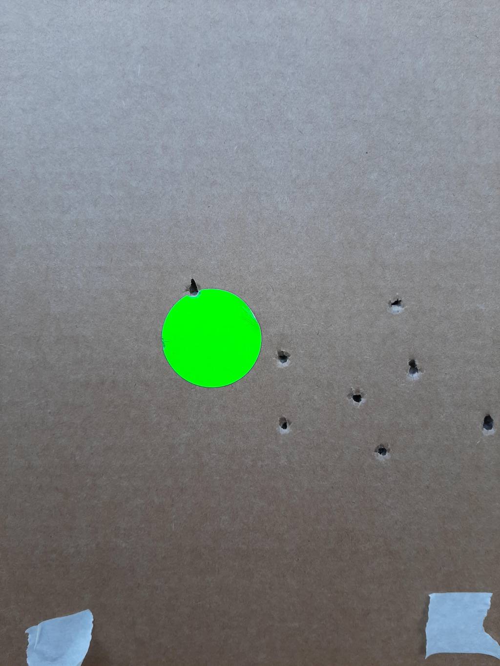

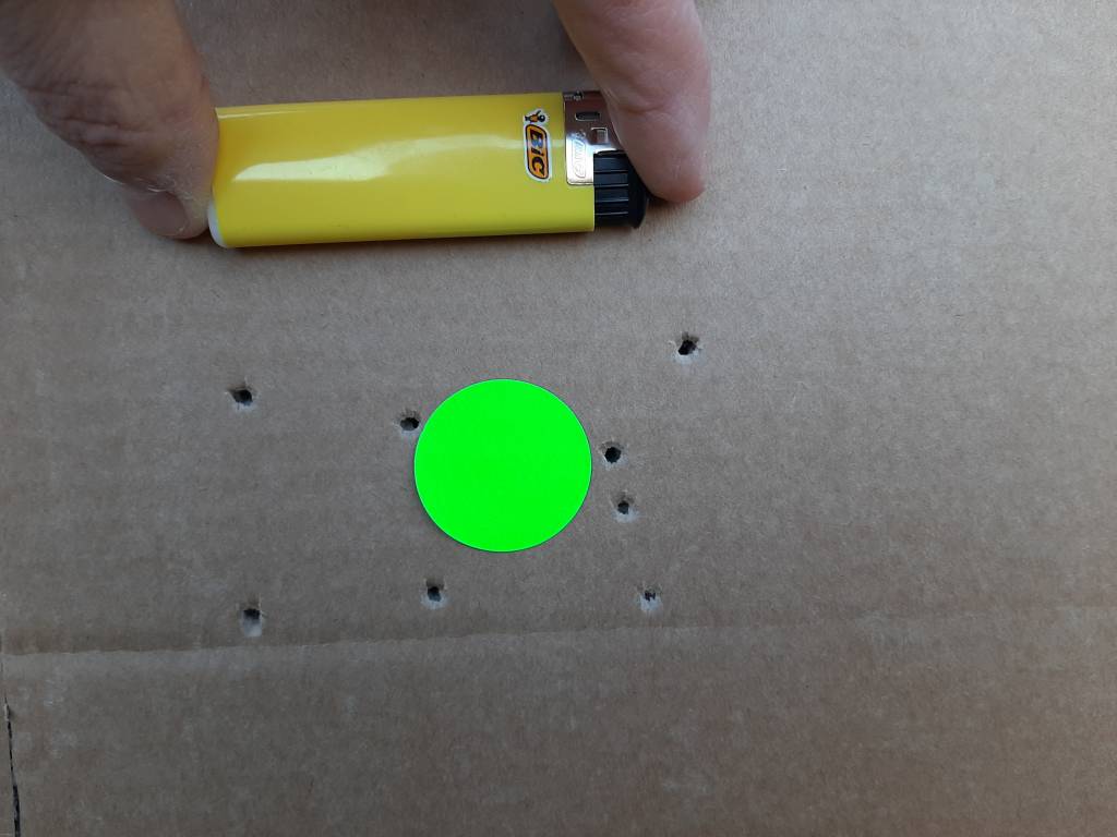

These where shot with 16grain .22 jsb same setting 271ms
To beat the wind i shot most of the groups in rapid pace Max 15 seconds 8 shots wich resulted in the smallest groups. Here and there a flyer but that was mainly me pulling the trigger😉
The Potentional is defenetly there for smaller groups on my 100m indoor range .
looks like my indoor shooting range will open again somewhere end of march if the covid thing stays stable over here.
