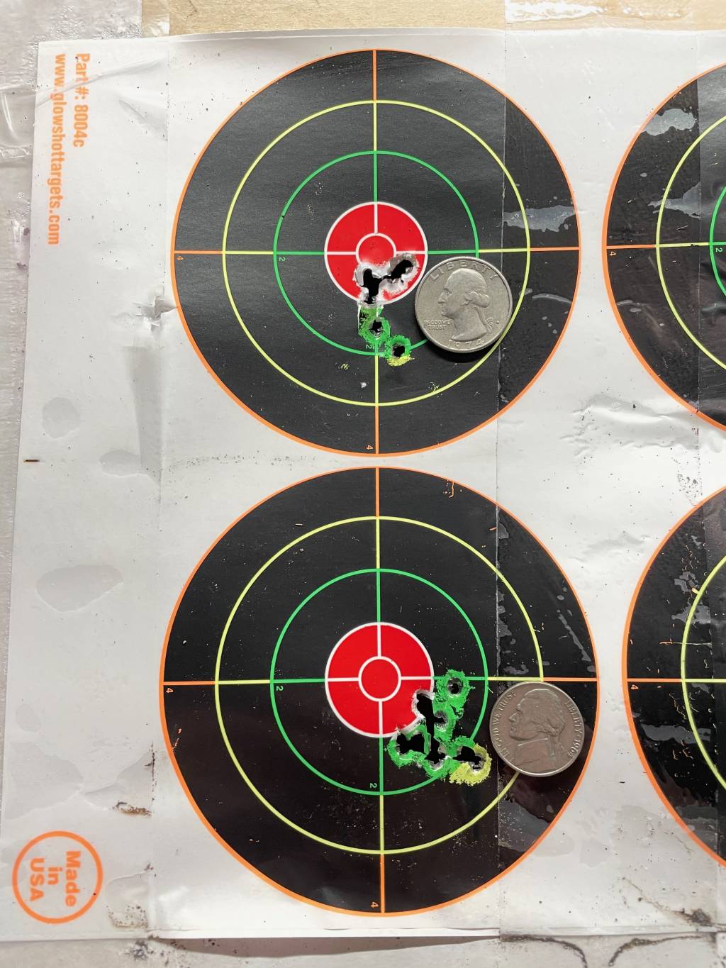

I got a chance to shoot two quick mags outdoors this weekend when the weather settled for a bit.
I've been shooting mostly indoors so I had it tuned shooting the AVS .2513 30gr flat base right at 800fps. I normally shoot them tuned to 950 fps when at the range; however, they were stacking at 800 fps indoors so I figured I freeze for a few minutes and shoot a few groups at 46 yards.
Nothing cherry picked here as I only shot two mags, so this is pretty standard accuracy using the 450mm .25 Alfa barrel and a LVPO 1-8x scope. First group was the bottom one - all 8 shots fit under a nickel. Top group a little bigger and one called flyer just off the left side of the target.
I previously haven't had much luck with slugs in the .22/350mm barrel. I tried out some NSA 17.5gr .2165 that I've had for a bit. They weren't so great the first time I tried them, but I had the Leshiy 2 set a little lower in power and was sending these at 850fps. They are showing promise at shorter distances so I plan to stretch them out a bit and see how they perform.
