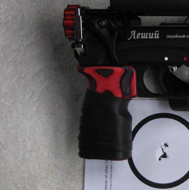

My preorder number is 1165. The grip I mentioned is the redesigned one Ed did a video on a few weeks back.
Now I see what you mean. Darn I really like the original grip, I wonder if Brian will give us the option of being able to choose, not really feeling the updated version
I also like the original vertical grip. I wish there was an option for one like the Ergo Suregrip in rubber overmold. It sure helps with sweaty hands.

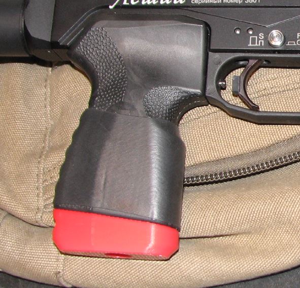

I'm referring to the exact same factory EDgun grip shape but in rubber overmold.
Roll your own, comes in all sizes, you will need a tube at least 2" wide, turn inside out, wash of the talcum

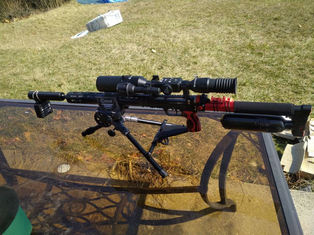

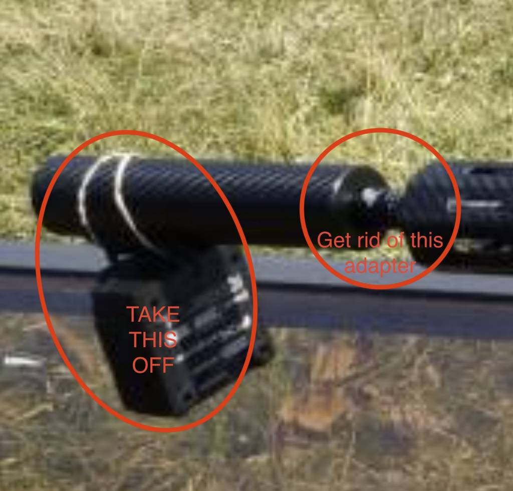

Some more data points. Did some 50 yard testing with 600mm .30 Barrell Turned to Max settings (160 Bar) and one 0.2 Valve.
I also have the bigger plenum on the gun. Results were disappointing. Intended on trying some at 75 yards but was too dissatisfied with the results to go beyond 50 yards. Here is a look at the setup. Should be minimal human induced error and the groupings were far worse than what I typically induce at this range with this setup. I have maybe 100ish shots on the 600mm barrell I go it last week.
In an effort to help you with your accuracy issues I will point out two glaring issues I see.
1 - You can't shoot for accuracy with the FX chrono attached to the gun.
2 - The EV adapter you are using leaves a gap between the barrel and the end of the adapter. Search back a few pages I measured and posted on this exact thing.
You need this adapter: https://www.airgunsofarizona.com/airgun-silencers/eagle-vision-vulcan-1/2-unf-muzzle-adaptor/
Thanks ordered adaptor and will try when it arrives, may just shoot in unsuppressed and see what happens. Neighbors arent super close but not that far either so will have to time it well! Also going to try to make an insert for the slim FX Barrell to try to the lothar walter barrel outer width of 0.55" . Am curious how they will perform on this platform

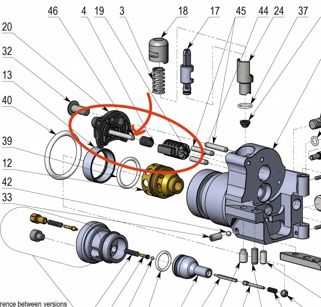

I had a similar lock up/no mag rotation. It happened after changing valve jets. I ordered a whole set to experiment with and found problems with it cycling on most new combinations but not on the original factory set jets. On closer inspection I noticed on a lot of the shots it sounded like the valves or the odd valve would not shut properly or struggle to close. Inspecting the rim of the jets where the spring closes them they looked to be slightly dinged. The new jets seem to have a slight lip on them where the factory set ones did not. Anyway, I have since replaced one of the jet holes with a screw and opted for just the one jet at 1.3 (the largest one in the set) as I wanted to reduce dwell time. It seems more reliable with the one jet than the two, and have not had any mag cycling problems since.
I experienced a mishap of the semi-auto function today. My mags were not rotating on all of the shots and it was very firm to rotate the mag by hand. Spent a few hours trying out different things, cleaning everything, adjusting the top screw to the hole the mag goes in. Nothing seemed to make a difference until I started inspecting the the notched piece on the valve part that rotates the magazine and noticed the pin protruding what seemed like a bit too far out. Knocked it back in so the pin was flush with the back and everything seems good again. What I can assume is that is the pin had pushed out far enough that it was pressing against the hex screw in the middle of the magazine causing binding.
Just a heads-up of something else to check for those with semi function issues. I'd say about 5-6,000 rounds in before this happened to me.
@888 - that's very odd behavior. What barrel combo and reg pressure are you using?
The .25 and .30 get less back pressure because of the bigger holes in the backplate. I found with .25 that going under ~70ish bar on the reg and it start to not rotate so well.
With .22 I've brought the reg down to 50 bar and the L2 still operated with no issues.
