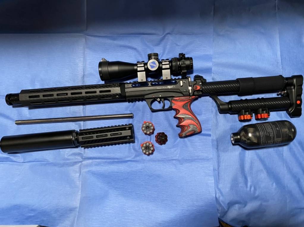

I just converted mine over from .22 to .30 Tuesday. Same exact as your setup except different scope. Its much easier to change the longer latching pin when the "Forward Plug" assembly is off the plenum or "Spacer" in the drawings. You can use the back side of a thin drill bit to drive it out from the Magazine side.
Thats awesome that the caliber can be switched out. Was it easy to do, if so how long did it take you? I hope EDgun West covers it in a YT video one day. Would love to go from a .22 to a .25, maybe even .30.
It takes about 5 minutes, quicker depending on your moderator set up.

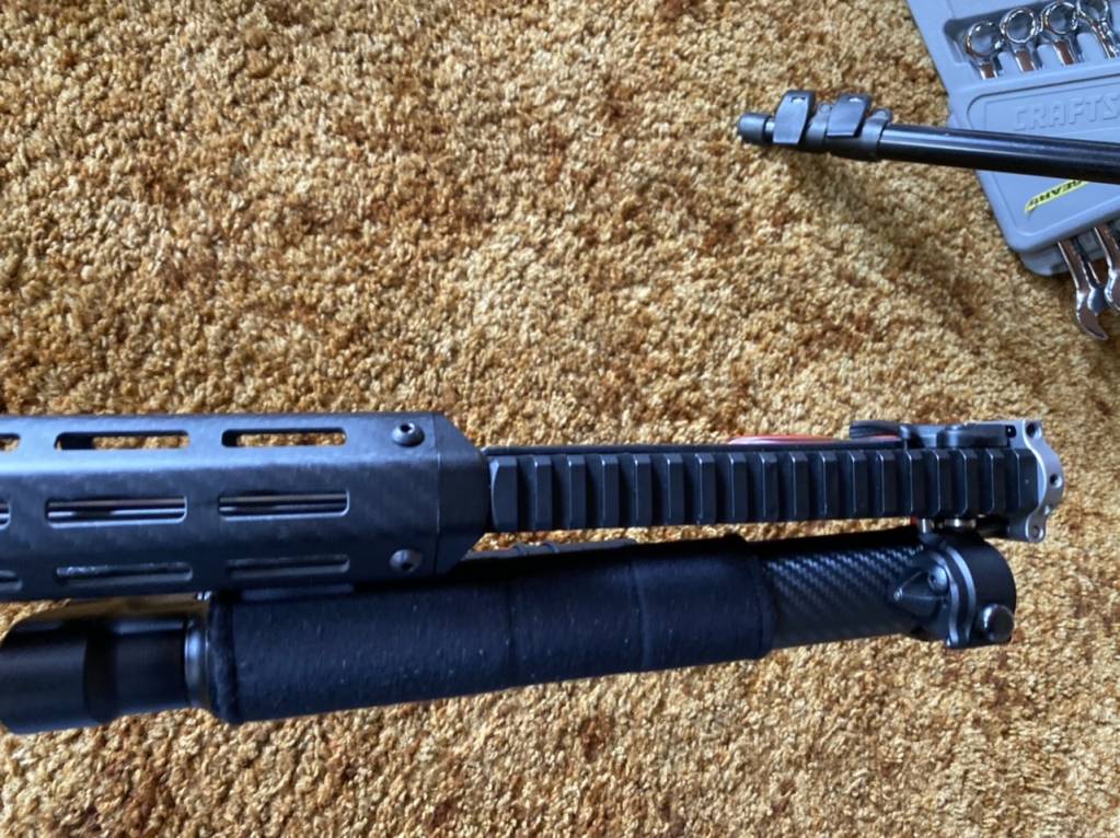

That's weird, I changed mine out, and it is still not able to lock. Same setup, 300cc bottle and carbon handguard.
The pin comes in two different lengths. One is for the aluminum forearms and another longer one for the CF forearm. What is hitting when you fold the gun all the way? If the bottle is hitting then you have to degas and rotate the butt so the bottles clears, then regas. If the top tube is hitting your forearm and it doesn’t lock then I’d give Brian a call for a longer pin.

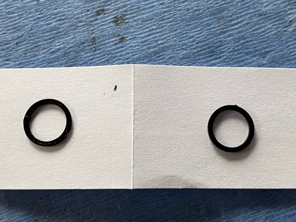

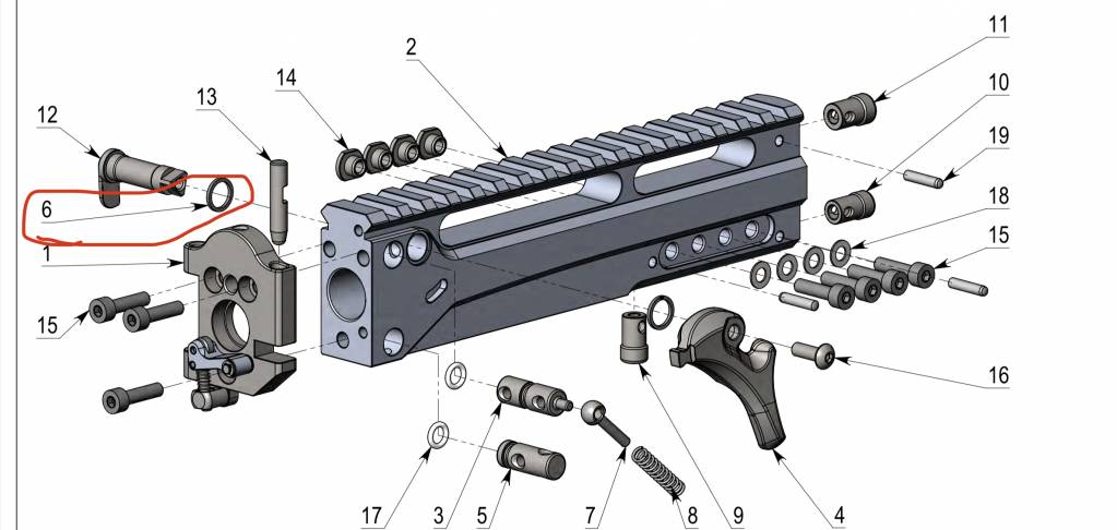

I didn’t need to change out the pin for my Leshiy 2. I went with a much easier approach. There are 2 8x10x1mm washer (#6) on both side of the latch already so I added another washer next to #6 as shown to give another .25mm or 1mm depending on which handguard I will be using. Simple fix. I 3D printed the extra washer.
Steps are as follows;
1) unscrew #16 but DON’T remove the screw
2) pull out #12
3) add extra washer next to #6 circled in red
4) reassemble #12 and screw back #16 together
done
edited with step by step instructions

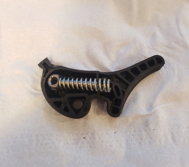

Decided to try my hand in taking the latch apart and now don't have a clue on how to put the pin and spring inside of the housing. Spent the last two hours cramming it in there and no bueno when i try to attach the assembly to the gun.
Yes putting it back is pain but there must be a trick to it as I remember Ed doing it whilst talking to the camera, hope he or Brian will share how its done the easy way

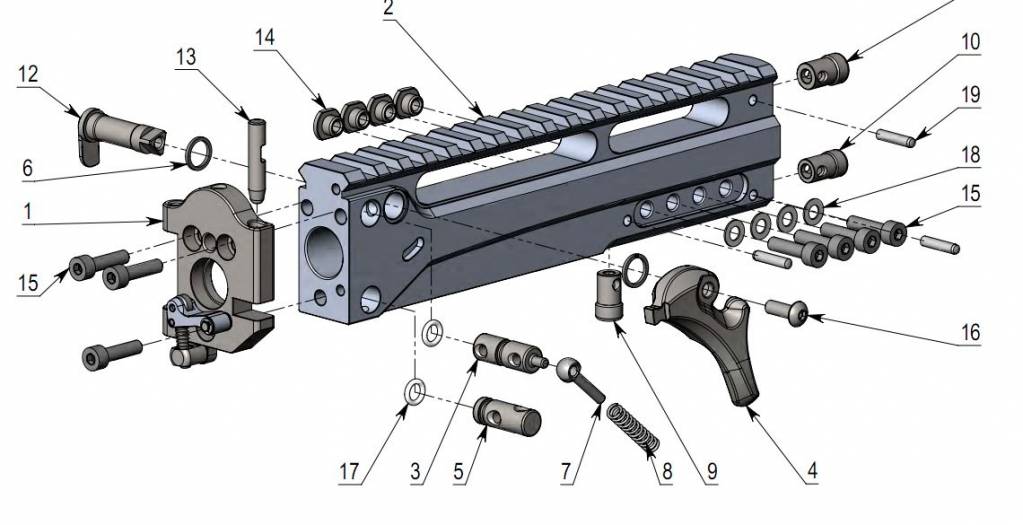

I wanted to change the latch (part 13) and took of the lever (part 4)
This is not needed, just remove the barrel, the 3 screws (part 15) and the one under those and gently remove the hinge (part 1), is fixed in place by two pins on the right side of the hinge so gently push the place of the frame, very important to be careful with the pins and pinholes, this is important for indexing the flow of pellet from mag to barrel
Mounting the lever (part 4) back, I started by mounting the rod (part 7) on the spring (part 8) in the lever (part 4), this is a strong spring so no easy to do, slipped the assembly on the tip of the insert (part 3) and pushed it up to reach and slip on the axis (part 12) while holding the frame with my third hand
Then the easy part, mount latch (part 13) in frame, hold down lever (part 4) to index with the latch while gently sliding the hinge (part 1) back on the frame
The bottom line - I don't think it can be done properly without taking of the hinge plate (part 1) first
2) pull out #12
done
2) pull out #12
done
Guys... do not do this. Just put the pin in. While the washer idea will work, putting the latch pin back together is not a fun day.... as seen above.

Curiosity got the best of me, the pin did come out first but I decided to see what was making it stuck and it was the spring and pin holding everything down.
After several more attempts I actually got the housing IN and functioning as it should, now to get the pin in... thats where I spent a solid 30 mins pushing and prodding the pin to go all the way in. If you notice the pin and housing have a triangular shape so it must in that direction. Several more times of trying the housing eventually came off and back to where I started.
Learn from me fellas, do not remove the latch housing, its not a PITA to put back on.
The top tube is hitting, I checked the pins last night, and it looks like they are the same length.
Will have to shoot Brian an email(and order some more stuff haha)
After getting instructions from Brian, I was able to put it back together, key points were to take your time, notice how the housing sits when looking at pictures of the L2, the triangulated pin and housing is canted a bit and will need to be at a certain angle, along with the triangle being lined up with the hole for the locking pin to slide in.
It took me several more tries but I got it to work in about 20 mins after calling Brian. Major key point for me was taking time and noticing how the lever sits at the normal position, that and how the the plastic assembly housing just snaps into place when its everything is seated correctly. I'm never taking that thing apart! LOL 💀
The biggest reason I went with the shim washer mod and not using the longer pin is that I have both carbon fiber handguard and the aluminum handguard and it requires different length locking pin 15.25mm/16mm. Using the longer pin (16mm)on the aluminum handguard can actually scratch the Leshiy main body (#2 on the diagram) when the Leshiy is folded. Because the longer pin is pushing on the body #2 when folded. With the extra shim washer option I can add the shim washer in 2 minutes without needing to degas the air tube. DON’T NEED TO TAKE APART THE LEVER (#4) TO DO THIS MOD. Just unscrew (#16), push on the screw and #12 should slide out on the opposite side add the shim washer on top of the existing washer that is already on the folding catch (#12) and reassemble. I have done this many time cause I’m still trying to decide which handguard to use on my Leshiy 2.
