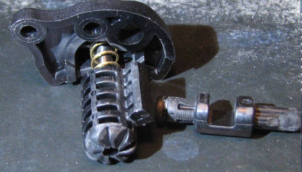

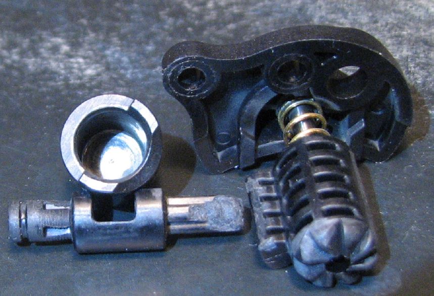

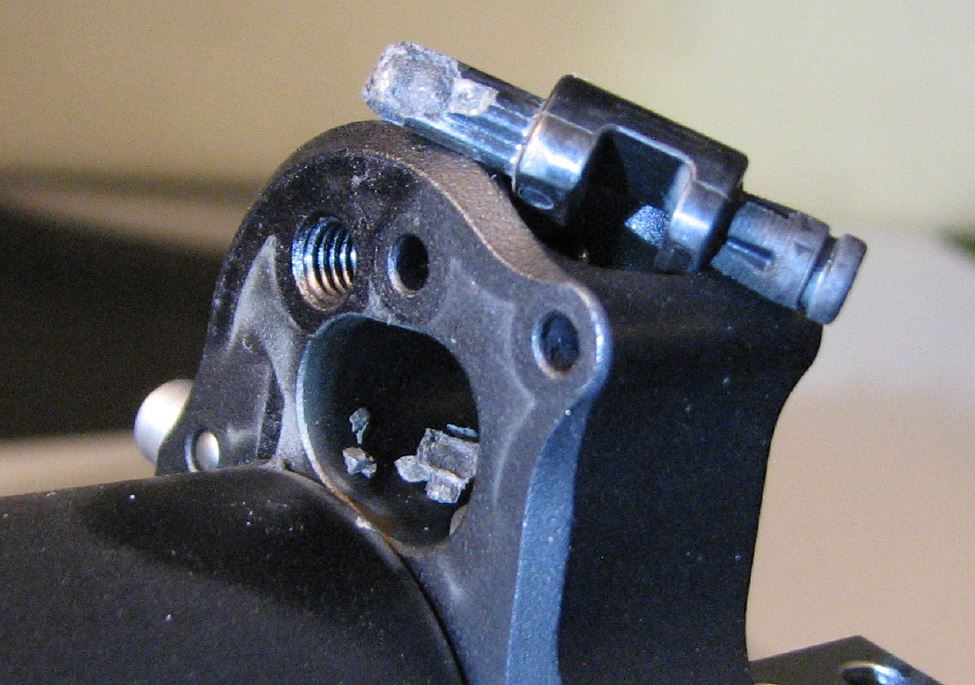

Today my L2's mag indexing mechanism stopped working, first failure to index ever after 9 tins op pellet aka 3600 shots, took the valve housing down after watching Brian's brilliant howto video, big thank you to Brian!
Found this inside, small parts from the plunger (part 17) that had disintegrated from banging against the top of the radio tower (part 18) and got stuck between the housing and the racket (part 19), stopping the racket to rotate and index the mag
Other wise the parts look OK, the plunger is now a bit shorter but I don't think it will make any difference if it bottoms out on the spring instead, I guess the bright spot inside the radio tower if from the plunger hammering the inside top
Anyway, cleaned parts, added a bit of silicone oil and put it al together again, its all so easy to work with
..will order a new plunger, but the indexing works perfect again
