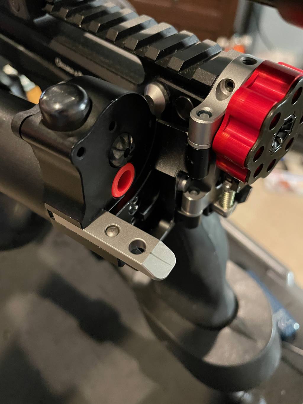

Here's my part after 10k+ rounds from a US round 1 Leshiy 2.
Ed - is this first run part just steel or does it have the nickel plating? Other than the mark the locking cone has made I've seen no other changes to its appearance.

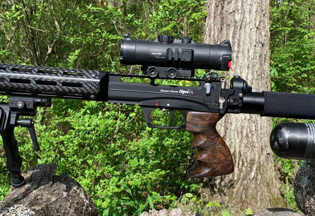

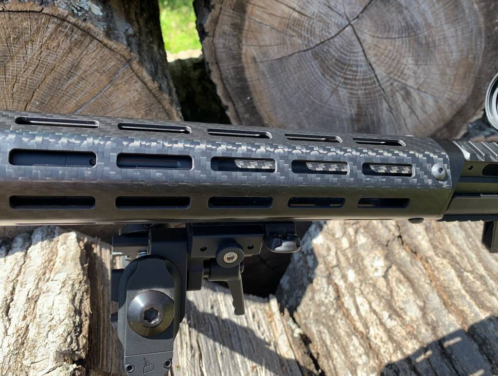

Here is my setup. The rings that I purchased for my US Optics scope didn't turn out to be completely red when anodized, so I'm going to try another pair. The carbon rail is unreal light and sends all the weight to the back. The MOD 40 silencer is also really nice. I took a middle section out and shortened the suppressor, and the sound dampening was still very effective.
