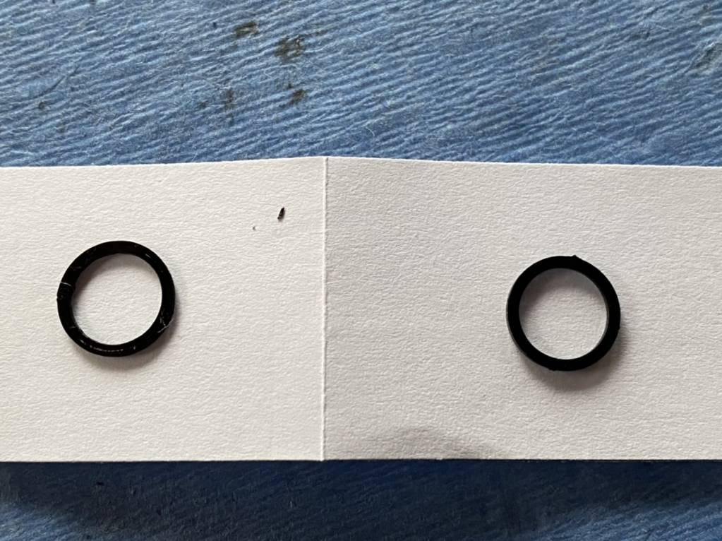

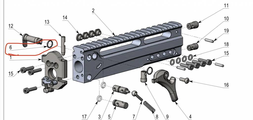

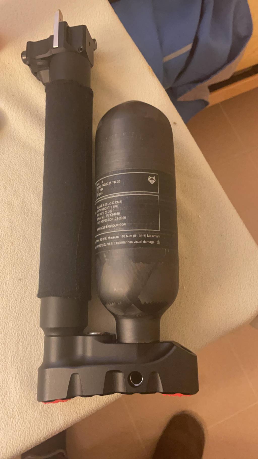

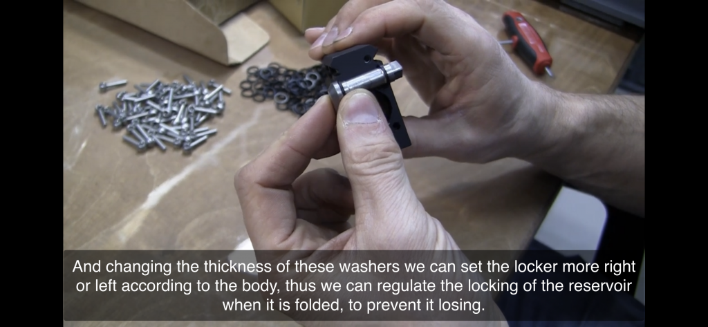

I didn’t need to change out the pin for my Leshiy 2. I went with a much easier approach. There are 2 8x10x1mm washer (#6) on both side of the latch already so I added another washer next to #6 as shown to give another .25mm or 1mm depending on which handguard I will be using. Simple fix. I 3D printed the extra washer.
Steps are as follows;
1) unscrew #16 but DON’T remove the screw
2) pull out #12
3) add extra washer next to #6 circled in red
4) reassemble #12 and screw back #16 together
done
edited with step by step instructions
Looks like Ed gave my locking mod a blessing . 😜
Reactions: Cattoo

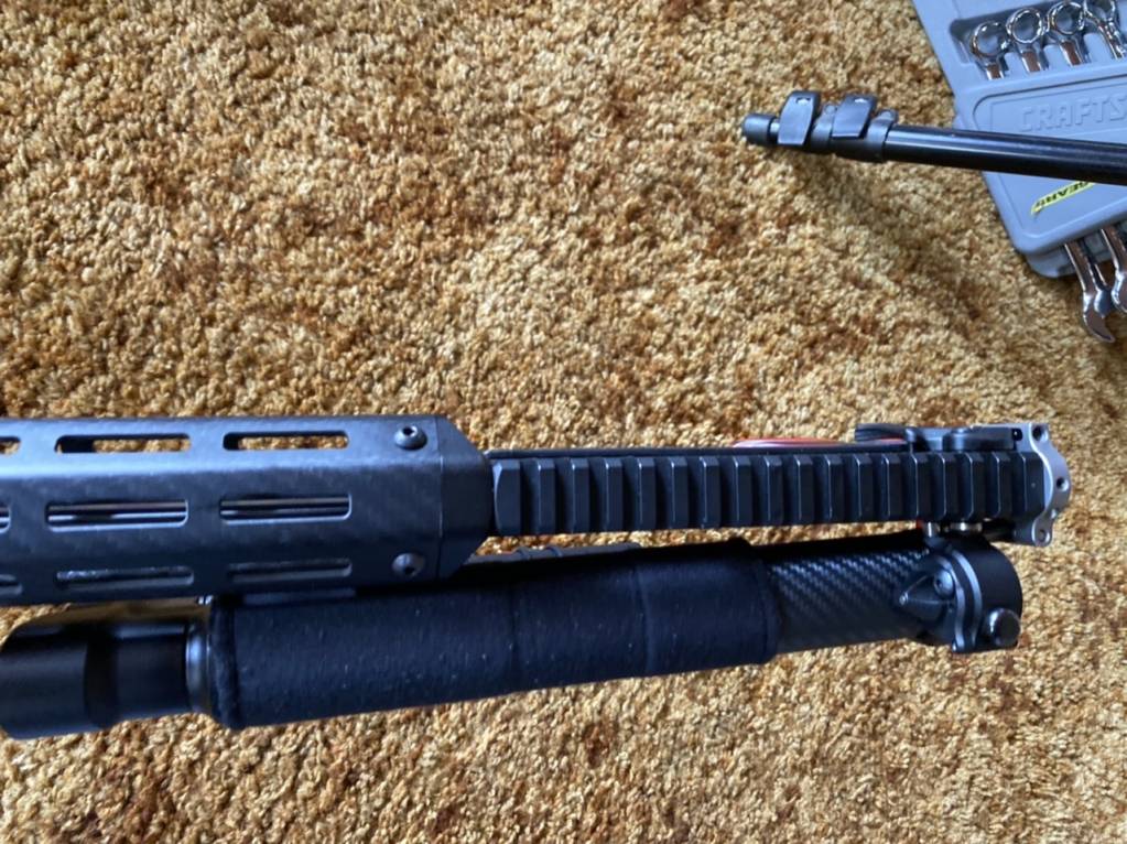

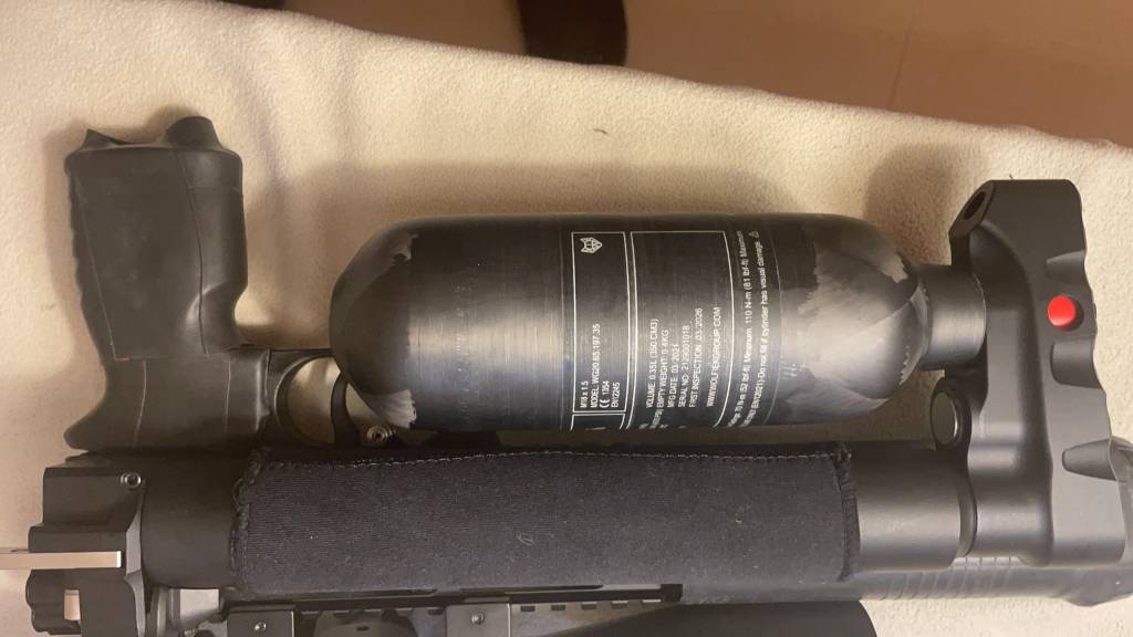

Dang, I need this for the 350cc bottle that I'm waiting on. I'm betting it didnt come with it tho :(
Also, DO NOT take the #4 housing out, getting 7 & 8 inside of it and put into 3 is a major f'n pain in the ass. If you somehow took it apart on accident, just take your time and pay attention to how it all works. That's how I finally got mine on.
hmm, im thinking the bottle is longer/narrower than the 300cc bottle people are having issues locking? Thanks for the input from those with the 350!!!!
Edit: I had to do some adjusting because the top cylinder was easily rotating. Removed the rubber grommet to tighten down the top, first adjusted so there is like 1mm of space between bottle and trigger guard.
