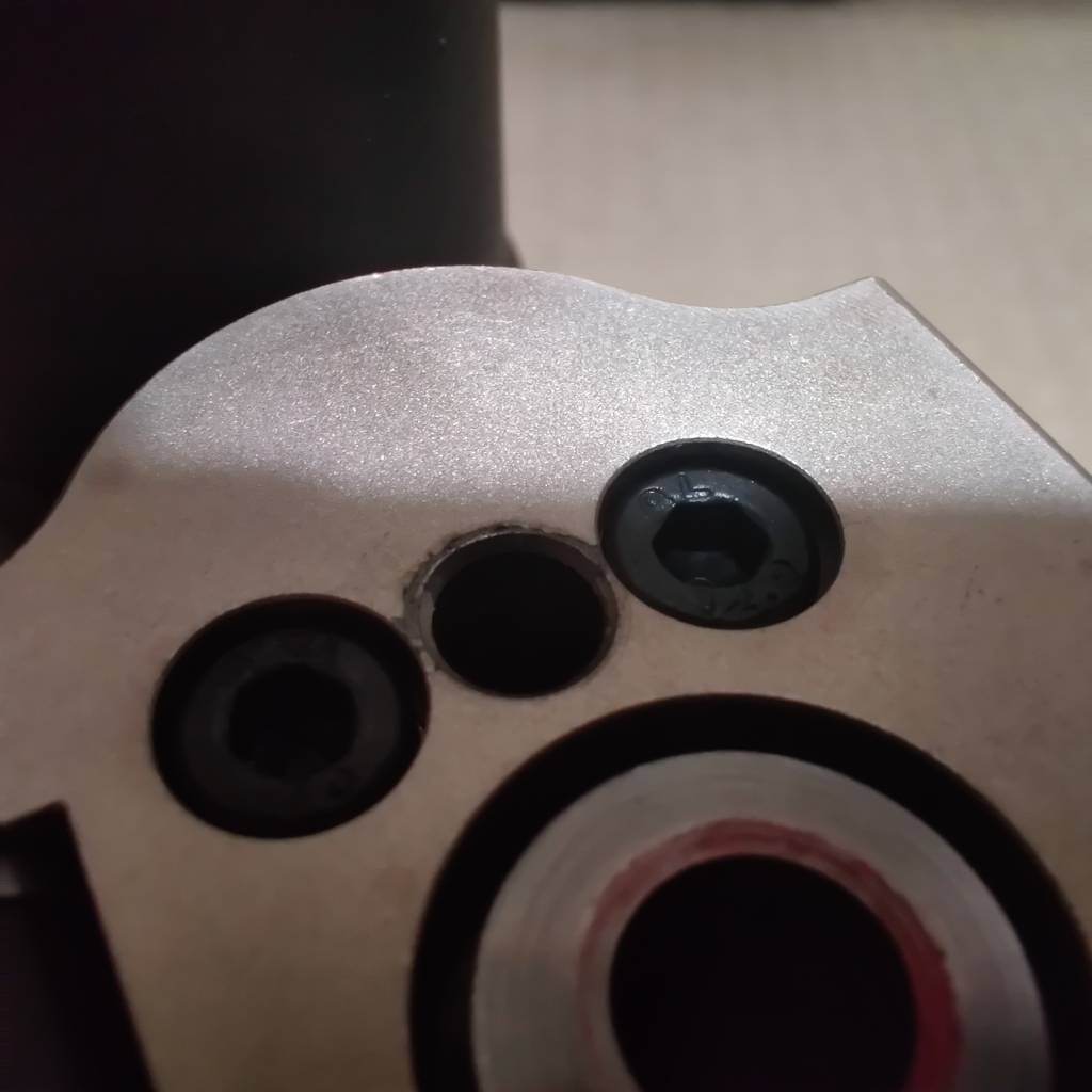

Such a good shooting gun just not built with correct materials!
Guess I will make one out of titanium unless edgun is sending out replacement parts.

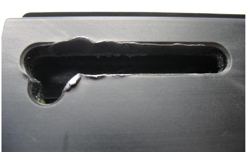

Nothing wrong with the materials, just the nickel finish on some of the first guns as Ed already explained to you at page 119 this tread
This is how not built with correct materials look like (Fx Monsoon, Fx Typhoon etc.)

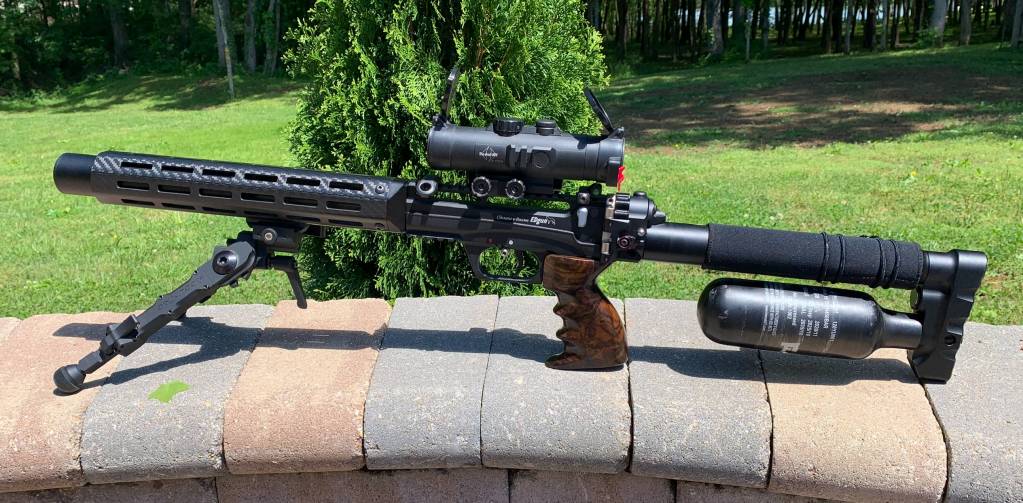

Okay, I thought I'd put up something a little different. This is my Leshiy 2. 250mm barrel .177 set up with a Deben whisper moderator that fits nicely in the handguard with a 1/2 UNF adaptor, in the UK 🇬🇧. We're limited to 12ft pounds here unless you have a firearms license so we look at air rifle capabilites a little different here. Accuracy and shot count are some of the things we look for! This is my attempt at a double regulator system. This is a 350cc bottle with a compact butt stock with a standard plenum and regulator, going down to a compact plenum and regulator. The first reg set at 130bar and the second set at 70bar. The bottle can take a 300bar fill so going straight down to 70bar reg is a lot of pressure and I imagine stress. I only usually fill to 200bar anyway and with this set up I got 20 mags worth and stopped shooting with the bottle fill down to 90bar. I must say I was very impressed with the results!

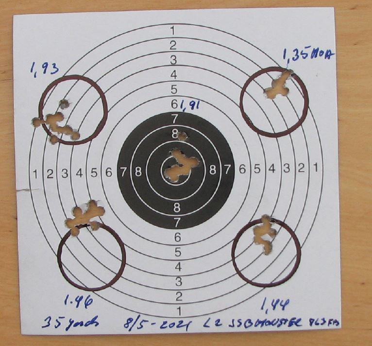

I do not know of any airgun besides the Edgun brand where you can take the gun apart, pull the barrel, mount it back and its only of by fractions, shot this 5 mag target half an hour ago, the two left groups was while readjusting the scope, this is the best I can do with this heavy trigger but I'm very happy with that
One day I will make a snell trigger mod to see what the L2 really can do
L2, .177 cal, 250mm barrel, Dedal Stalker scope, JSB Monster Redesigned at 863 fps, reg at 140, 35 yards
