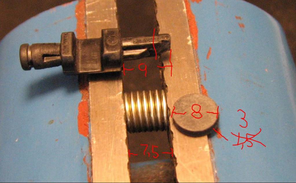

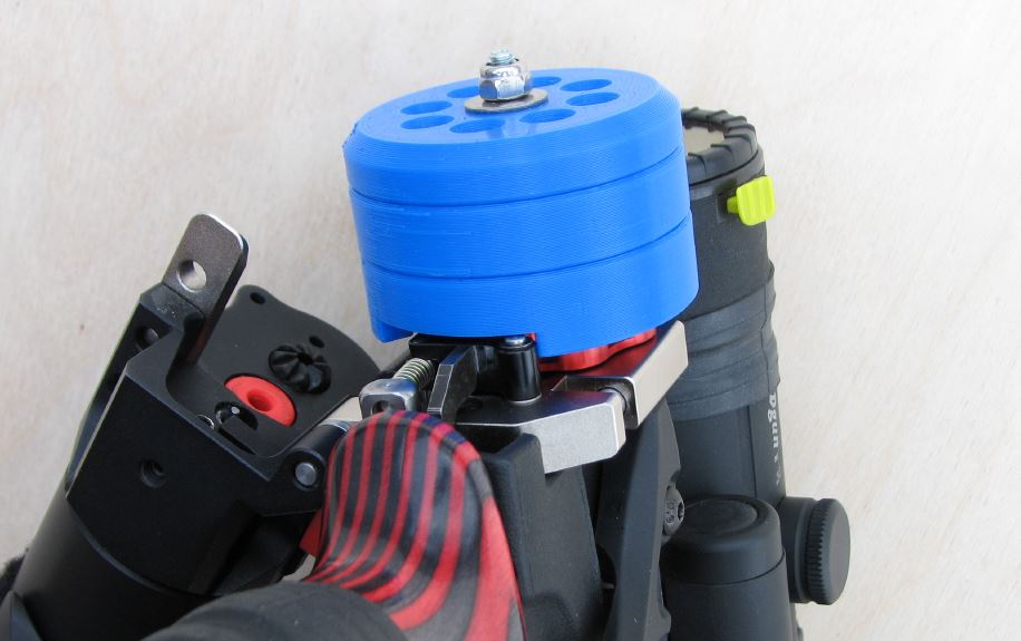

Mag started to over index a couple of pellet tin ago so change the rubber disc from 1.5mm to 3mm, been working perfect ever since
As you may remember the top of my plunger collapsed and I added a soft rubber disc to let the spring set the limit for stroke to 360/8 degrees instead of the plunger

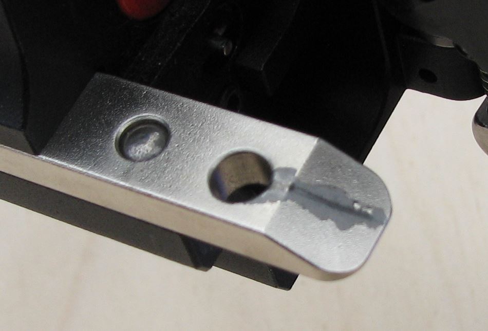

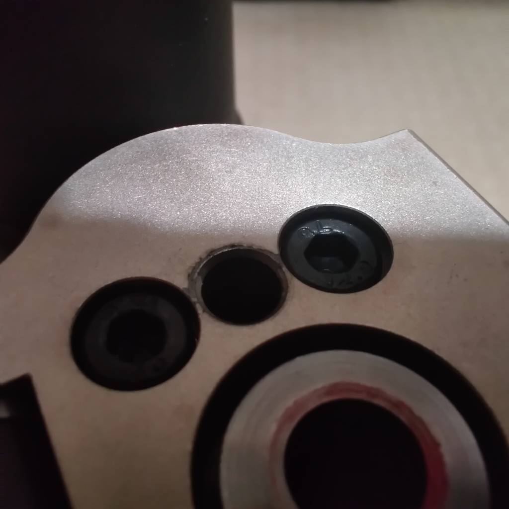

any of you guys know what kind of acid to use to remove the nickel finish without hurting steel ?

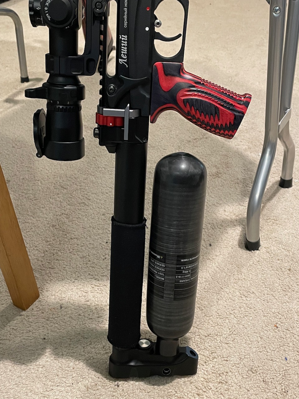

Had to get the extended butt stock and larger plenum to get the LOP so I could actually grip it. The larger plenum (+15cc) did give me a boost of about 20 fps on the upper end w/o changing anything else. And I guess I got an extra ~15cc of air storage from the longer butt stock.
That's interesting, I had thought about doing just that. How's the difference in length/weight vs the small bottle/shorter butt stock? And how's the feel?

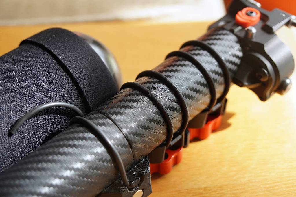

Well, I figured this would happen eventually but not so soon. One of my magazine holder o-rings/bands snapped overnight and another is about to break any minute. This doesn't seem like the optimal design for this and we'll be swapping them out all the time (reminds me of the EDMU). Has anyone found a better alternative to these big o-rings?
