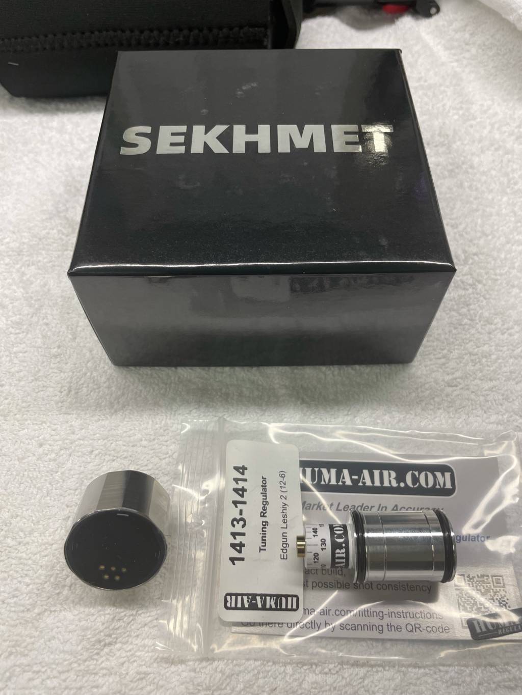

Swapped out my regulator and gauge today with a Huma regulator and a Sekhmet Digital gauge. Hopefully the Huma regulator will make my shots a little more consistent especially the first shot.
I have .30 350mm barrel. Reg. pressure set at 150bar. Factory #2 jet with a screw plugging the second hole. JSB 50g shooting 820fps and 44.75g shooting 845fps. Both good for 3/4” groups at 50 yards. Very happy with this setup. I get 3 magazines with a 250bar fill. Went prairie dog hunting last weekend and boy did they pop when you hit them.

Please let us know how the Huma compares with the stock one, especially with the creeping. I am getting creep with mine. First shot is always off. I am going to take mine apart and polish the washers and see if that works. I’m running mine at 160 bar with my 30 caliber.

When I first receive the L2 my first shot would be much higher then the rest of the shots if I had not fired it in a while. I believe after removing reg back-and-forth between the large plenum and the stock plenum and cleaning it. A high first shot has been reduced. My initial impressions of the huma air regulator is it performs very similar to my stock reg with a standard deviation of 2.8 over 16 shot, with no high fist shot. I have not been able to do anymore testing yet do to a magazine cycling issue(broken valve pin ball, waiting on a replacement part to arrive). I will follow up with how huma air reg performs after I get a couple hundred shots through it.
