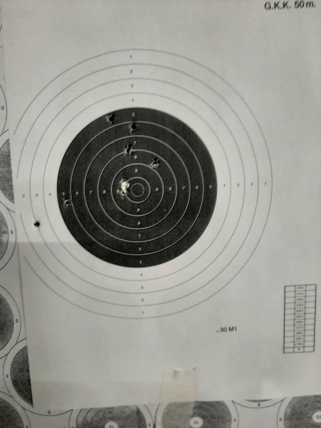

Here is just a group shot yesterday at the range with ventilation on and next to some .308 power burners with rapid fire in 6 seconds and eight shots andonly a bipod on the front end.first shots fell a little to the left ( my foult on the trigger )than it settled .![]()
If i will rest on a bag at the back end and take my time to aim corretly the group size will be much smaller.
Groups of 6 cm are not un usual
Trigger control is the main concern for getting smaller groups Is my experience .
Your groups may improve further if you use two regulators. One set a at about 130bar in a standard plenum going down to one set at 100bar in a compact plenum before the valve block. I'm already doing this with a standard regulator set at 130 and a huma regulator set at 100. The groups are amazing!
