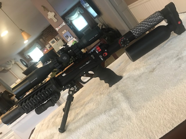

Added this .25L bottle today

Shortfuse,
What AR15 pistol grip are you running? I haven't seen this before.

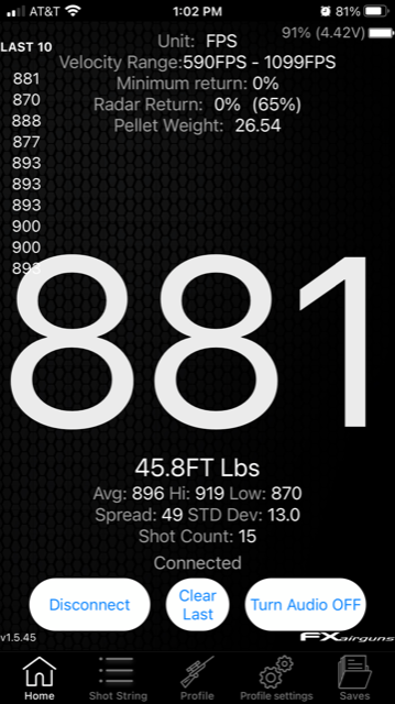

At this setting I had issues after taking the trigger off safe it would not fire put it back on safe then return to fire sometimes it would fire sometimes not one time I returned to safe and pulled the trigger gun went off so I turned the reg down to shoot 820 haven't had any issue since but I'm switching to 30 cal this week and I'm worried if I turn it up again to accommodate the heavier pellet if I'll run into the same issue. Anyone run into this cycling issue at High Power

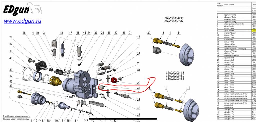

Does any Leshiy owners know what is the #34 on this diagram M10 screw is for?
LOL - If you go back to maybe page 10-15 in this thread I asked the same question several days after receiving mine. It doesn't go anywhere and the space behind is just empty. I figured that the hole was required into order to do the machine work on the valve housing and then covered so as to not look hideous.

Thanks Sean, I was wondering if that might be a place to add a gauge to monitor regulator creeps.
