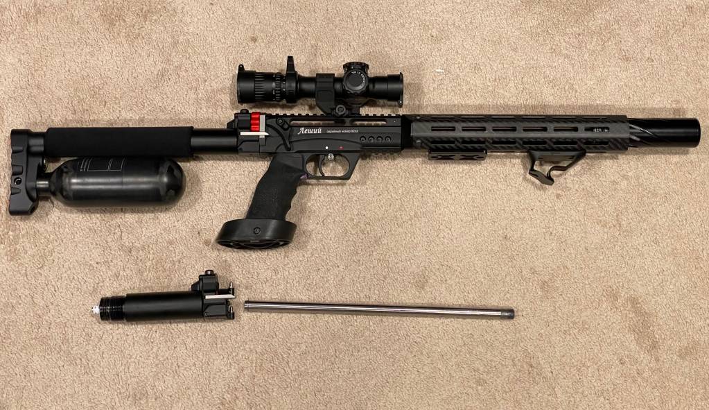

For a short time I had two Leshiy 2s because I wanted a low power .22 and high power .30 setup. But the reg and nozzles used different settings. Also discovered the larger plenum will definitely give a 10fpe boost on a .30/450mm setup. Just makes it annoying enough switching back and forth that two guns made sense in every way except financially as there was additional cost for second scope and mounts and accessories for the rail, etc. So I sold my second Leshiy 2 and went a different route to reduce cost.
I now have 2 barrels and two simple to swap valve setups. The high power setup is using the stock reg set at 160 bar with 0.2mm/0.3mm nozzles and the larger plenum. The lower power .22 setup has a Huma reg, 0.3mm/0.8mm nozzles and a standard plenum.
Swapping calibers is now as easy as drain air from tank, swap barrels while air is bleeding, swap reg/plenum/valve setup and refill. Longest part of the whole process is draining the air.

How much rezeroing is required doing this? I was contemplating something similar.
Dual Caliber Quick Change Setupe:
Do you change pucks between calibers or use the same for both? I have a .30 high power setup and considering buying a .22 setup like yours. How much quieter is the .22 setup?
@Larcat - I'm within 1 Mil when I swap between barrels.
Wow, that's really impressive. Any particular precautions you are taking or just:
Loosen four bolts.
Pull barrel.
Drop in new barrel.
Tighten four bolts.
Swap reg.
That's really pretty much it. I do have the barrels indexed with a Sharpie point so I have them turned the same each time.

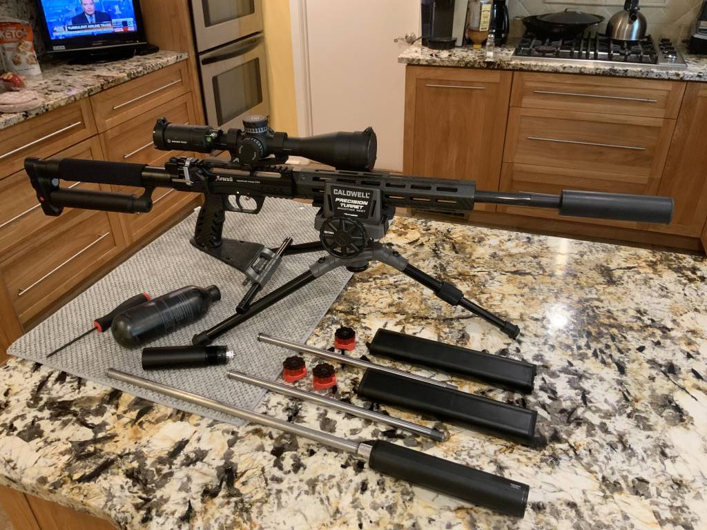

 @CTshooter, I think I’m going to have to follow your lead and get a second value setup. I generally stick to .25, find it to be a good all around cal. I have 350mm and 450mm barrels. Last month I switched over to shooting .177 with a 350mm barrel for quiet pesting around the house. Today I just switched L2 over .30 cal with a custom FX STX 600mm barrel.
I recognize this barrel🙂👍👍👍
