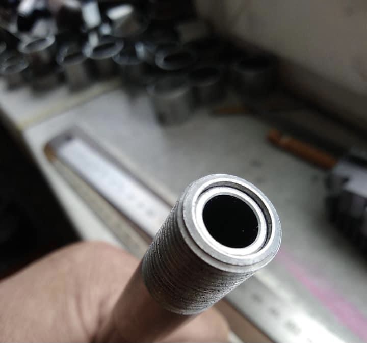

Yes it’s a custom barrel, it was built by Yehor, it has a STX Heavy barrel liner.
That's pretty awesome. Is it doing a lot better with slugs than the 600 mm Ed gun barrel?

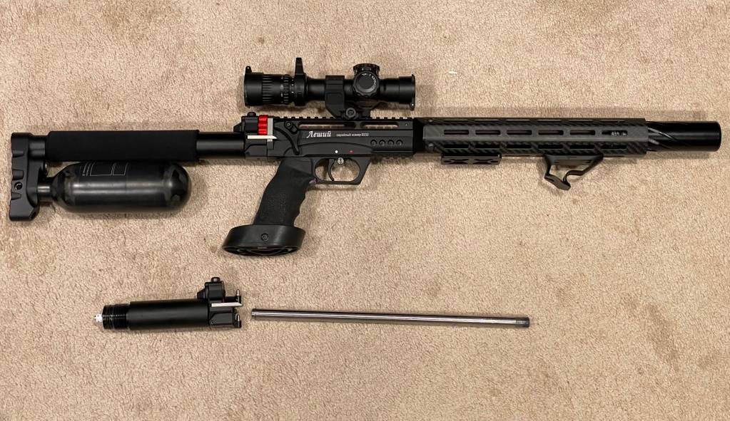

Dual Caliber Quick Change Setupe:
For a short time I had two Leshiy 2s because I wanted a low power .22 and high power .30 setup. But the reg and nozzles used different settings. Also discovered the larger plenum will definitely give a 10fpe boost on a .30/450mm setup. Just makes it annoying enough switching back and forth that two guns made sense in every way except financially as there was additional cost for second scope and mounts and accessories for the rail, etc. So I sold my second Leshiy 2 and went a different route to reduce cost.
I now have 2 barrels and two simple to swap valve setups. The high power setup is using the stock reg set at 160 bar with 0.2mm/0.3mm nozzles and the larger plenum. The lower power .22 setup has a Huma reg, 0.3mm/0.8mm nozzles and a standard plenum.
Swapping calibers is now as easy as drain air from tank, swap barrels while air is bleeding, swap reg/plenum/valve setup and refill. Longest part of the whole process is draining the air.

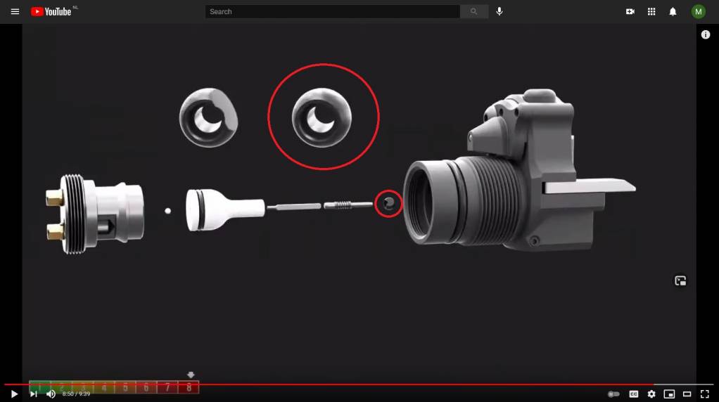

After taking a shot my L2 stopped indexing. The magazine is "locked" (meaning it cannot be rotated by hand) and will only "unlock" when the gun is opened.
So I followed Edguns YT video (the one where Brian narrates the whole film) about fixing indexing problems.
At the very last step(...), the one where one takes the valve apart, I found that the little 4mm black ball is completely missing...
Did you lose that ball in dissasymbly, if not where could it have gone?
Gone with the wind?
Comtruise same problem down at page 94, fixed it by adding a short spring
https://www.airgunnation.com/topic/edgun-leshiy-2-2/page/94/
