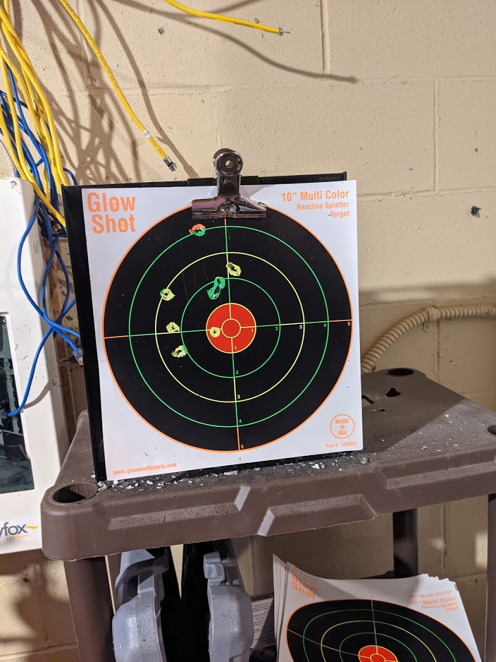

Just received my Leshiy 2 this week. It is as beautiful and well-built as all the hype suggested. The problem that I am having is accuracy. I'm positive this isn't a failure of the design, but mine just won't be consistent. I'm talking 6-inch differences from a bench at 10 yards!
Brian has been very responsive and is a great guy, but he can't help until I can get it on a chrony which can't happen until Sunday.
I've cleaned the barrel, tried several different pellets, have been very mindful of not dwelling on the trigger, and checked to make sure the barrel is properly seated. It indexes fine and doesn't blow air if you linger on the trigger.. It has 2x .2 jets (according to the stamp) on .22 caliber, with a 250mm barrel and the mod 50 huma moderator.
I have not changed jets or touched the reg, it shot this way out of the box. I'm sure Brian will be able to help once I can get him some Chrony numbers but I'm wondering if anyone else has had this experience and could point me in a productive direction. I'm supposed to leave on a hunting trip next week and REALLY wanted to take it with me. Attached is a typical group I'm getting from a bench at 10 yards. Something is definitely wrong, I'vthroughe never had a problem shooting 1 inch groups and through the same hole from this bench at this range with any other gun.
Bad barrel/Choke? Bad regulator? Operator error?
A couple of thoughts ( chronograph is important ) but check these as well
1) Loose scope ?
2) Remove moderator and try shooting a group.. I know, it will be Loud as hell, but it will eliminate " clipping " ( Be sure and remove the entire moderator )
If those check out then the chronograph numbers should tell the story once you get them..
Yeah I've tried with no moderator, unfortunately the story is the same.
Have you tried to manually push the pellets in to the breach? I think this would rule out magazine alignment issues.
Good thought! There is no damage on the moderator that I could see, I unscrewed all the pieces and examined each. The scope is tight, works on other guns, and I have had the same result with another scope, and with no scope.

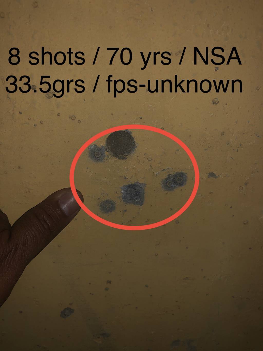

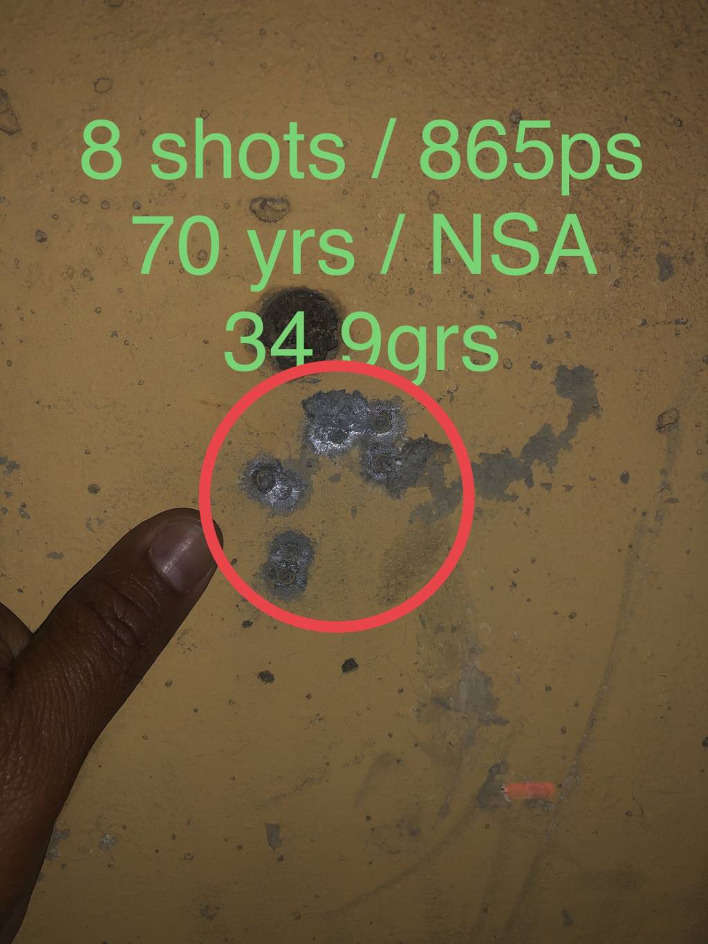

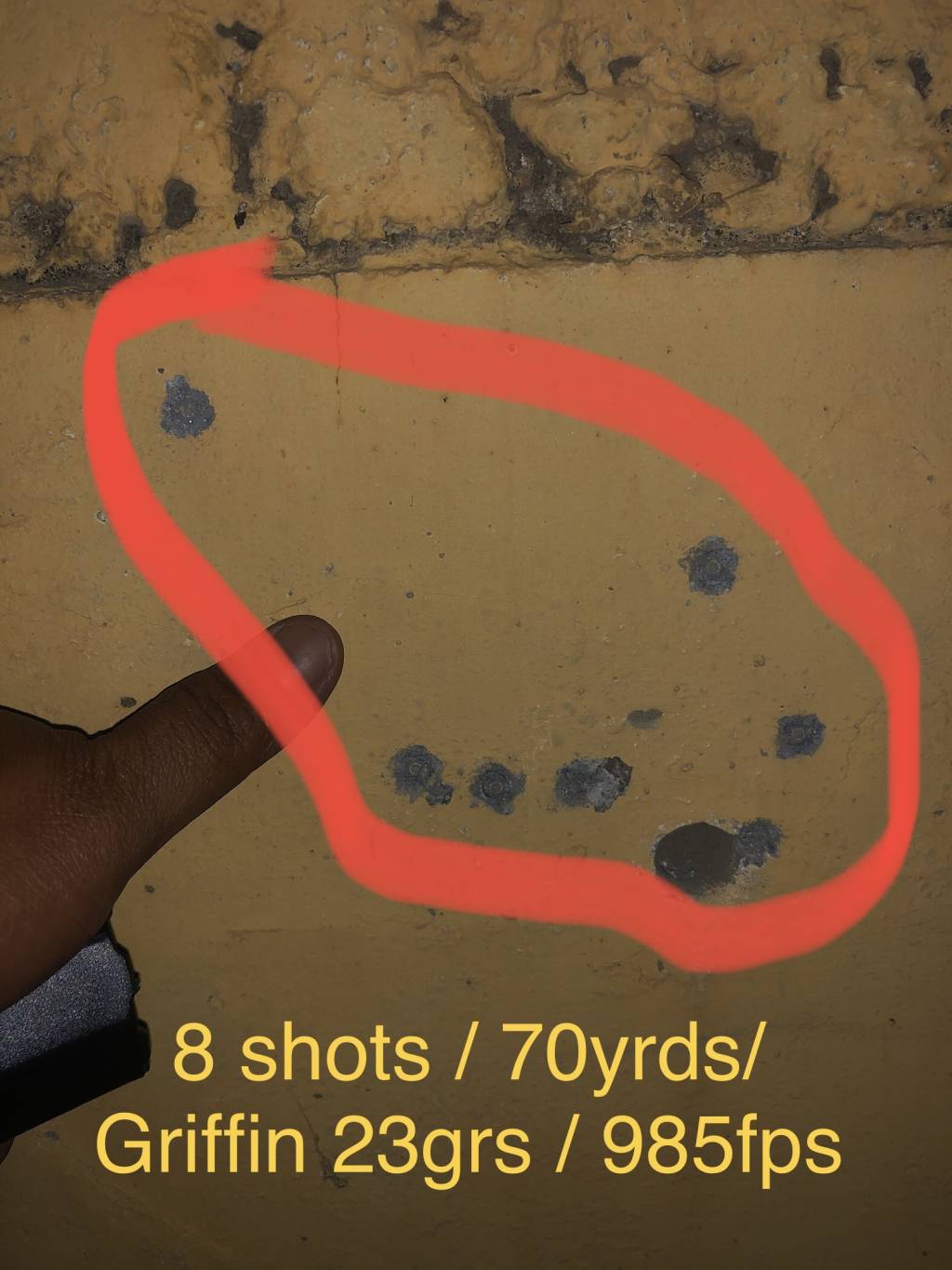

I have been testing my L2, .25cal / 350mm barrel for the past few days. My reg set at 165bar, blocked off one of the jet. My gun come with two .02mm jets. Since slugs take little longer to leave the barrel and the valve have to stay open to accommodate the slugs. By blocking off one of the jet my gun seem to groups better. Here some pictures of my results.
I will be do a lots more testing with slugs and mess around with reg & jets setting. Hopefully I'm getting better groupings
You might want to try the JSB knockouts 33.49 grain Slugs. I had good results with them and they fit in the L2 magazine better most other slugs.
