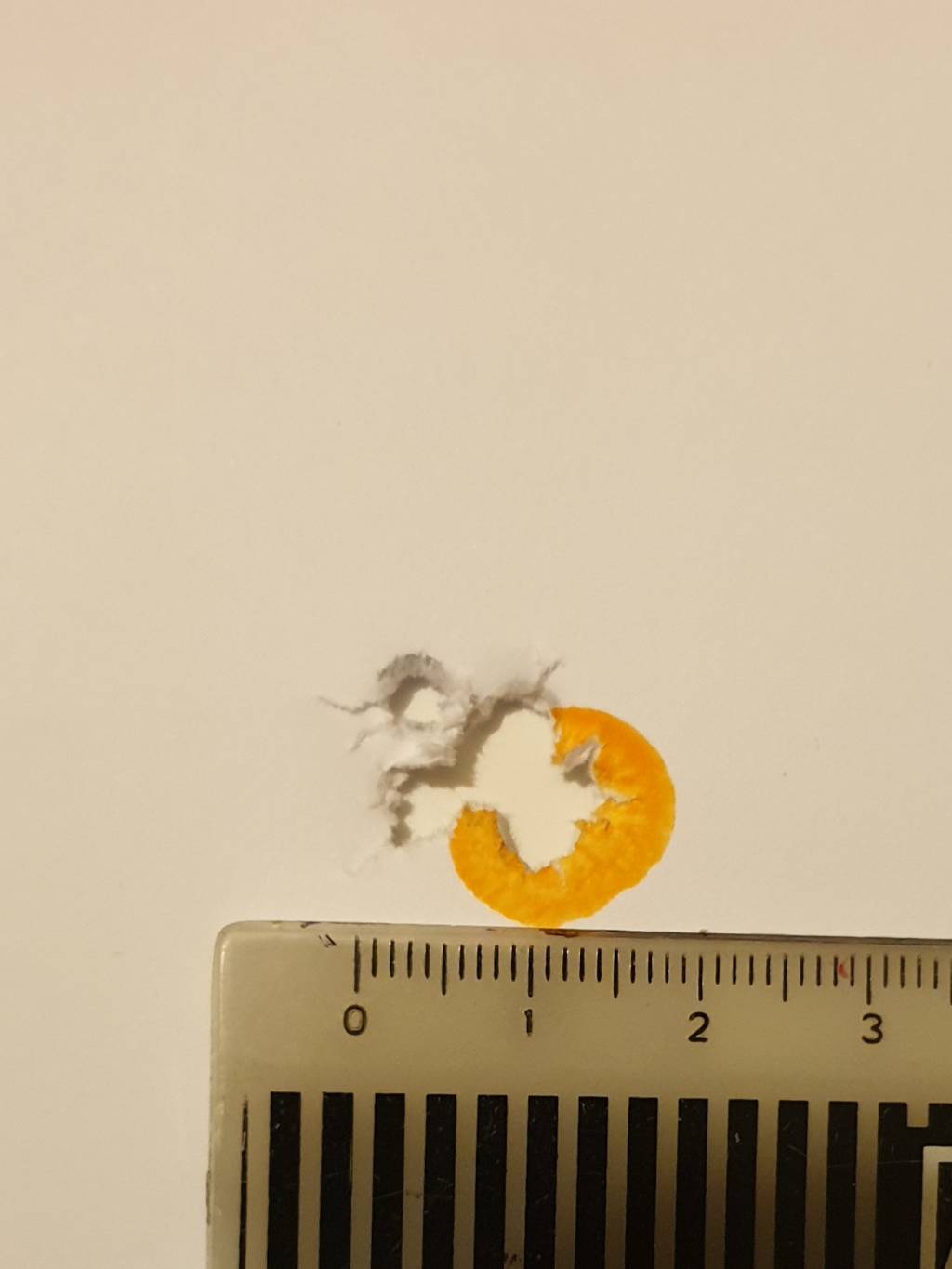

Mine shot awful out of the box too. I have a 250mm .22 cal. But with a Walther barrel. I changed a lot of things to get it in a good place! Mine came in a pretty much default set up as it was one of the first batches to be sent out. So 130bar reg, stamdard plenum and jets. One had a "7" marked in ink on it and the other no markings at all but I'd guess a .2, so whatever that means is anyone's guess! I am in the UK so a 2.5 mm puck was installed to bring the power down to sub 12ft pounds but with no air saving whatsoever so basically about 4 mags and done. On top of that the groupings were absolutely awful like yours, made only slightly better depending on pellet choice. I found JSB exact jumbo 15.89 gr worked best but still awful at 25 meters. I have since blocked off valve hole with a screw, fitted a 1.3 valve in the other (it says 1.3, it's the largest hole in the set) I run 2 regulators, one set at 100bar and the other at 70bar, both fitted to a standard plenum into a compact plenum respectively. Both of which go into a compact butt stock to keep the length as short as possible. I now have the groups down to less than 15mm with JSB jumbo exacts 15.89 gr.
Other pellets have tightened down too but I will say I do find my Leshiy 2 pellet fussy to the JSBs and will probably not shoot anything else through it.

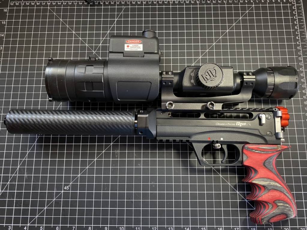

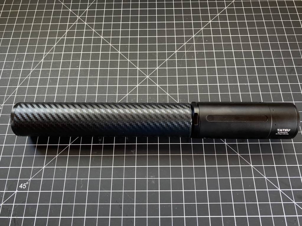

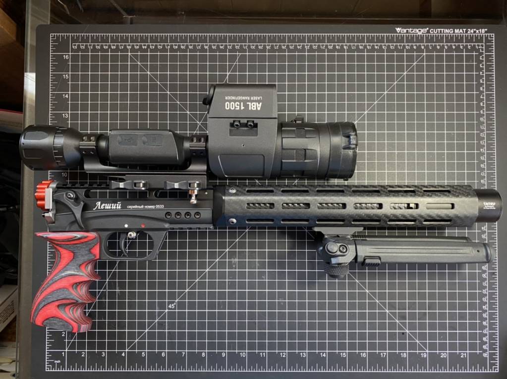

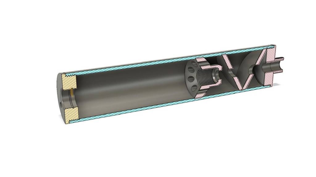

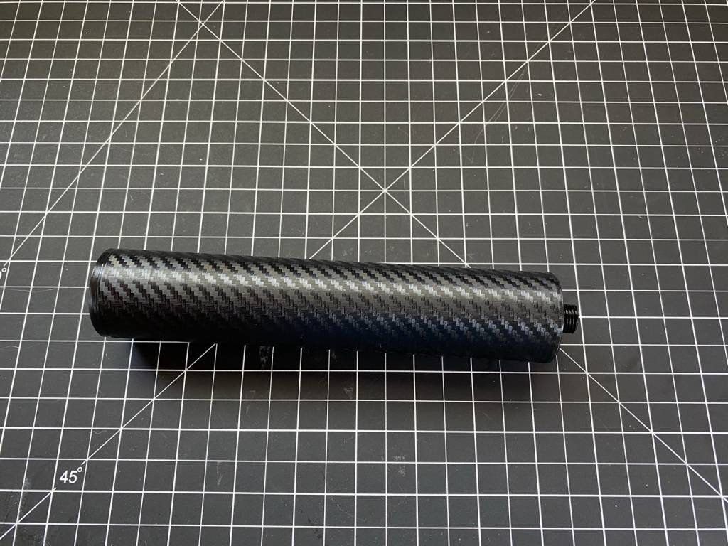

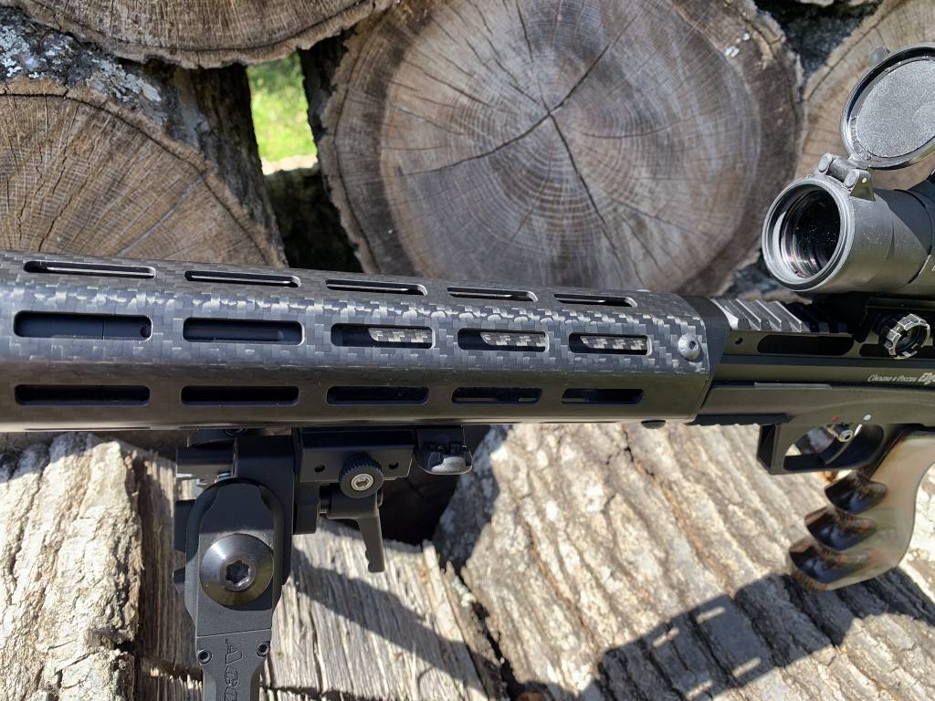

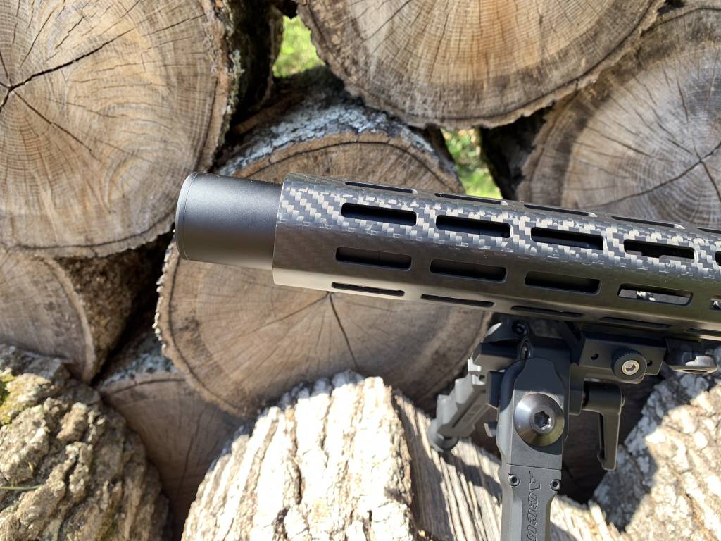

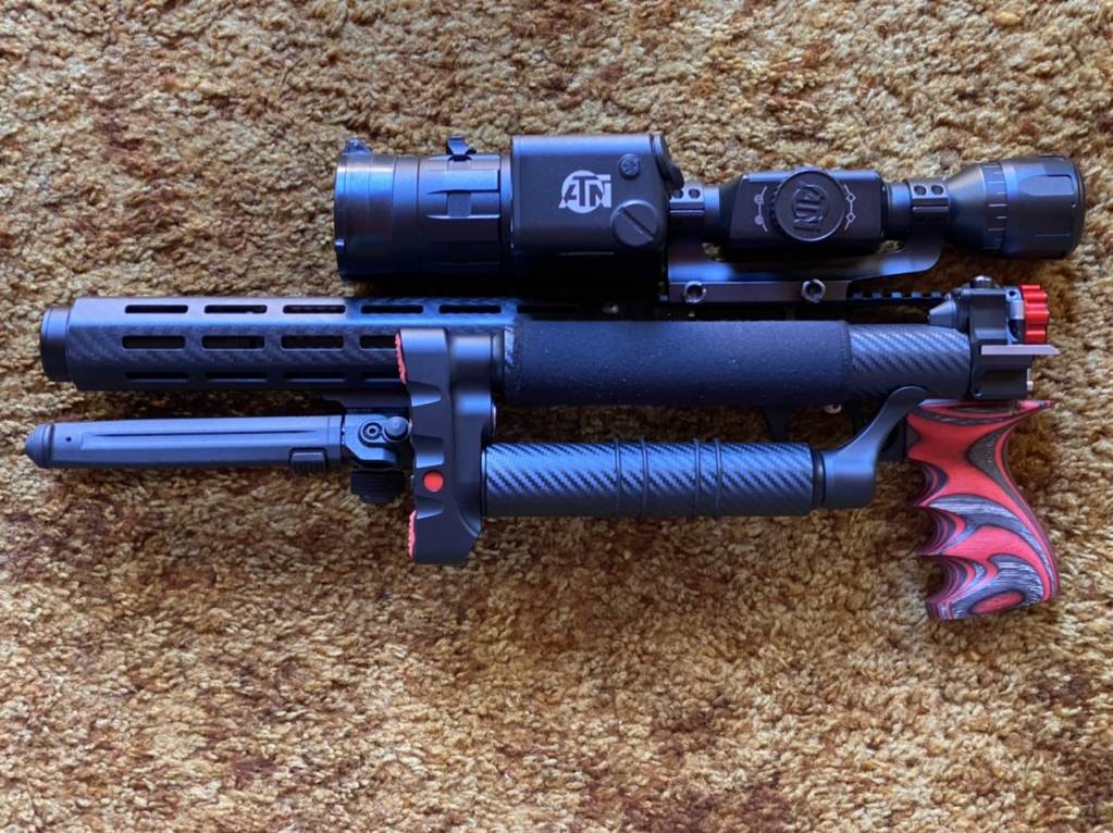

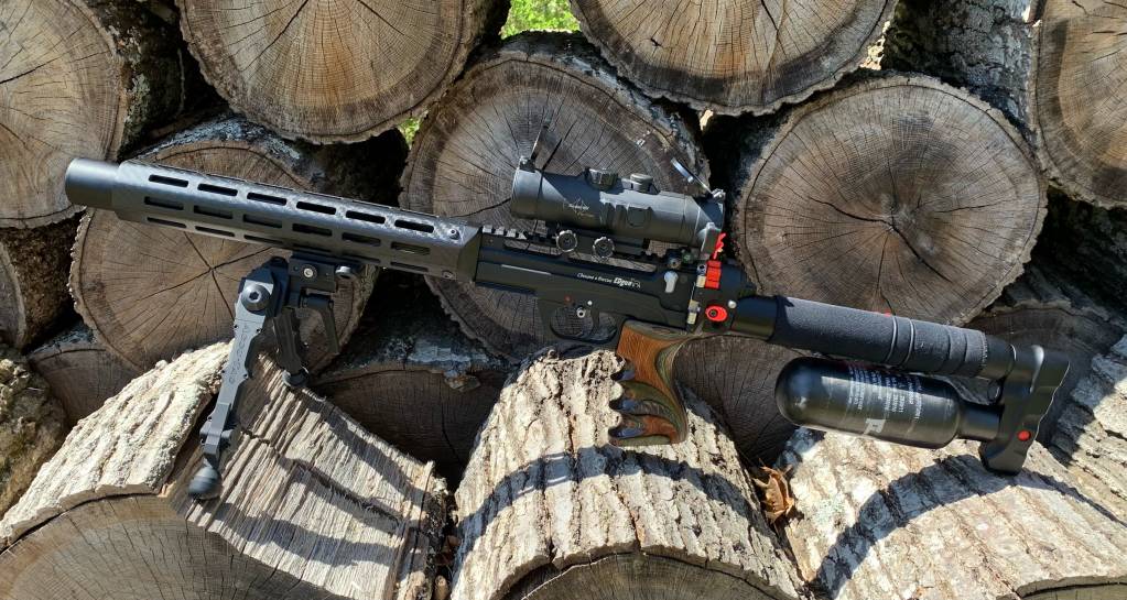

Finally completed my Leshiy 2. Nice and quite. I made the custom shroud with couple of baffles to push the air back over the barrel so I can use a short DonnyFl’s Tatsu.

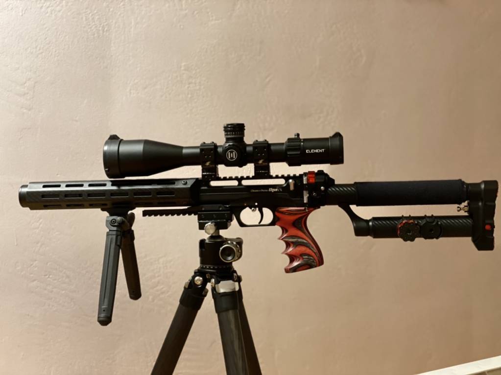

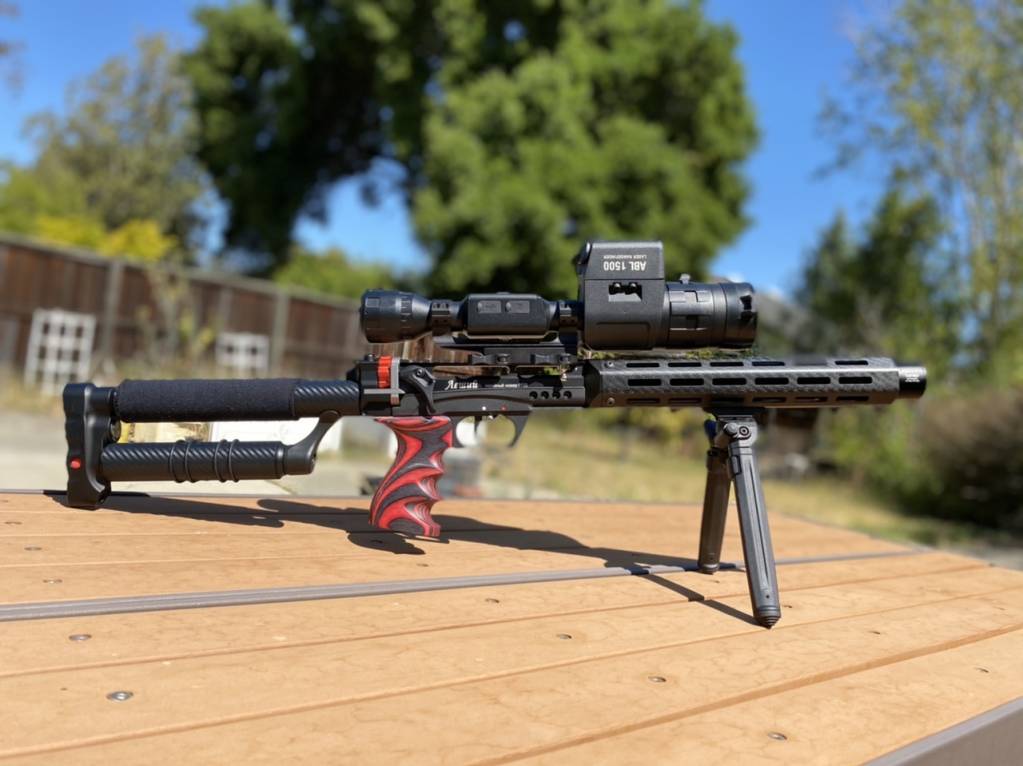

Jack.. is that a magpul bipod? Are you able to fold and lock with bipod collapsed or not?
-Krish
Yes, it’s a Magpul M-Lok bipod. It’s as a hairline clearance when folded.
I’ve also added a Arca railing underneath for tripod mounting. And it can still be folded.

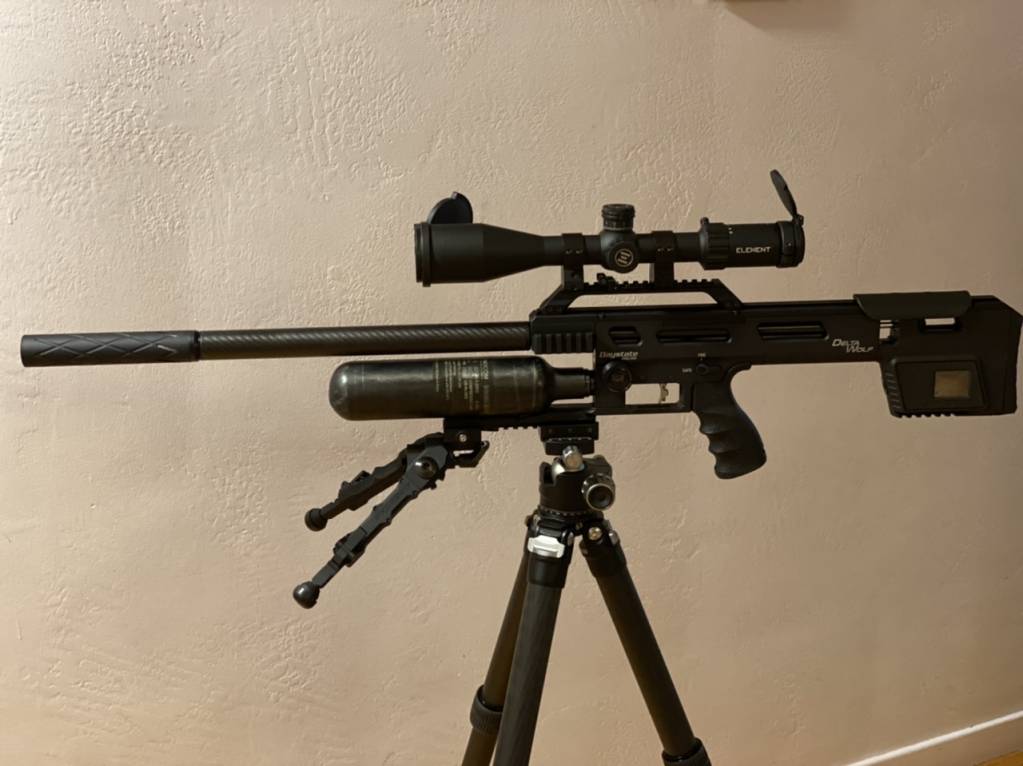

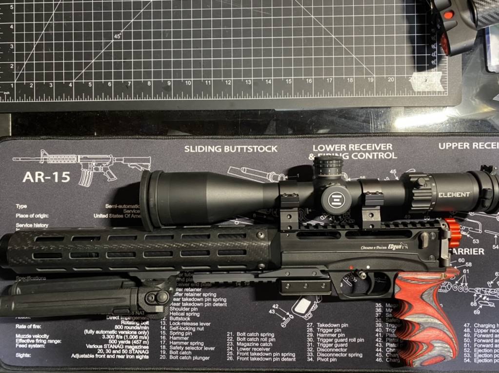

Where did you got that extended picatinny/Nato rail? Is that Arca a separate piece or part of the long rail?
The rail extension is a Yankee Hill Machine Rail Extension (YHM-9473). The ACRA adapter is a Rekon Tripod Adapter Picatinny Rail to Arca-Swiss Mount RTA-1. Together these both make a very good combination. I use the same setup on my Delta Wolf also.
