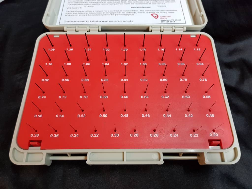

For everyone wondering what size their jets really are, the only way to determine that is to use a pin gauge. I purchased a set awhile back because the jets that came with my L2 weren't marked. The gauges aren't cheap but might be worth it to some. I posted them awhile back but it's somewhere buried in this massive thread.

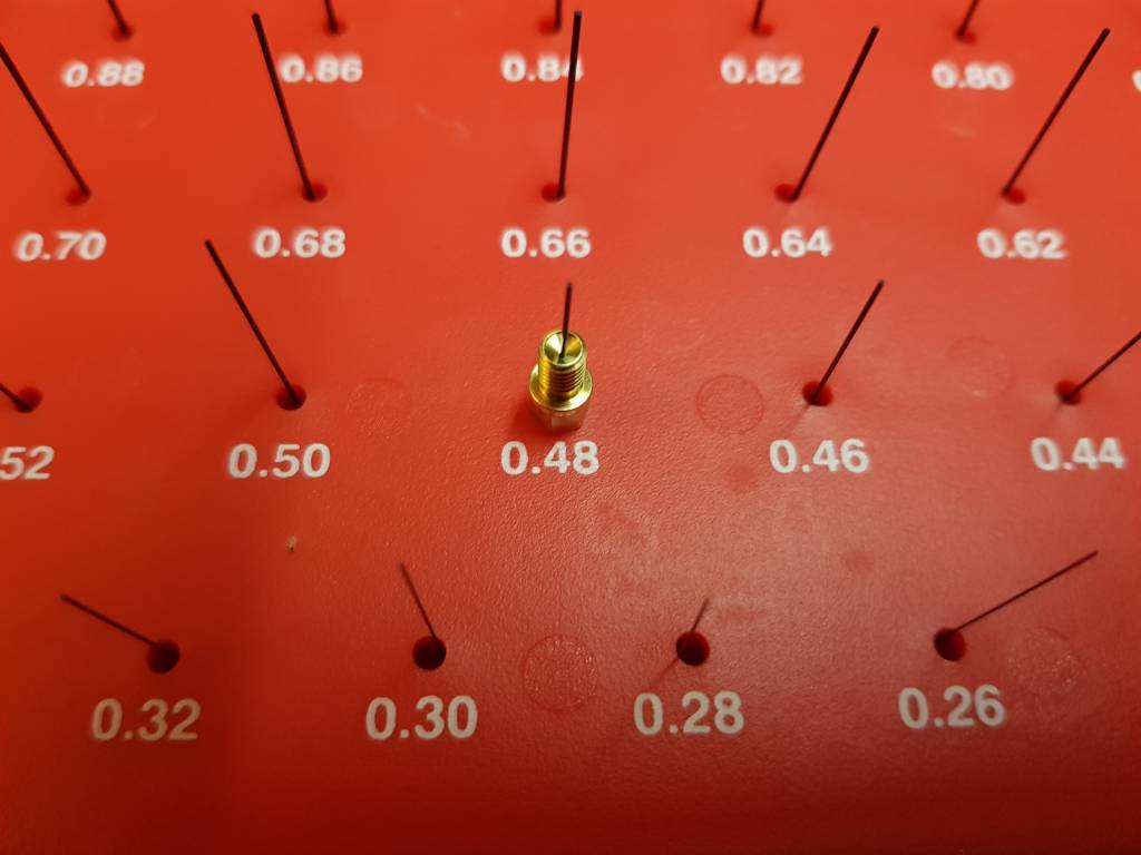

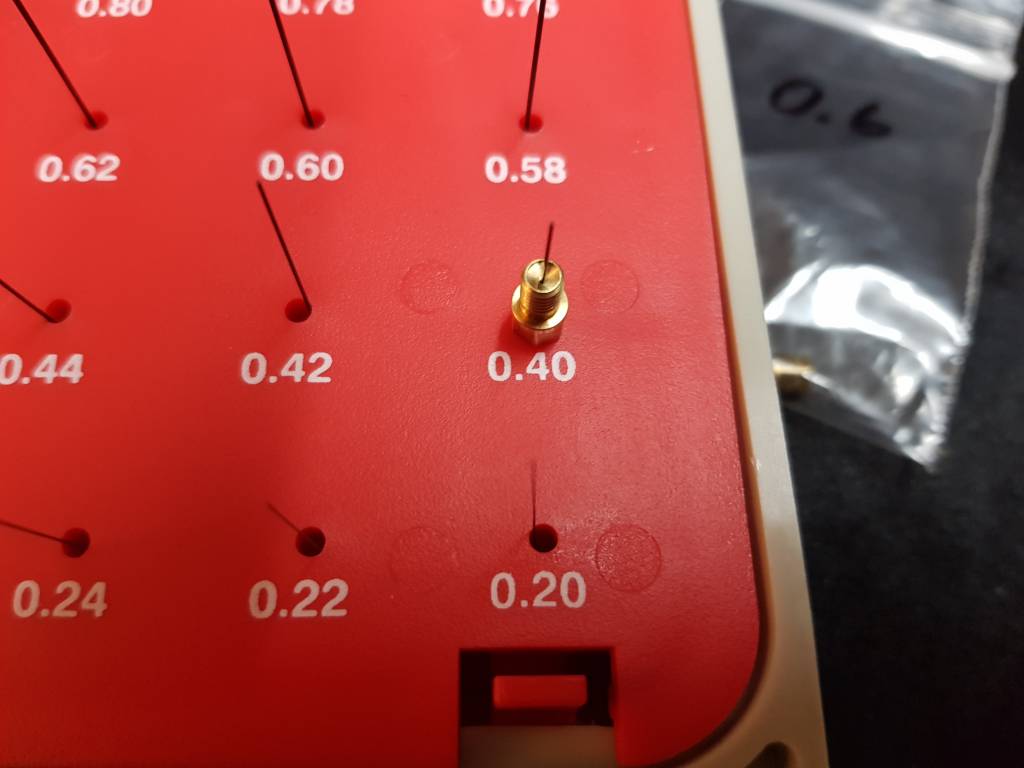

Peskadot, what were the sizes of your stock jets and what caliber did you purchase?
I ordered the .25/250mm. The factory jets were not marked or engraved. After receiving mine, I asked Brian what size power jets should my configuration come with and he told me 0.40mm and 0.50mm. I just measured them with my pin gauge and he was correct except the 0.50mm jet was actually 0.48mm but close enough lol. I've changed my configuration to a .30/350mm setup with 2ea. 0.20mm power jets and set the reg to 155 bar currently getting 840 fps with 44.75gr JSBs'. I haven't made any other changes since due to work.
I actually measured the complete set of power jets that I got from EDgun West with my pin gauge and they are all on point with the exception of 2 sizes. The 1.10mm was actually 1.08mm and the 0.30mm was actually 0.28mm. A one hundredth of a millimeter off is pretty close to me. At least I have confidence knowing that the engravings on the power jets actually match.
Thanks that is super helpful. So the kit from EGwest is reliable in its marking, just not necessarily the jets that come stock?
