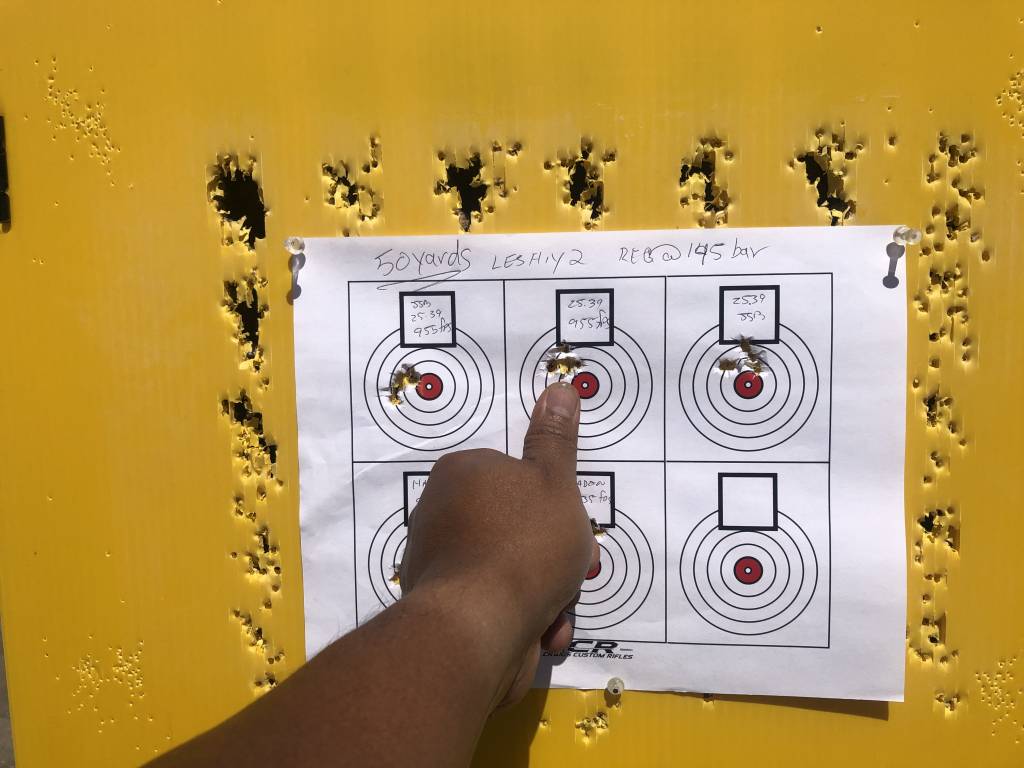

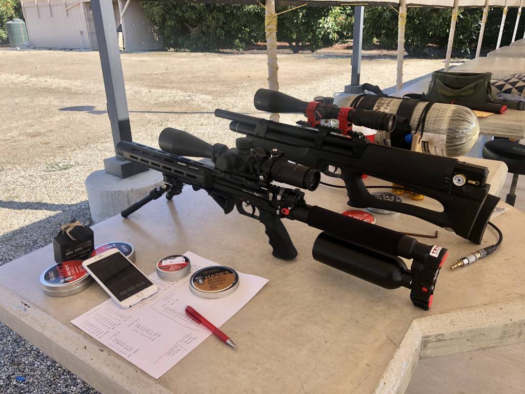

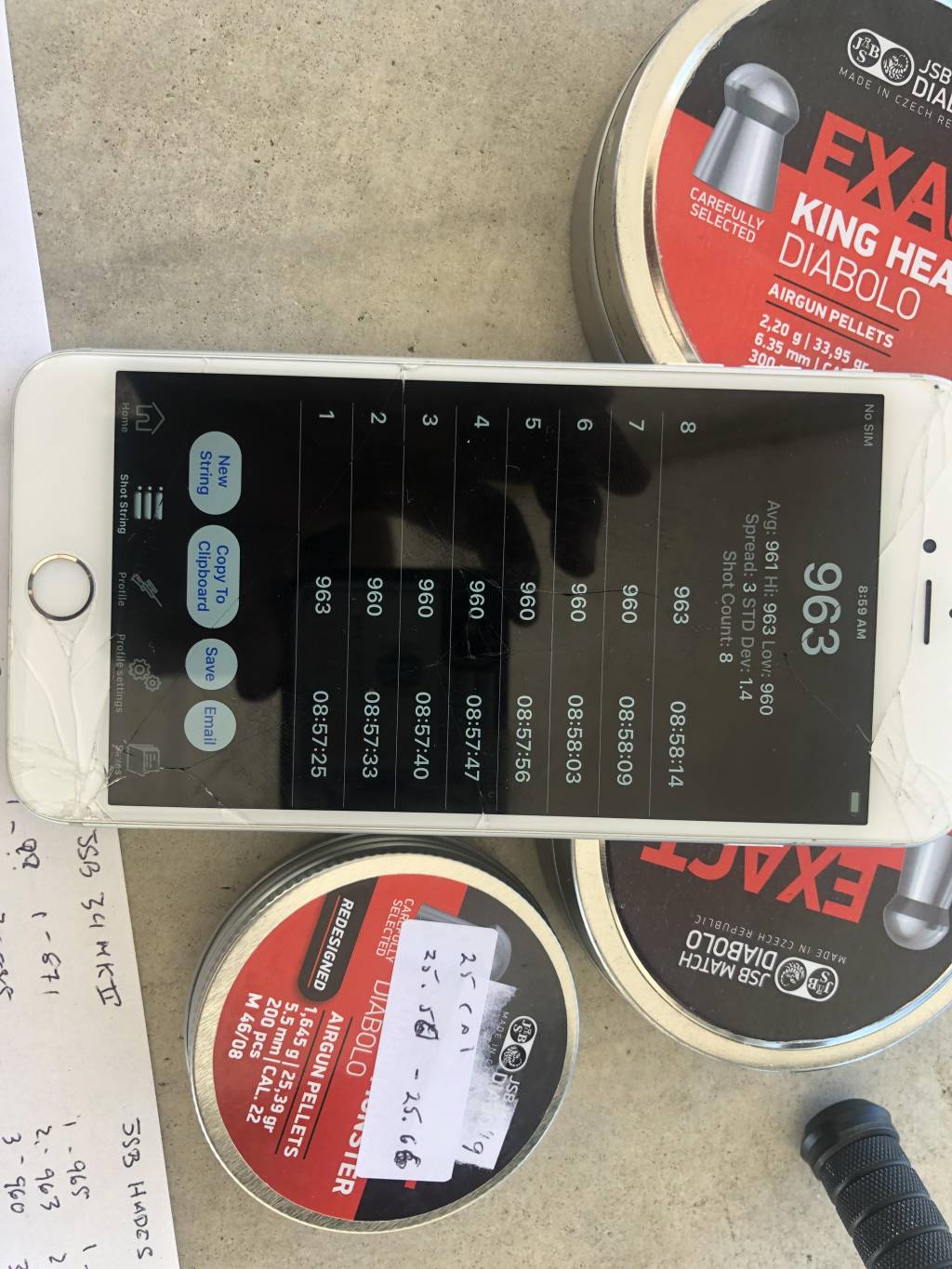

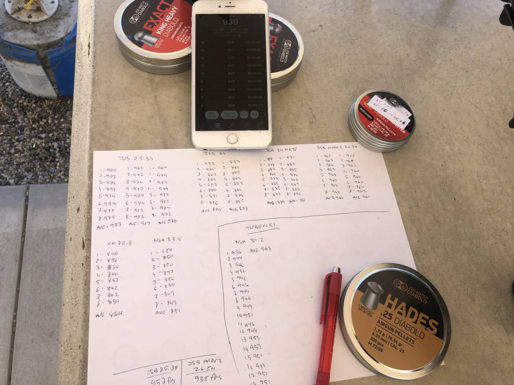

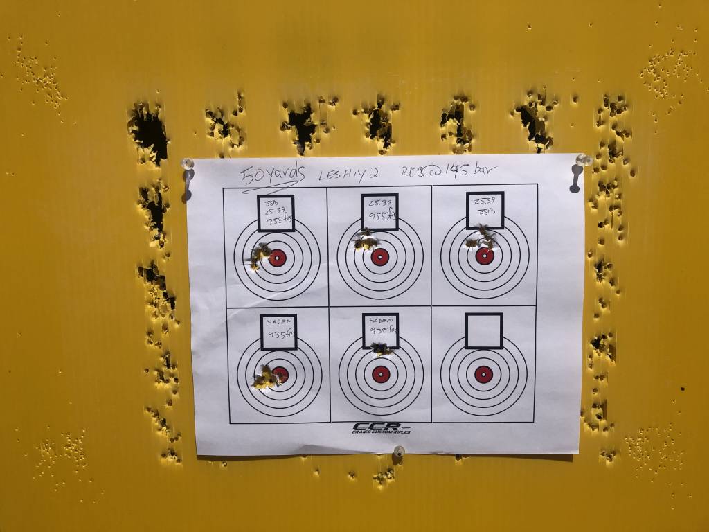

I had been spending a lots of time shooting these two guns between Leshiy2 and my all-time favorite Huben K1. Both semi-auto and fun to shoots. I'm going to leave my Huben as a slugs gun and L2 as a pellets shooter. Check out JSB HADES 26.54gr at 50yards. Reg pressure set at 160 bar, one .02jet and other closed off, shooting about 960fps.
Nice numbers and grouping with that speed.
Is that with a 350 mm barrel?
How many shots do you get out of that little tank?

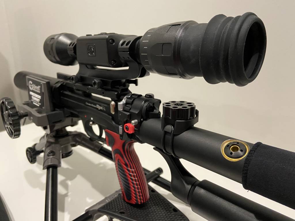

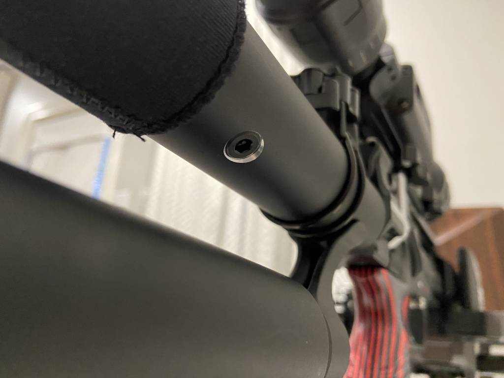

Looks like I found out what the LESHIY 2 REPR is all about. Just had to lift up her skirt to find out!
This is my second Leshiy 2, the Hornet 25 cal edition. Topped off with a thermal ATN scope.
That appears to be an externally adjustable regulator. Some little birdie told me it’ll adjust from 60-280 bar without having to bleed off the system.
I think this is what Ed was referring to when he said he’d be constantly innovating and upgrading the Leshiy 2 platform.

It's a .25cal, 350mm Alpha Precision barrel. I'm getting about four magazines from 300bar fill.
Furthermore, this gun shoots slugs pretty well. However, I have to set the regulator at 170bar and shoot VK 32.8grs around 900-910fps. A friend of mine has the same setup and shooting NSA 29.5 grs around 940 fps with very good results. The reason my gun is tuned to shoot pellets now cause I'm running low on slugs, plus I have about 7cans of pellets to mess with.
I wonder why the new version would have an externally adjustable reg but not have a gauge for the reg preasure? The English chap on UTube has made a plenum with an external gauge . Put both together on the Leshiy and then I would buy the part to upgrade mine. But if it is only the external reg adjustment I’ll wait. I only plan on changing my reg two times a year when going between .30 and .22. A gauge for the reg pressure is more important to me.
