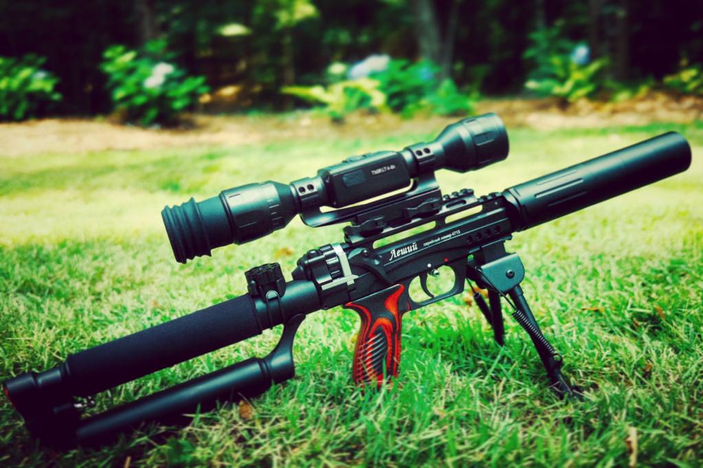

Looks like I found out what the LESHIY 2 REPR is all about. Just had to lift up her skirt to find out!
This is my second Leshiy 2, the Hornet 25 cal edition. Topped off with a thermal ATN scope.

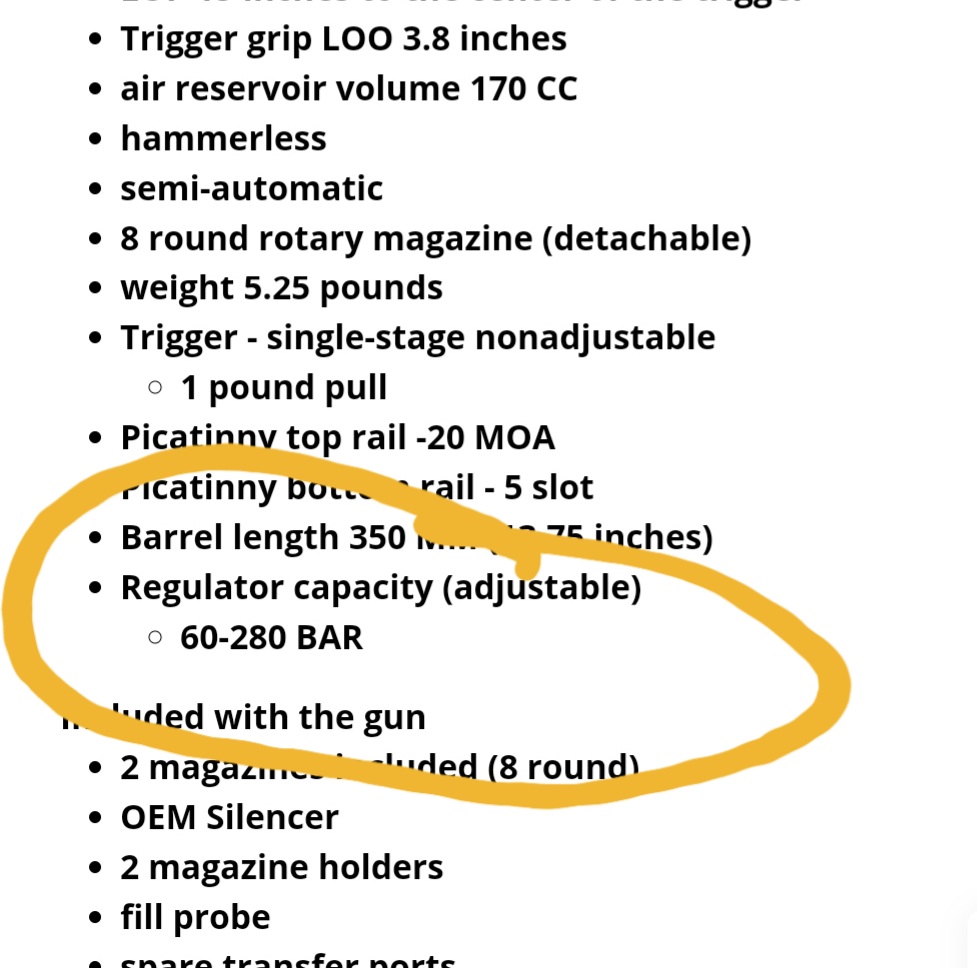

That appears to be an externally adjustable regulator. Some little birdie told me it’ll adjust from 60-280 bar without having to bleed off the system.
I think this is what Ed was referring to when he said he’d be constantly innovating and upgrading the Leshiy 2 platform.

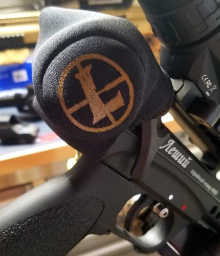

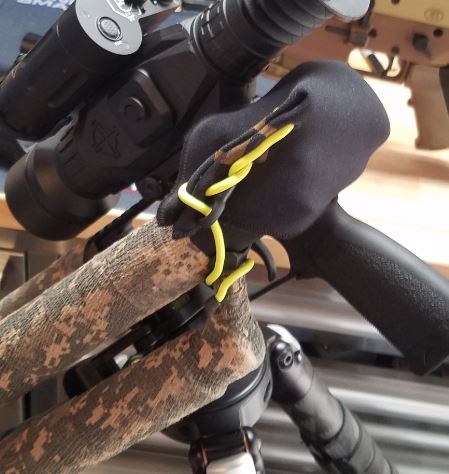

while we are waiting for somebody with a 3D printer to start making a cover for the working parts of the Leshiy 2 when it is folded for transport, i kluged together a workable solution from an old neoprene scope cover and a bendable gear tie. stretches on, pops off when you close the leshiy.
don't laugh!!!! at least it has an "L" on it. bloody custom, mate!
that looks awesome!!!
External adjustable regulator peaked my interest. has anyone tried to tune the gun back and forth from say 8fpe to 30 FPE?

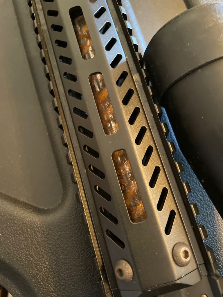

try to stay out of this thread as much as possible so you guys can have fun discussing things, but I just want to point out one thing. No harm will come to the gun by storing it folded. The valve and air tube are totally sealed, and the only way anything is going to move is in the direction of the barrel. If any debris were to get onto the transfer port area, it would be blown out of the barrel. Nothing in this world is perfect, but the Leshiy 2 is highly durable.
The photos are from an owner who accidentally dropped his Leshiy in saltwater and dove down and got it. The owner, not wanting to lose his hunt, continue to use it for two days until it became rusty. He sent it to me for repair. I had to extract frozen bolts. Also, I cleaned, replaced, and polished some parts, and it was back to working again. The inside of the valve was still clean.
I’m not suggesting to treat your gun this way, but I want people who lurk and read this to understand that the weapon was designed to be carried folded by Ed, it’s your gun, by all means, protected the way you want, but storing it folded is the safest s and easiest way to transport the Leshiy 2
