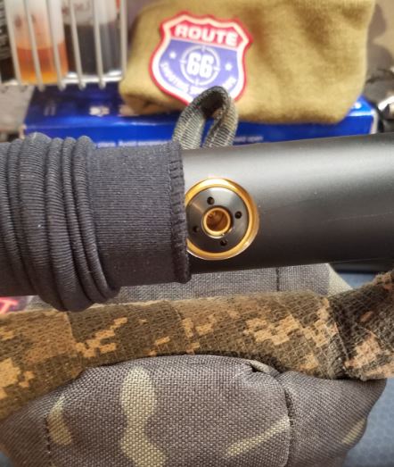

i got mine from egw a couple weeks ago, and it appears to have part of the mod, just no port for a pressure gauge.
This time I’m going to sit on the fence awhile and watch and see how the new external adjustable reg works for everyone. Not that I doubt it will work well and it is something that was needed for this platform. My first queastion on this is since this makes my reg tester obsolete can I at least use the gauge from the reg tester in the new R.E.P.R. Regulator and can it be left in all the time and the tube be oriented so that the reg adjuster is on the left and the gauge is on the right? I can see a new item for the 3D printers to make a protective shield that will attach to the tube and surround the gauge protecting it from bumps.

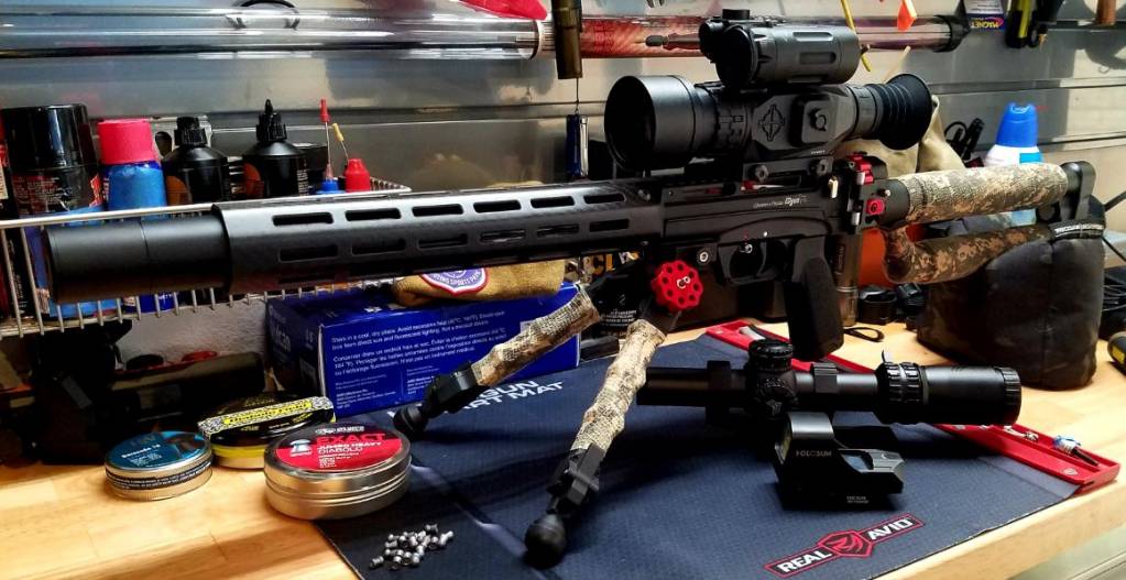

edgun pic time...i really like that the leshiy 2 is adaptable fill several roles with a quick configuration change. this is why i like good quality qd mounts.

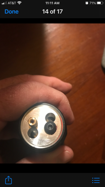

Is it just me or do the nozzles look a whole lot like Mikuni carburetor jets? I’ll more than likely take mine apart shortly and compare to the hundreds of different carburetor jets I have here from my motorcycle tuning days. Thanks if I find out what actually fits I’ll let you’s know. Last time I had the jets out it was for making an adjustable Cobra valve for an Evanix K550.
Wow, they really do look identical....

My L2 in 25 cal came from the Factory with 1 large Jet (unmarked) and a Plug I have since changed to 30 cal and want to purchase the appropriate Jet my question has anyone on here gotten one with a Plug removed the Plug I'm wondering if the Power Jet Valve spring is under that Plug or will I have to purchase that part along with the Power Jets (trying to find out without going through the process of removing the Plug). Also looking for recommendations of what power Jet combo is best and does anyone have any of these parts there looking to sell. Thanks Keith 732-678-6706
My .25 came with two jets -- details somewhere earlier in the thread -- apparently many of the stock jet labels are unreliable.
.5 jet and a plug at 145bar works great in my 350mm 30cal. I get 830fps with the 50gr JSB and 860fps with the 44gr JSB. Both pellets are 3/4 in groups at 50 yards.
