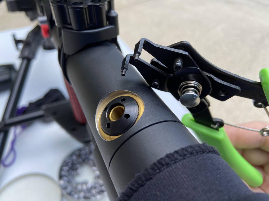

So to put it simply, the new external reg is awesome.
You’ll need a pair of split ring pliers to do this.
To increase reg pressure, turn black ring clockwise.
To decrease reg pressure, turn black ring counter-clockwise.
IF DECREASING PRESSURE, TURN IT SLOWLY BY A FEW MINUTES ON A CLOCK FACE AND DRY FIRE THE GUN 2-4 TIMES, THEN TAKE A VELOCITY READING. DO THIS REPEATEDLY UNTIL YOU REACH YOUR DESIRED VELOCITY.
To safely increase/decrease reg pressure, I turn mine about no more than 5 min on a clock face. The smaller the increments of change, the more precise the fine tuning.
I personally tuned mine for accuracy. Shot a group, adjusted reg, shot another group, until I reached my desired accuracy. Then I shot it over the chrony to find out velocity.

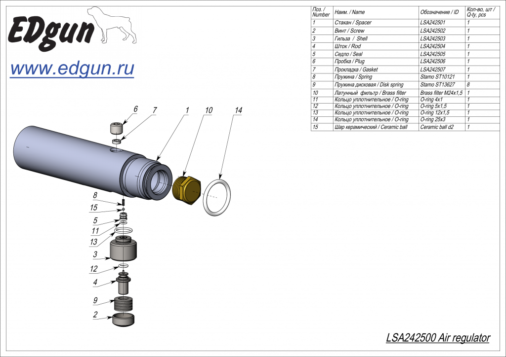

excellent shots, wasn't there another port on the underside?
The port on the underside is a plug where a pressure gauge can be installed to measure reg pressure. I don’t see the need so I’m leaving it as is.
The drawing here is upside down to how it actually looks installed. Part #2 is what you turn to adjust pressure.
These will be able to be retrofitted to other L2s correct?
Correct according to Brian at EdgunWest. I just placed my pre-order with him.

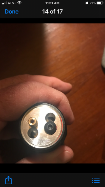

My L2 in 25 cal came from the Factory with 1 large Jet (unmarked) and a Plug I have since changed to 30 cal and want to purchase the appropriate Jet my question has anyone on here gotten one with a Plug removed the Plug I'm wondering if the Power Jet Valve spring is under that Plug or will I have to purchase that part along with the Power Jets (trying to find out without going through the process of removing the Plug). Also looking for recommendations of what power Jet combo is best and does anyone have any of these parts there looking to sell. Thanks Keith 732-678-6706
.5 jet and a plug at 145bar works great in my 350mm 30cal. I get 830fps with the 50gr JSB and 860fps with the 44gr JSB. Both pellets are 3/4 in groups at 50 yards.
Have you ever taken the Plug out if so was there a Jet Spring Valve under the plug
My gun came with 2 Jets installed. I installed the plug without the spring valve as I was instructed by Brian at Edgunwest. My guess is there is no spring valve under your plug.
