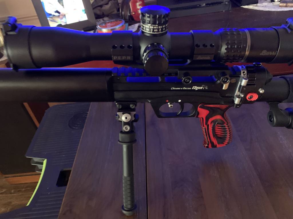

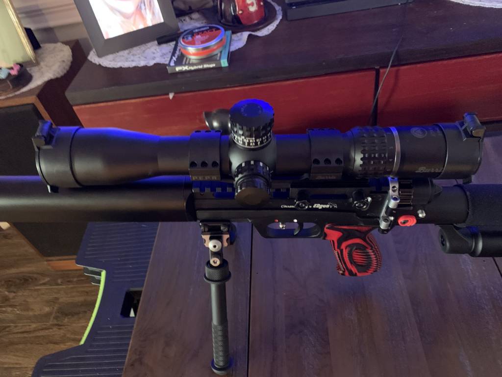

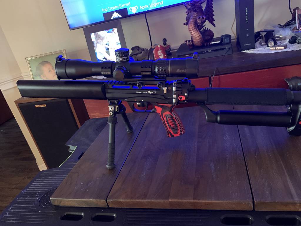

After 6 weeks of reading and watching the videos here, this is what I have come up with so far. At 75 yds this thing is a laser ! Next is the moderator/shroud swap. Maybe the 450mm barrel. I need to move the bipod forward and 45 a red dot or Eotech holo. The bell is about to toll for a few coyotes and feral hogs in central Florida. ( And maybe a few Iguanas down south )
Thanks to everybody here for the help and input even if you didnt know you were helping : )
what kind of results are you getting with the FX Hybrid Slug, .30 Cal, 44.5 Grains (accuracy and velocity)?
Wanted the accuracy to zero the scope and use the rest on little stuff like starlings and rabbits. I have Nielson 54.5's for small hogs and coyotes. The Diabolos are decent but just dont hit as hard as the Nielson slugs. Not really sure but maybe turkeys and iguanas. From what I have read and seen on video, there are very few slugs that can match their accuracy. The FX just were the easiest to get my hands on.

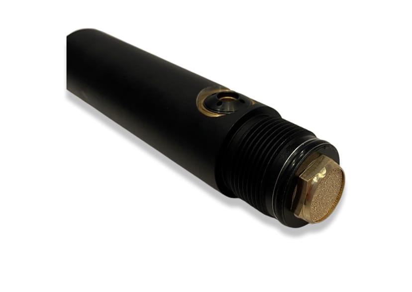

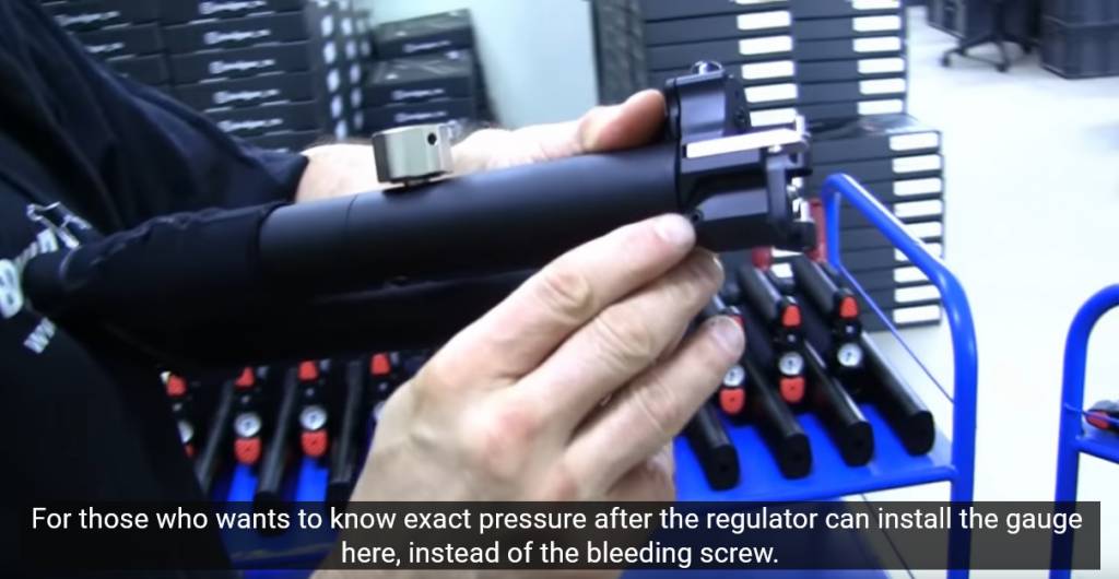

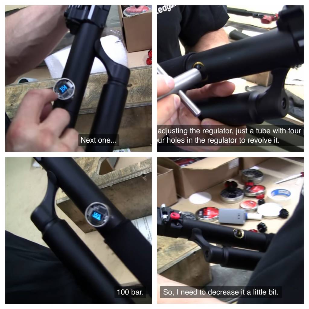

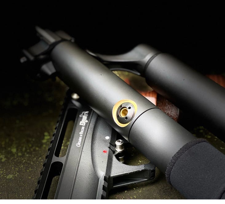

My question how do you A-line the REPR Plenum and Regulator in different positions? I noticed in the videos the gauge port and the regulator adjuster are on different sides and at different angles.
Bleed the air on your L2 then use hex bolt under the top butt stock cover to adjust the tube alignment.
Maybe I’m missing something but it looks to me that the threads attaching it to the valve would control where it’s indexed.
My bad, that’s was for butt stock alignment.

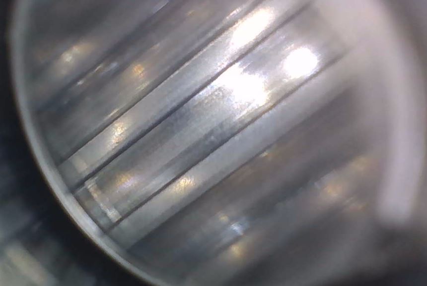

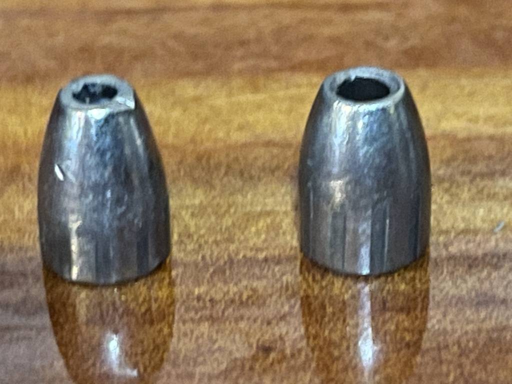

Pushed these through the .25 350mm alpha barrel today. The left is NSA 34.9 gn the right is FX hybrid at 26 gn. It was actually a pretty tight fit, but I don’t see any markings from the valleys but there is pretty good engagement of the rifling. They will fall out of the front of the magazine, but if you leave the mag in place you can load it without them falling out. They cycle fine since there is only the machined surface for them to ride on.
The NSA averaged 860 over 8 shots.
The FX averaged 959 over 8 shots.
Oh and does anyone know the twist rate of the rifling?
