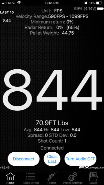

So I bought my Leshiy 2 second hand the regulator was adjusted to I don't know what Bar it was a 25 cal bone stock 250mm Barrel from the factory except for the reg being adjusted way down after chrony testing it was shooting 640 FPS so I opened it up to up the reg and see that I have 1X jet with a large hole and a plug. I up the reg quite a bit 965 FPS at 55 FPE but the Mag is not cycling correctly so I drop it back down to 880 FPS 46 FPE All trial and error because I don't know what my Reg is set at fast forward I got my hands on a 30 cal 350mm barrel Tuned it way down to 690 FPS Getting around 45 FPE and 6 Magazines and super quiet all while still using 1 Jet and a plug. A gentleman on here was extremely generous offered to lend me a Reg Tester and I bought a set of .3 Jets as per Ed's Chart and a spring piston because they don't put the spring piston under the plug from Francisco, Tested the Reg it was at 105 Bar so I marked it degassed and filled and degassed it in increments so now my Reg is marked at 105,120,130,140 and 160 currently set at 160 Bar getting 844 FPS at 71 FPE with Hades Pellets Very Destructive and still very Backyard Friendly with a Mod 40 Long

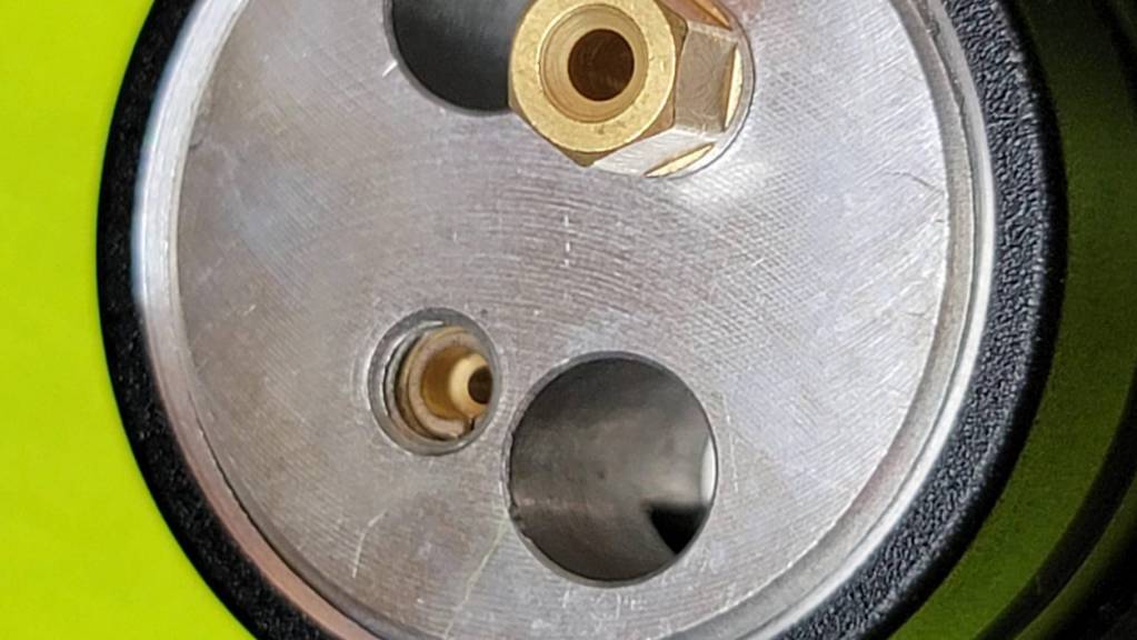

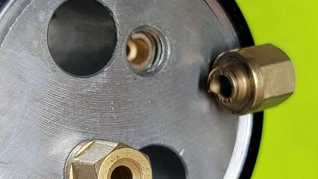

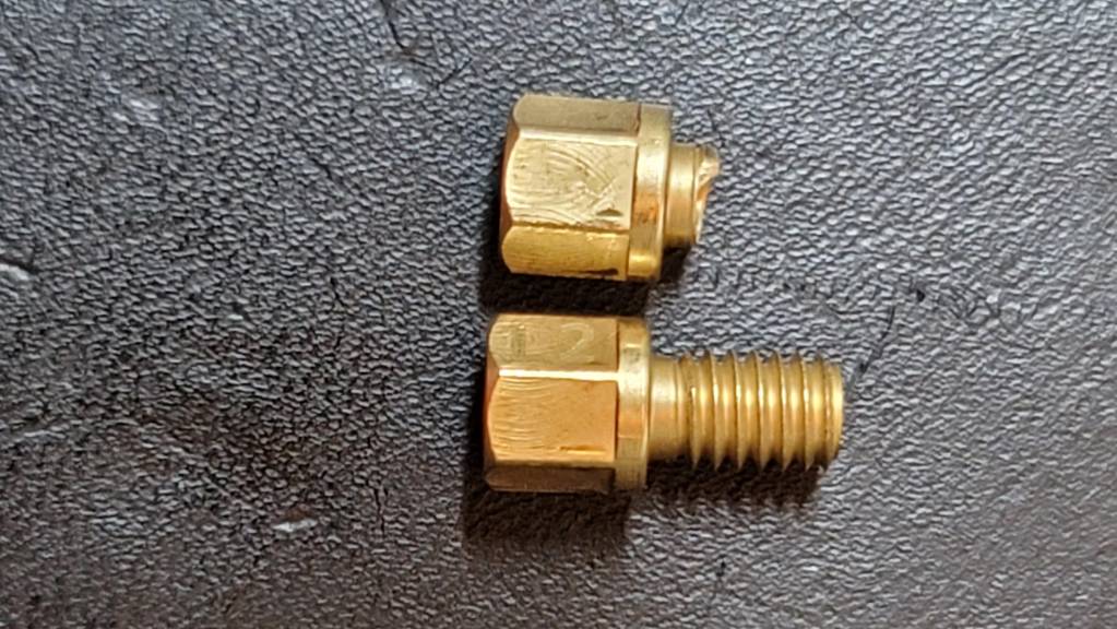

Well, someone had to be the first to do this but why did it have to be me???
I was swapping out the nozzles and when I went to tighten the 2nd new one in place, the threads on that new nozzle sheared and is now stuck inside the valve. Trust me when I tell you that I was careful about doing this as I am with everything...I got it hand tight and only wanted to give it another 1/4 to 1/2 turn past that with a wrench just like I did with the first one. Wasn't putting a lot of pressure on the wrench either but the head sheared off pretty easily.
Does anyone have any suggestions on how I can try to get the broken thread backed out of the valve opening? See pics below:
