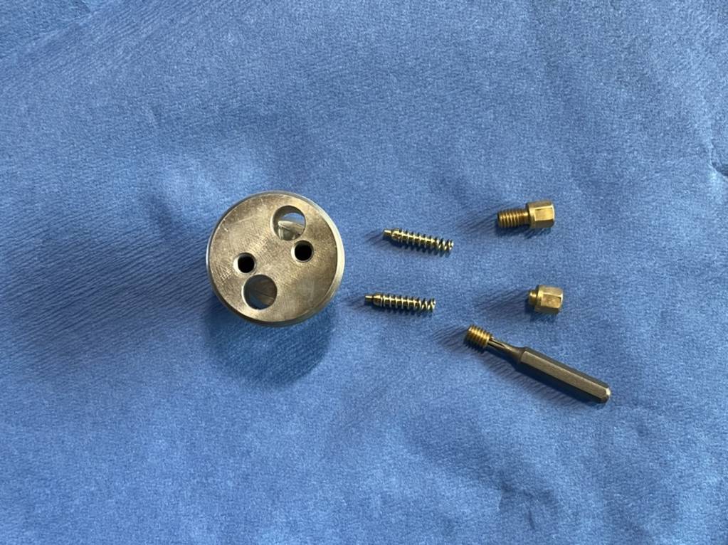

I'd try to get a flathead screwdriver a size so it just barely catches that outer part of the brass and slides inside the brass bit. Then gently drive it down so it bottoms out inside there.
It shouldn't be that tight so it just needs a bit of help. Just be careful because if you put it in there like a wedge it'll make it tighter.
^^ This won't make any dust or pieces and if it doesn't work no harm done.
Another thing you could do is get a drop of JB weld on a very small bolt or something and stick it to the bottom of the brass part upright. Let it cure and try to back the bolt out hopefully taking the brass bit with it.
^^ These are both assuming the lowest brass bottom is part of what broke off.
Or an easy-out (but gotta be on your A game with that.

For removing broken fittings like the jet , I’d try a Torx bit , gently tapped into the brass. I’ve used them through my career as a mechanic for years . There’s a slight taper to them so they really bite well into soft metals like brass or aluminum.
Got it out. The Torx T-7 did the trick.

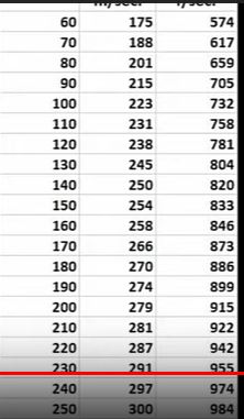

so here is the pressure/velocity chart from the edgun video for the 5.5 or .22 350mm.
i was under the impression that 130bar from the factory would produce ~915fps or higher, and this seems to say different. anyone know what the stock pressure and velocity are when shipped from EGW?

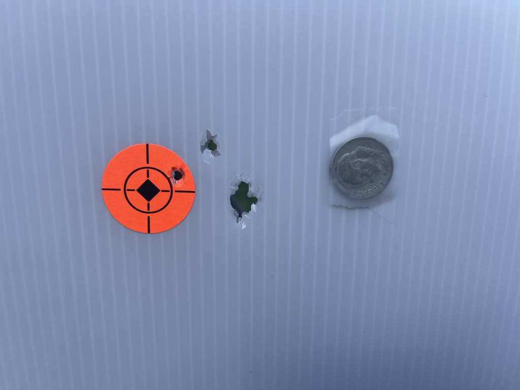

Granted this gun is 22 cal 350mm Alfa with huma mod 40…. Kat40 from egw. Just got it Friday so it’s still breaking in but it has grouped pretty good at 40 for a guy that is just a decent shot.

8 8at 40 yards, the two fliers were my fault. 20grain avs.

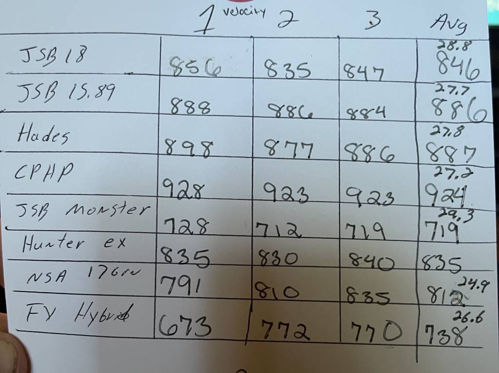

Yes it has the repr reg. It is shooting 15.89 at 916fps with a small adjustment from the previous velocities I posted. Haven’t had the chance to chrony it, but the 18jsb shoot almost as good as the avs slugs.
