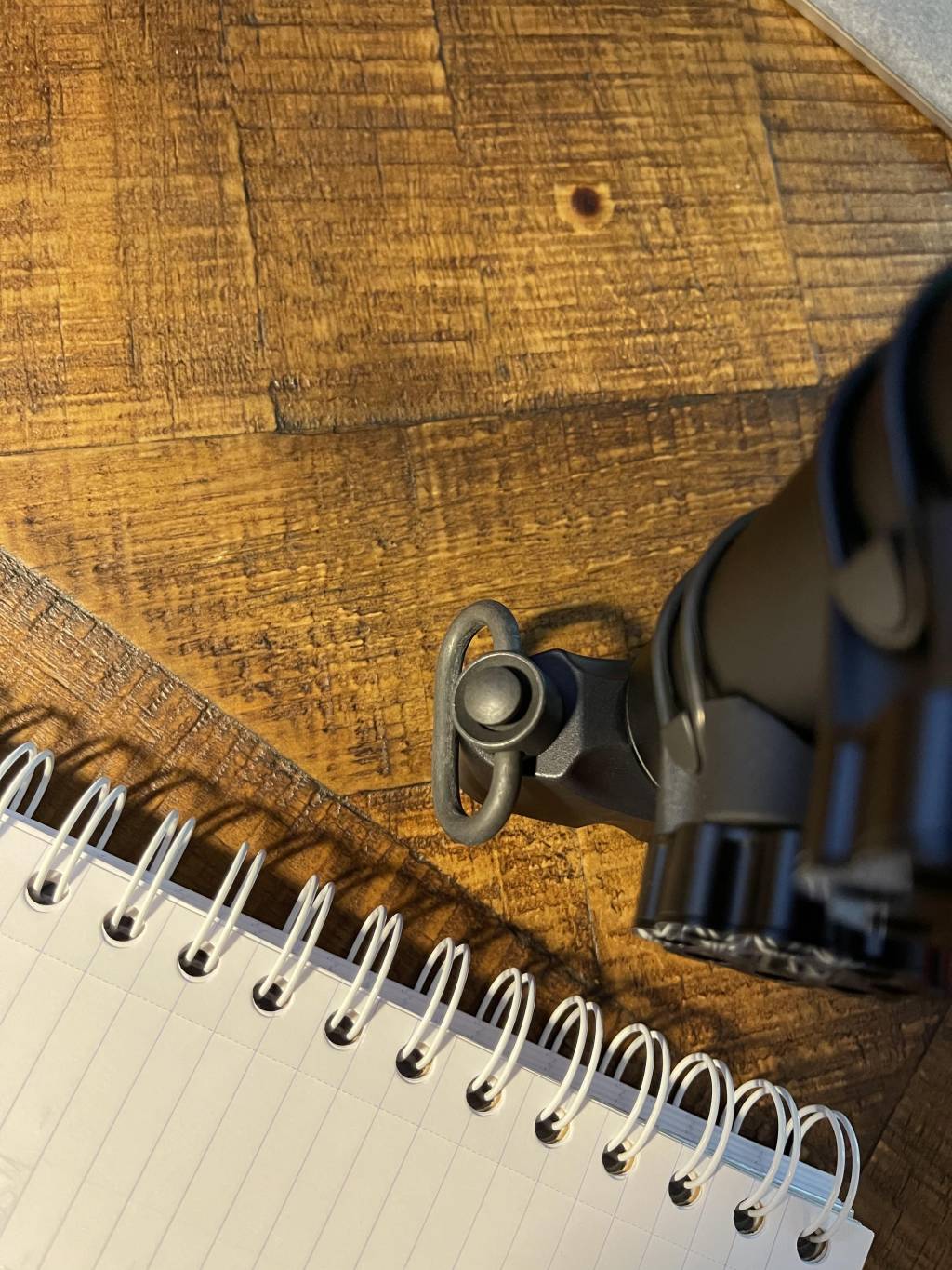

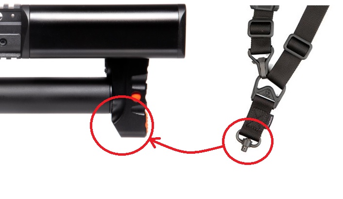

My QD sling doesnt fit in the gun... the male is narrower thant the butt hole so the balls doesnt retain the gun to the slrap. if i hang the gun hands free it will drop.
WHat king of sling are you using on your L2??? thanks

i cant post a real picture right now, but this is what i mean:
the male conection of the QD sling doesnt keeps in place inside the gun once installed... because the hole is much wider than the insert
i also use the magPul swivel which fits the ED Gun Leshiy’s butt hole(. I have bought some other brands off Amazon which are too small. I have learned to read the reviews on tactile gear that is supposed to fit standard mil spec . The cheap knock offs sometimes do not. Some reviews state that although the swivel seemed to attach in the stock mount, it pulled out in use. I would hate to have this happen and drop my gun on the ground. Would make for a bad day.
Maybe thats my problem....my swivel is not an original magPul. Definitely i dont want my leshiy2 to drop.
thanks mates for your replies

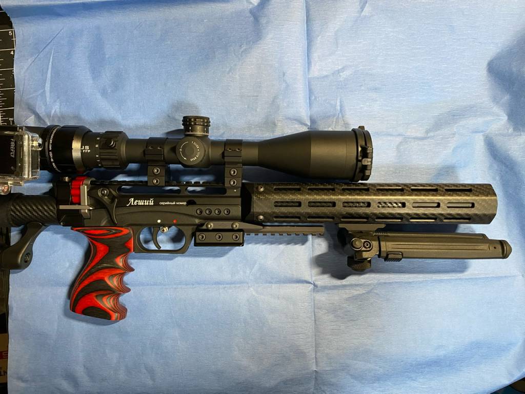

Anyone have a rail extension they like that extends the bottom picatinny for mounting a bipod further forward?
I’m using a Yankee Hill Machine Rail Extension, 6" (YHM-9473) along with a picatinny to ARCA adapter. Here is a pic and link.
Yankee Hill Machine Rail Extension, 6" (YHM-9473) https://www.amazon.com/dp/B07RQ17RDK/ref=cm_sw_r_cp_api_glt_fabc_W6MJ0TBNZWB5ZJHC249D
Thanks -- Happy enough with it? Stiff enough to use the very end to mount a bipod?
The Yankee Hill Machine Rail extension is a very solid extension. I’m using the M-Lok bipod cause it allows me to fold the L2 with the bipod attached.

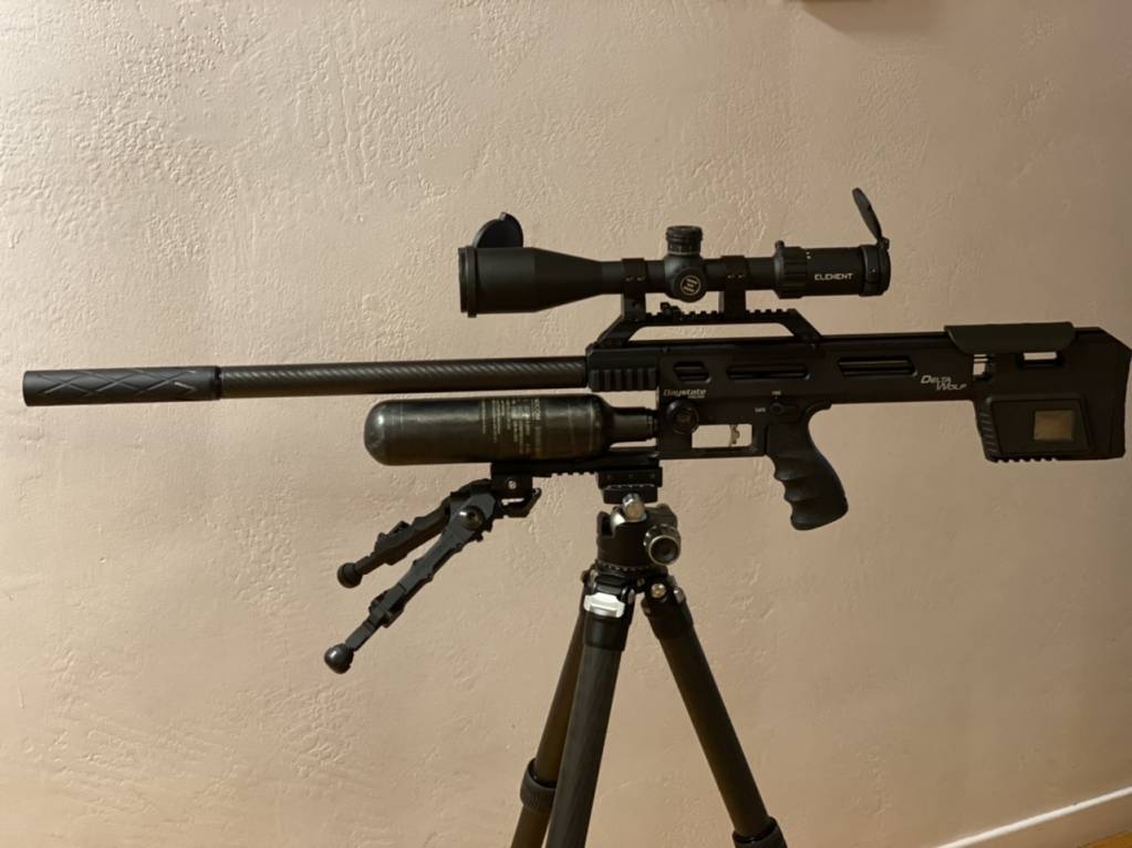

I’m also using the same YHM rail on my Delta Wolf with an Accu-Tac bipod as shown here.
edit. Typo

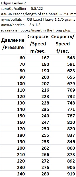

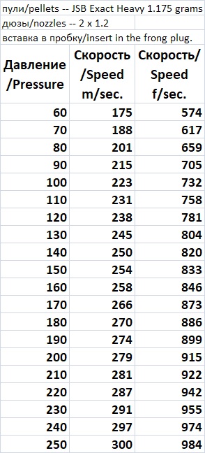

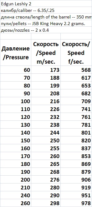

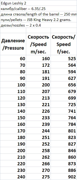

Some data for you guys, dependance of the speed of the pellet from the presssure.
Hello Ed,
What is the setup difference between the first two graphs you show? Clearly at 130 bar pressure the first shows 748fps and the second show 804fps both are .22 and using JSB heavy 1.175g with insert installed in front plug. The first graph states 250mm barrel so does the second graph use a 350mm barrel?
Thanks.
Thanks for clarifying Ed. GREAT GUN SIR!! :)
