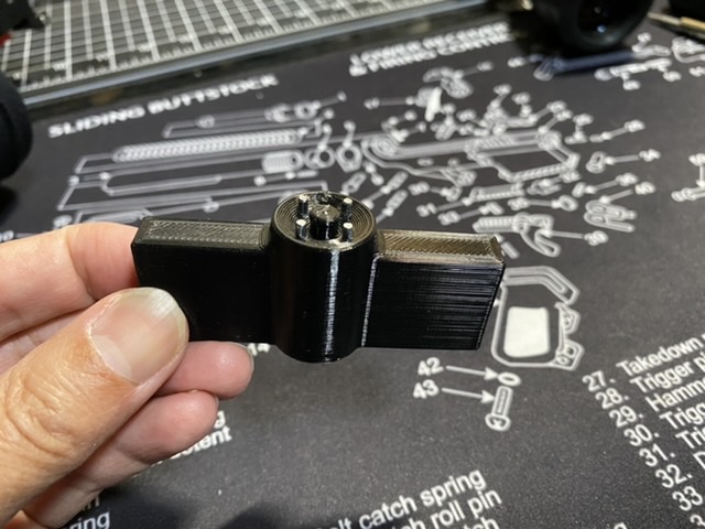

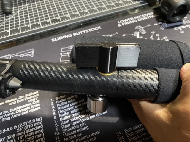

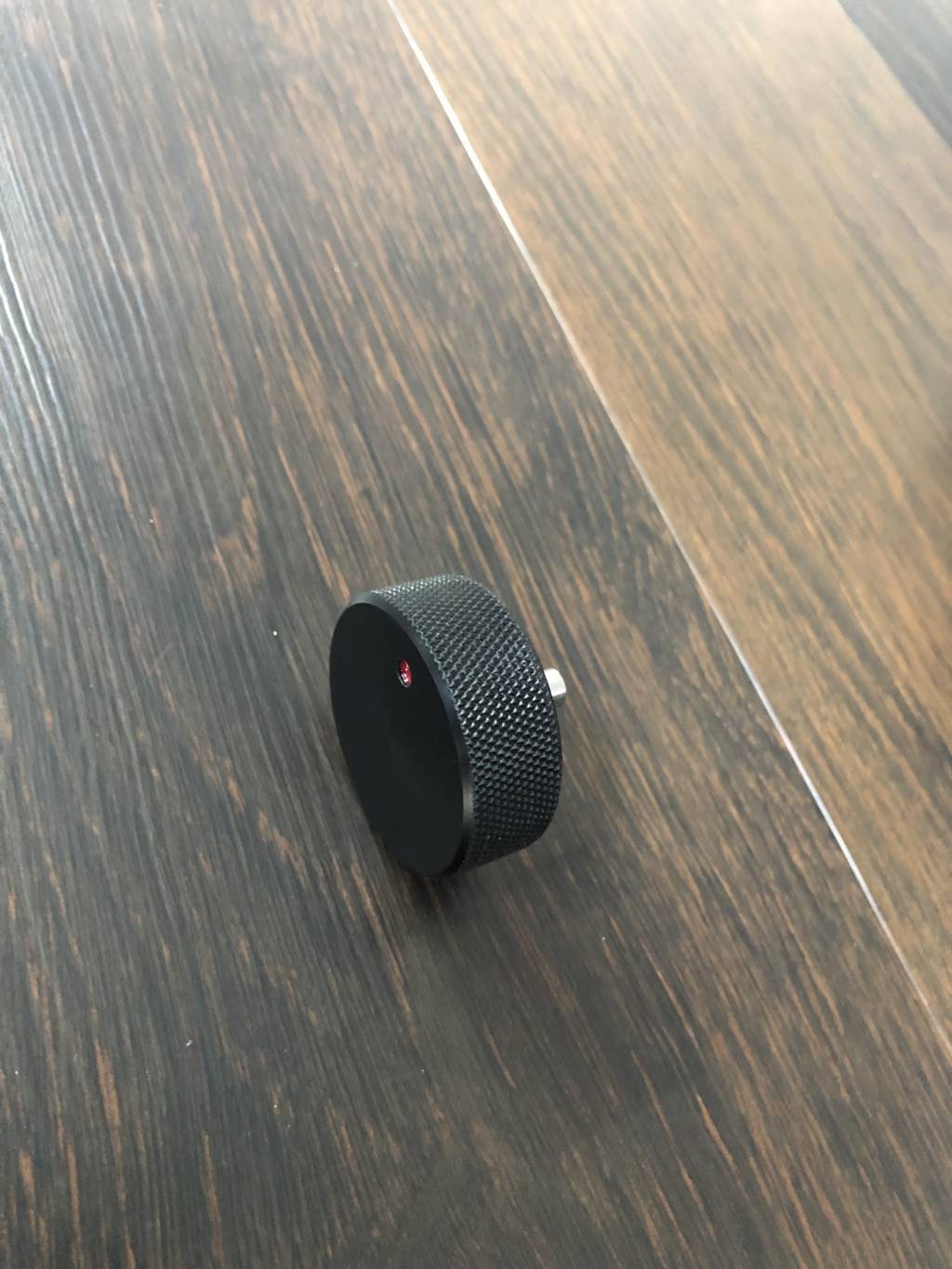

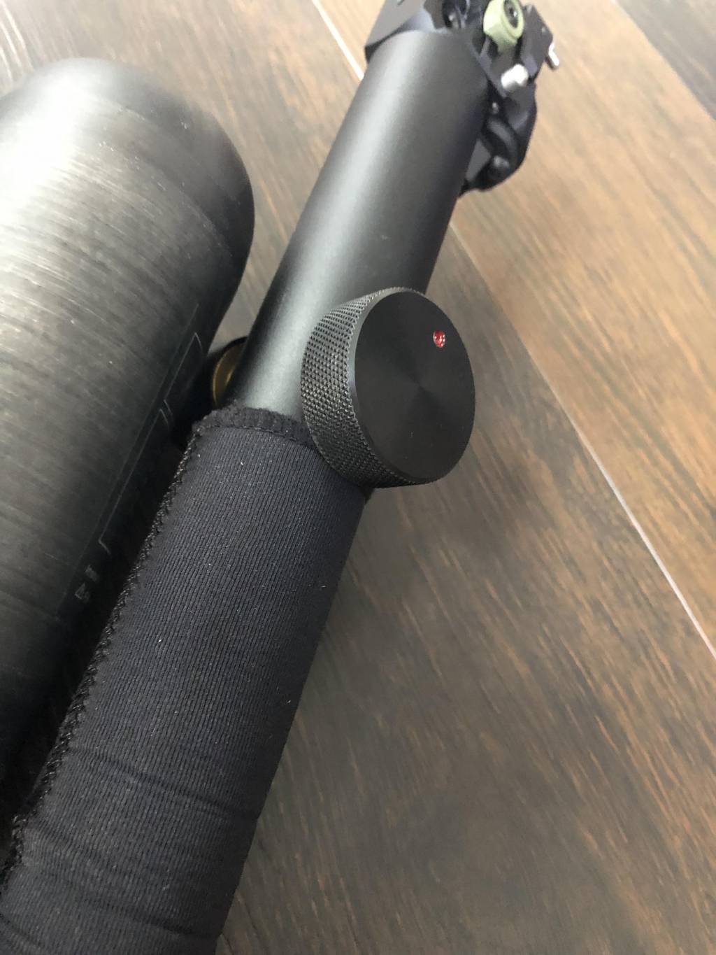

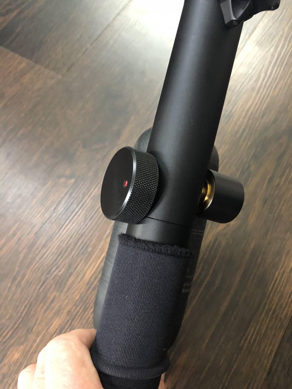

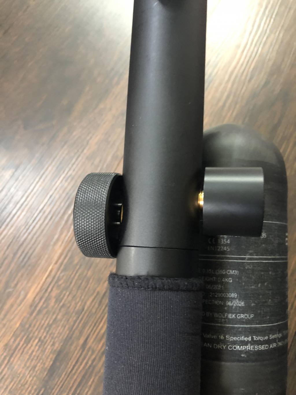

I made a REPR regulator adjuster for the Leshiy 2 with the external regulator adjuster. It’s simple and effective. I will make a few more if anyone interested. It will be in the classified.

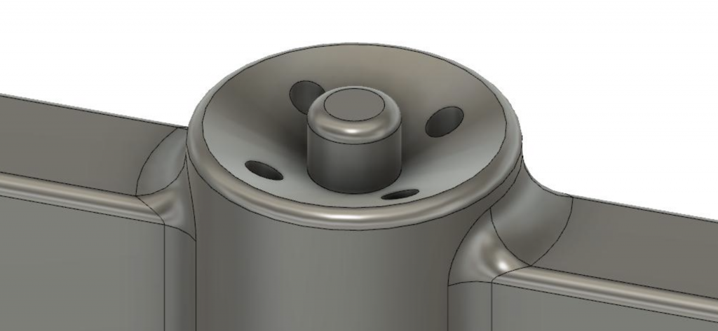

I was lucky enough to pick up one of these locally from Jack. I had a pair of Craftsman retaining clip pliers that I thought would work on the REPR reg - but I literally could not budge the adjustment valve with these pliers. I then purchased another set of pliers from Lowe's that allow for more leverage and ultimately worked but, given that you can only insert the tips into 2 of the 4 holes, I slipped a couple of time and could have potentially scratched the adjuster (or even the air tube) so even these new pliers didn't prove to be ideal.
I got Jack's adjustment tool and was very happy to see that it literally fit the 4 holes and curvature of the valve absolutely perfectly! I honestly don't know how he does it but Jack's been a genius with his 3D printer . . . he's created so many things that have been so useful with my various PCP's (if you're going to pick up one of these tools for your L2, ask Jack about his awesome L2 speedloaders as well - which are another must have for these rifles)! It's super easy to easily and consistently adjust my REPR reg with this tool and I don't have to worry about slipping or scratching the gun. Definitely worth every penny!
