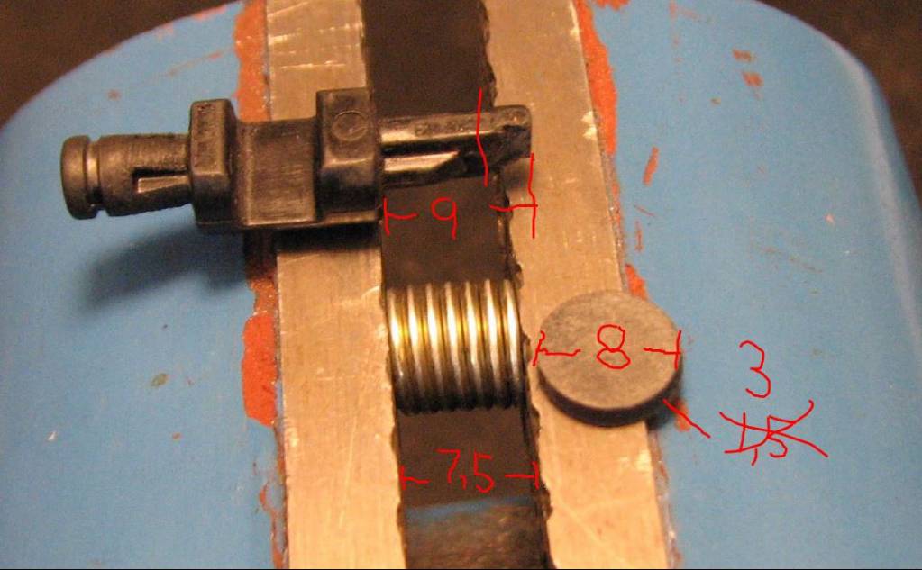

I haven't had any more cycling issues in over 2500 rounds. Now I'm just hoping that the plastic piston wont break, like some others have posted. But I hope that if, and when it does, they are readily available as spare parts, as I believe this is a potential failure point in the original L2, and sounds like it still could be in the newest version.
Don't panic if the top of the plastic piston fails, I had that happen, fixed it by adding a shim of rubber, so now the fully compressed spring against the rubber shim takes the blow at the end stroke instead of top of piston - gone through 15 tins of monster red. since without any indexing problem whatsoever
The shim is made of semi-soft rubber OD 8 mm x 3 mm

Just made a 1.5mm thick washer 8mm diameter from brass and seems ok, a few miss indexes but only at lower reg pressures, I also note the puck size makes a difference as well when using reg at lower settings 60-80bar, using the smaller puck 3mm hole works much better. At 135bar it works faultlessly. What reg pressure and puck sizes do you use Scott and Towle? I like the idea of using a rubber washer though, I might experiment with that too.
I am using new forward plug so using the recommended 2x 1.2 jets along with new EAR/REPR (.22 350mm barrel).
Thanks
Good job with the washer kiteboardkid.
Im using the original large puck that came with the gun. My reg is set to around 115bar with .5 & .7 jets. I'm shooting the 13.4 JSB'S at 860fps for 7 mags (54 shots) per fill.

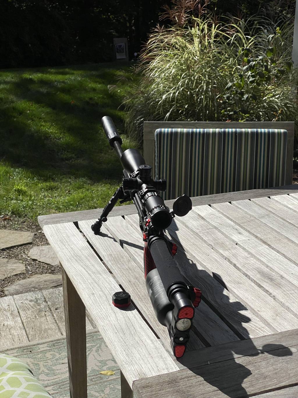

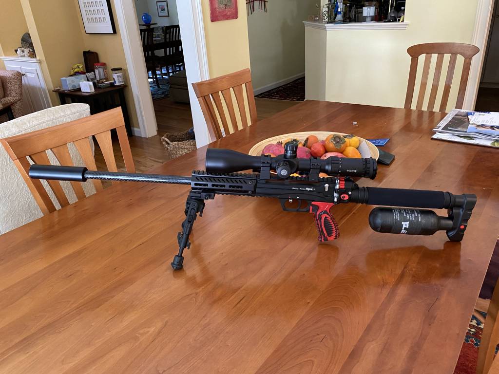

So, after waiting a while, I finally took the jump and installed a FX STX barrel in my Leshiy 2 this afternoon.
As background, I have a L2 in .25 cal and a 350mm barrel, with the Valkyrie handguard and Huma Mod40. This combination was shooting the JSB 25.4 grain pellets at 891 FPS, for 44.8 FPE. After reading a couple of threads regarding Cross Platform options for the L2, including the info from GlemChally and BigHUN above, I reached out to Geoff from Sub-12 Airguns on the UK and purchased three of his adapters for FX. Barrels to use in the L2. I have a number of FX barrels, including a Dreamline .25 cal 600mm barrel, and this was the one I chose to use for this experiment.
Basically, I had to remove the brass transfer port portion of the FX barrel and screw in the adapter. This was a hell of a lot harder than I expected, but heat, brute fore, and ignorance eventually overcame good sense and I got it off. From there it was easy to screw on the adapter, replace the FX liner and reassemble the barrel. It slid in to the L2 like they were made for each other!
All that was left was testing for accuracy and speed. At 25 yards the gun was every bit as, and maybe a bit more, accurate than the original. Essentiallly one hole with Air Arms (JSB) 25.4 grain pellets. One hole over 5 shots. On the FX Chrono it gave an average of 990 FPS or 55.3 Foot Pounds Energy. This is without any change to the regulator, just the barrel swap! I gained 100 FPS and 11 Ft Lbs of energy.
This is a real game changer for me, since I have a number of FX guns, not to mention barrels in every length and caliber from .177 to .30, and from 380mm to 700mm. Unlike a lot of people, I love the FX Smooth Twist liner system, and they have always been superbly accurate for me. Being able to use these in the L2 gives me immense flexibility at almost no extra cost, just the price of a magazine.
I love the looks, especially after I put a carbon fiber barrel sleeve over the barrel. I used the Huma Mod40, but it really is quite long, and probably overkill, so I switched to a FX hollow moderate. I actually think the longer barrel may even be a bit quieter.
Chris

kiteboardkid, thank u for posting about the spring. I have had indexing issues for weeks, watched the video at least ten times and took it apart about 5 times looking for the fix. After reading your post, I stretched the piston spring and 10 mags later still no index issue. This forum has once again saved my ass!
Welcome Sir :)
I believe these Springs should be made of a higher grade spring steel. They shouldn't be deforming this much so early in their life. Awaiting to here if these will be covered under warranty by Edgun Spain. The cost of these springs to Ed will be pennies but not so easy for us to obtain from 3rd party suppliers like simple O rings.
That make sense, more back pressure for the piston to work
A washer made of rubber will soften the blow on the top stroke where the spring is fully compressed and hopefully save R2D2 from getting a headache
I'm using the largest puck, jets as from factory, don't no if the change the setup on the new version but if not it should be 2 x 1.2mm

If using .177 calibre, I would try using a maximum 4.5mm puck and in fact you'll probably find the removable magazine plate only has a 4mm hole, so in theory there is no point in having a puck size bigger than 4mm.
the "new forward plug" just has a couple of extra pieces of plastic inside to reduce volume. I note Jake in the above disassembly video has gone to 2x 1.4mm jets but he is running Sub 12ft lbs I believe.
The indexing spring should not compress all the way. I did not watch the video or take mine apart. Just mentioning it because everyone keeps saying it compresses all ths way to solid. Springs should only compressed 80% of travel. If you compress to solid even once you start to reduce lifespan rapidly.
If someone can answer, does it actually compress to solid or not, I would love to know.
