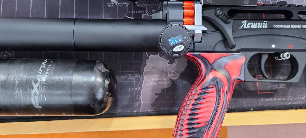

Anybody have a source for a Plenum with BSP thread for a gauge?
I am absolutely not interested for a REPR, my Reg is working way better as seeing how many unhappy campers with that.
I would have a good use for a gauge on the plenum. At this moment I have an adapter attached to a bleedscrew port only to monitor the performance.
908 fps with .22 AA Field.
Looks like nobody is currently making a non REPR plenum with Reg and gauge integrated.

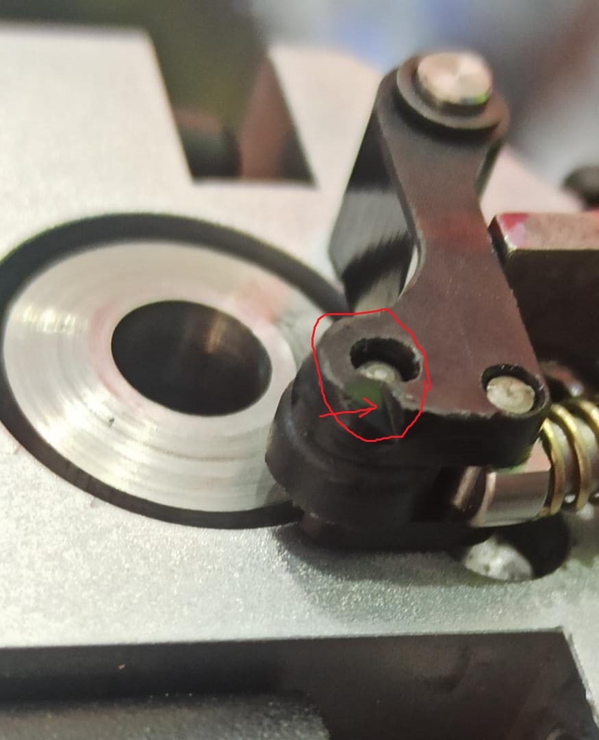

Need some help my L2 safety does not work I have adjusted the screw behind the trigger and either the safety works on safe but won't fire when you switch to fire or fires on both safe and fire can not get to a point where it works properly. Any Ideas
Did you change the grip? If so, you might be screwing in the grip screw too far which can interact with the safety. You might need a small washer/spacer behind the screw head.
Can’t believe this poop it worked like it should Saturday I picked it up tonight to air it up and my finger hit the trigger gun went off ( mag was empty ) but I always put it on safe when I put it away so I looked at the trigger and it was on safe 3 hours adjusting the trigger screw and can’t get it. Need to put it away till tomorrow before I really lose it and smash it
