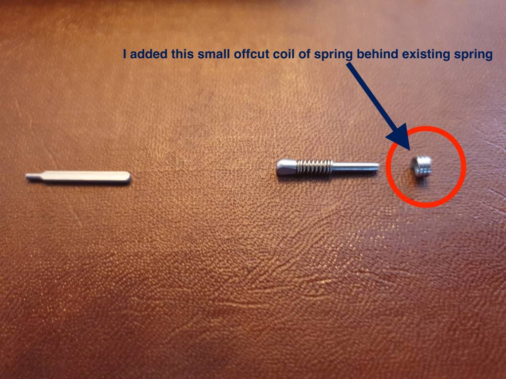

Yup.first thing that broke on mine too. Some super glue and it kept going for another 2 months... Thanks for the Ebay link, I'll give that one a go.
Was in the US for a short visit and thought I could pick up some parts from him. Didn't work out obviously.
Down page 94 this tread Comtruise fixed it with a short coil
https://www.airgunnation.com/topic/edgun-leshiy-2-2/page/94/

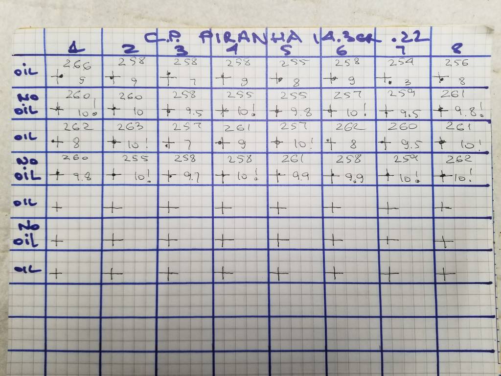

Highly recommend to try Crosman Premier Piranha 14.3gr. It goes better than all JSB's and H&N's on my .22 L2 with 350 and 450mm Alpha barrels. Indexing magazine with a white mark helps me to understand accuracy of every shot in the same mag hole shooting position and no blanks. Based on the chart below at 25 yards away, mag hole #1, #3 and #7 is the worst magazine holes. As you can see no FP-10 and other lubrication needed. Sorry using Russian chrono to measure in MPS. This OEM REPR tube set up gives me 95 to 100 shots per fill on ~855 FPS. I'm using Ultrasonic Cleaner to clean Crosman Premier pellets.

Nice test there. Keep in mind that the barrel will retail lubrication and there will be different parameters needed to test that variable.
