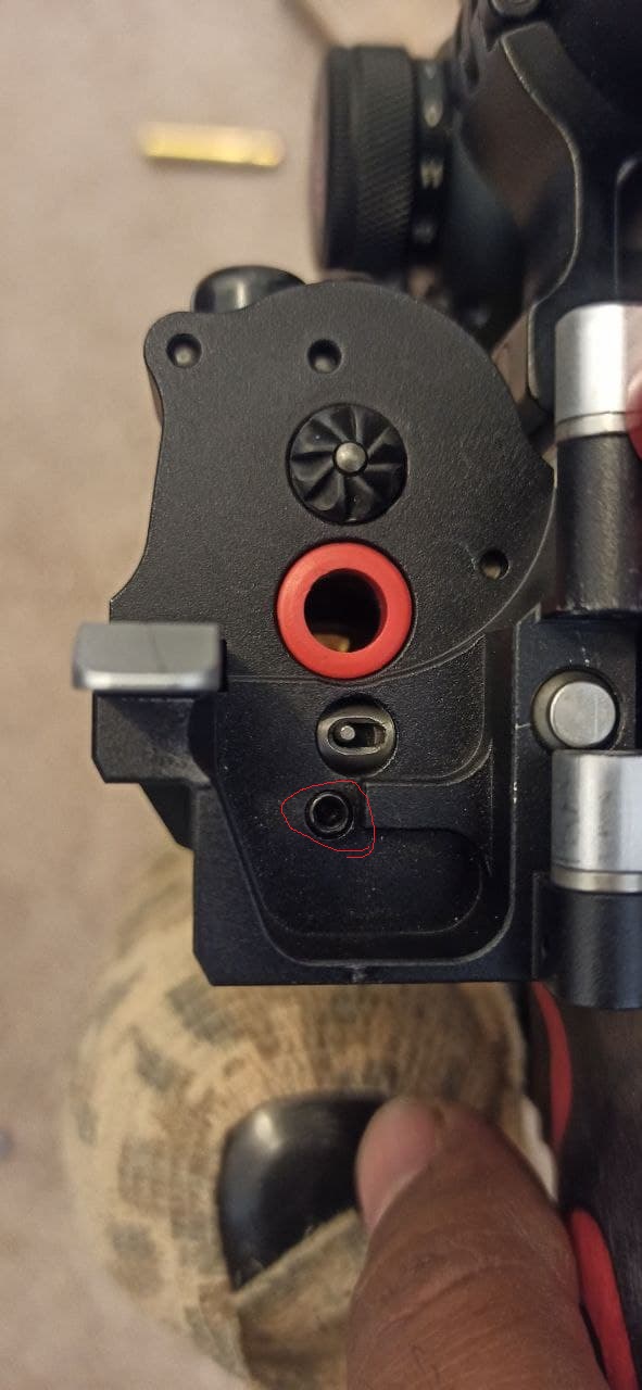

how much i should open this stopper pin?

Watch the barrel installation videos and reseat the barrel. My friend just did that and he's back to great performance. Thought he had ruined the barrel due to all the fliers but it was just an assembly issue. It seems like a simple install but it's actually critical.

Thank you Sergey1972, I will look into that. Does it matter that I've never actually had the barrel off the gun?
If it does have that problem, it came with it from the U.S. dealer.
Yes, it does matter that you’ve never actually had the barrel off the gun, “because… shipping is not a gentle process”.

I noticed my barrel was a smidge loose when I got the gun out of the box. The Leshiy 2's sold in Canada come from EdGunWest, so they're probably in essentially the same condition as when purchased in the States.
I noticed after firing it two or three times, it stopped cycling correctly. So I loosened the barrel, seated it properly and tightened it up again. Has been working great since.
