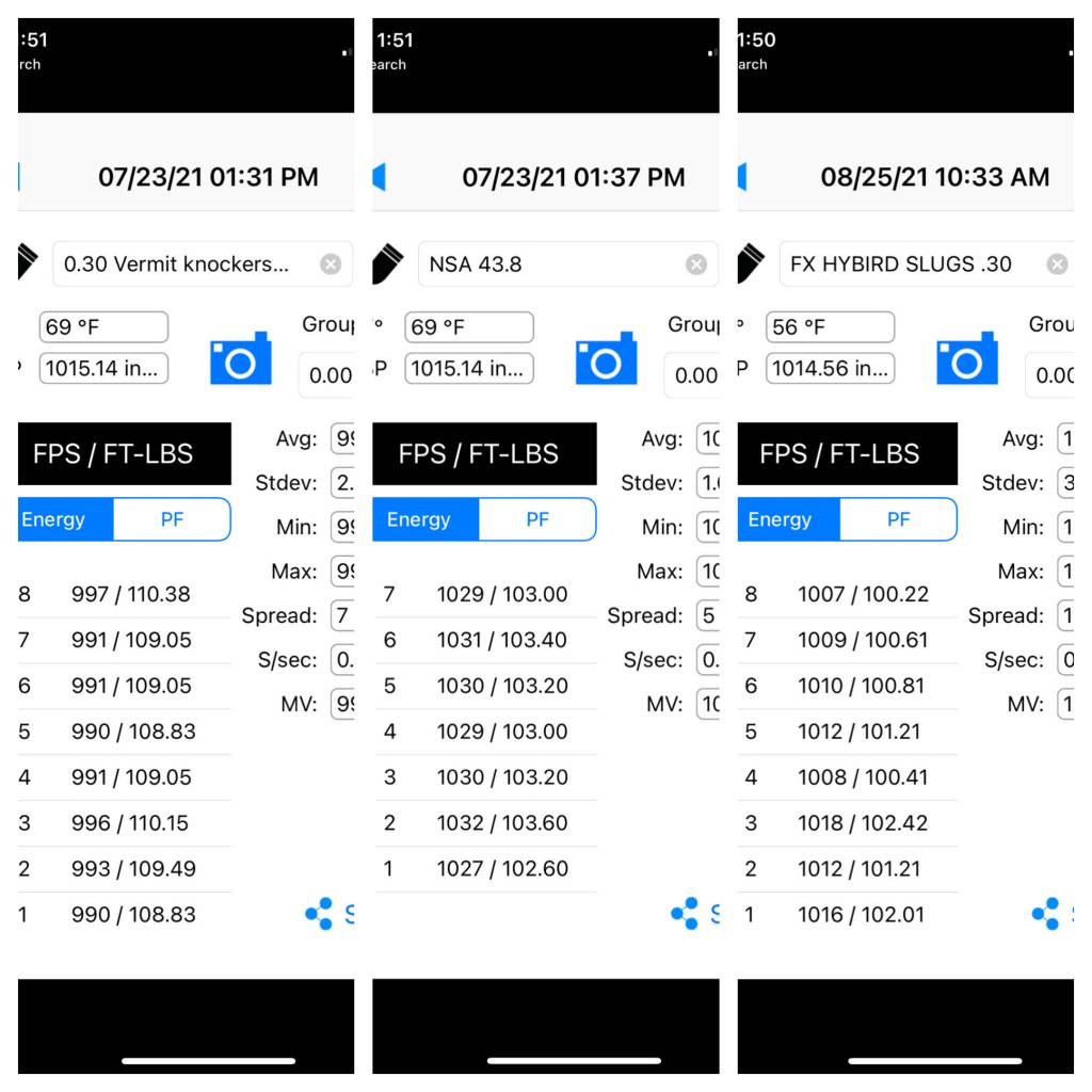

 I’d recommend you get a regulator wrench so you can increase the regulator pressure to give you some more foot pounds of energy. I believe the stock reg pressure is 130bar which gives you 790fps 60 foot pounds of energy(at 75yards 39ft-LBS 51/2” of drop) JSB Exact 44.75gr. 150bar= 814fps and 163= 827fps. I believe if you want to get close to the performance 10-22 you will need go with one of the longer barrels and a smaller nozzles/jets. With my 600 mm barrel and a single .4 nozzle/jet I can shoot 44gr and 50gr pellets and slugs around 1000 ft./s with over 100 foot pounds of energy with a much flatter trajectory.

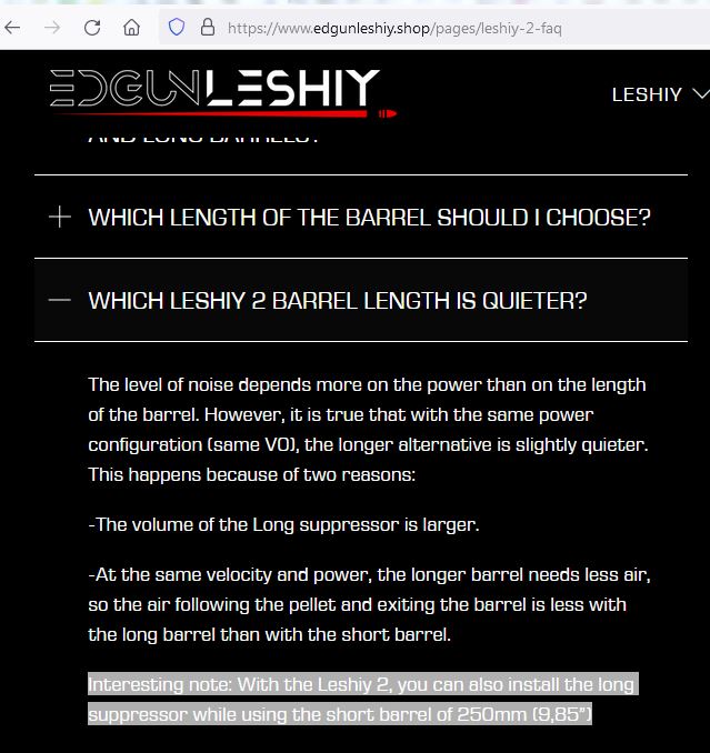

air comes out around the magazine, so for the shooter with his ear right next to that it will be loud.
i did some testing and found that even with the gun doing 80db from 5' away, it will be 95db at the shooter's ear.
you can use a puck with a smaller hole, and this will help. i think some folks are putting something on the magazines to reduce the space where the air can escape.

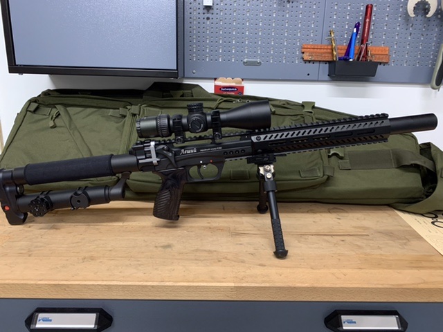

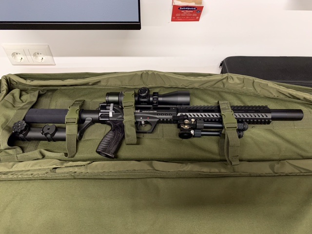

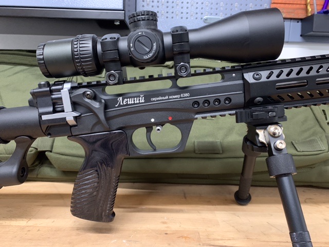

by the way this is my beauty
