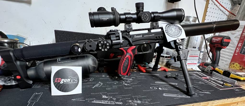

by the way this is my beauty
looks sweet!

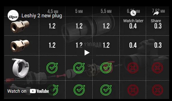

egw posted a how-to for a quieter low power setup that might help. he is bore matching the puck size and i think you could adjust from there.
https://www.youtube.com/watch?v=w7UDeqJYXXk
looks sweet!

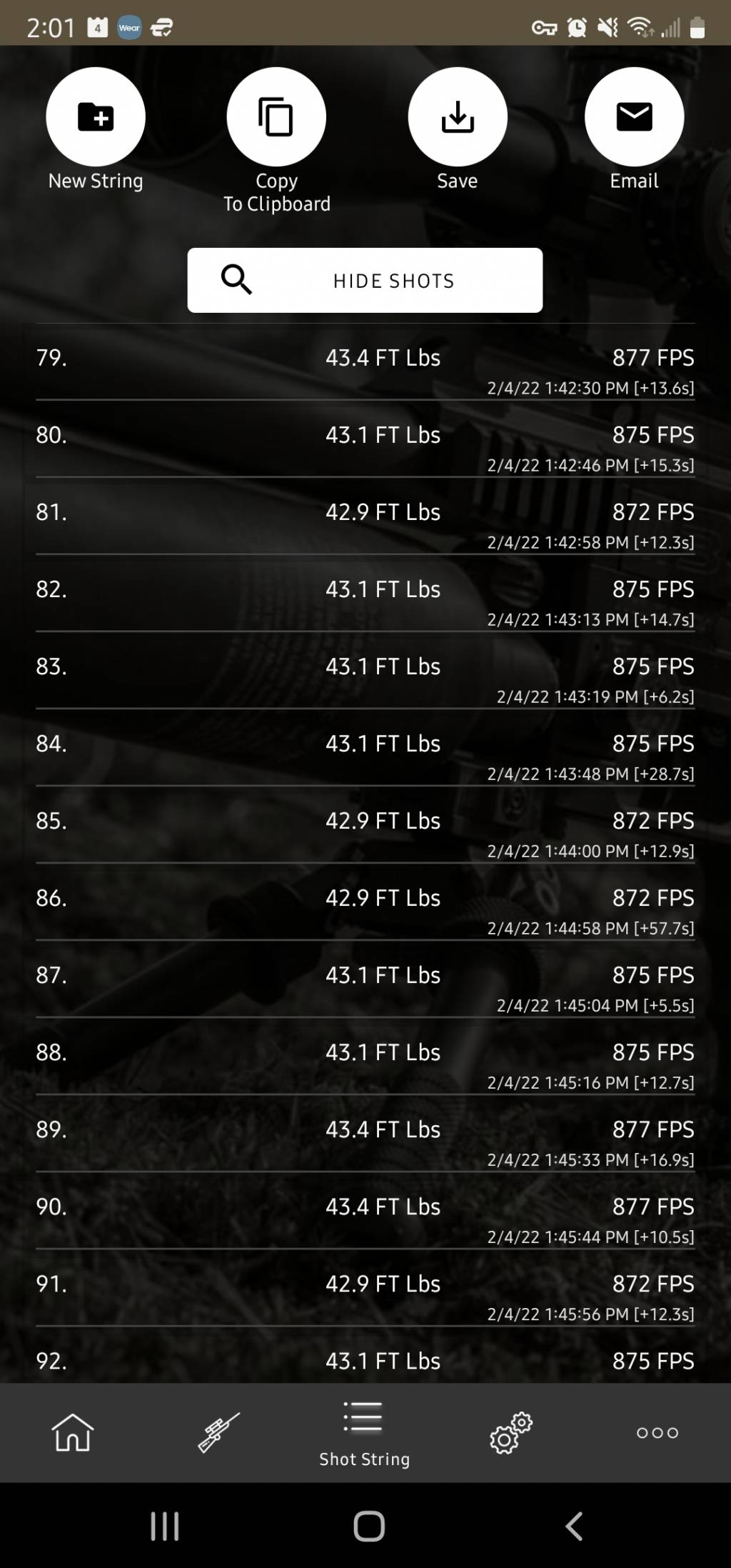

Shot my leshiy over the chrony and wasn't satisfied with the ES. It was shooting with 10-25fps variations. So I read through this whole thread. And decided to turn my valve stop adjustment CCW a couple times. Testing between each adjustment. Check out this shot string with 18gr fx pellets. Ignore the fpe in picture, I didn't set correct weight in the fx chrono.
Very impressive!

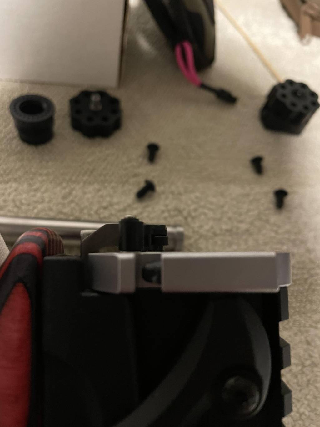

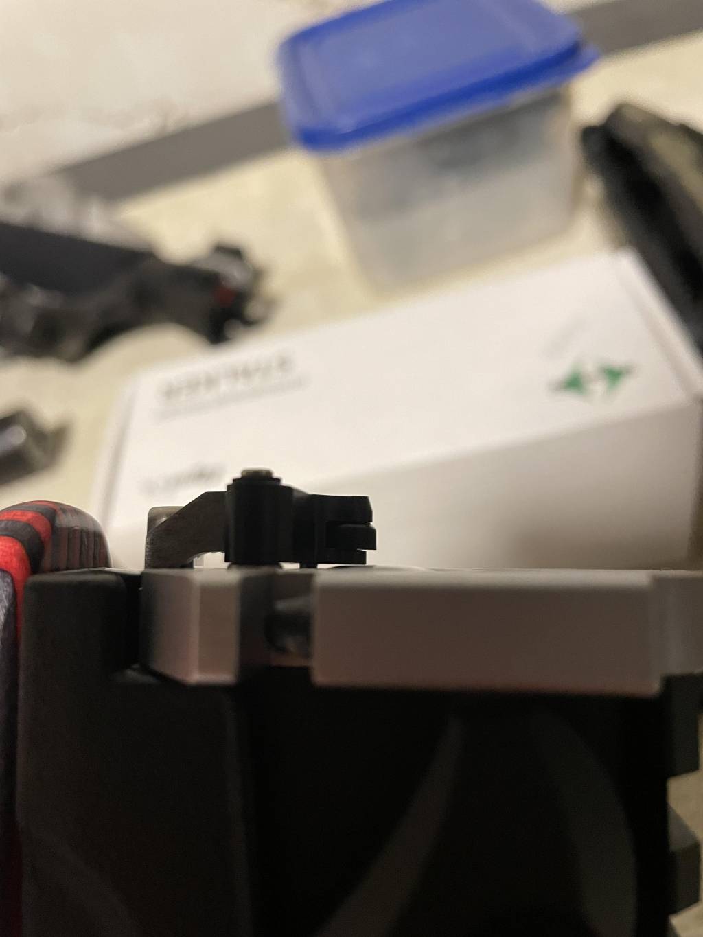

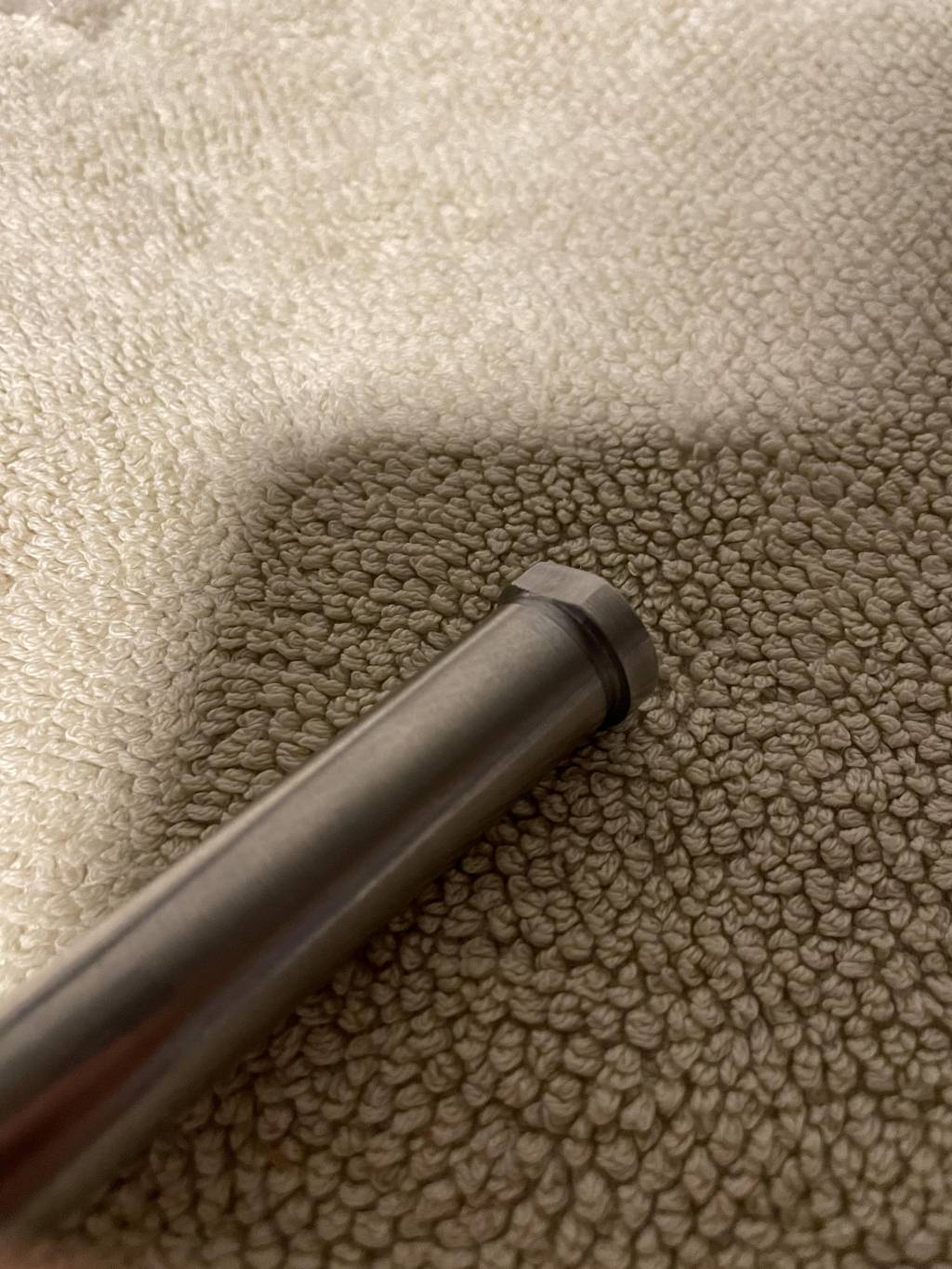

Received my (new style) .177 Alfa barrel today.
Looks great, but the gun won’t cycle with it. Looks to me like it can’t be seated deep enough to not interfere with the magazine. I have checked everything carefully for debris, and pulled the barrel forward when tightening the bolts. Magazine will not index until I open the locking lever.
Gun cycles perfectly with the old style LW barrel.
Please look at the two attached pictures, first one is the new Alfa second is the LW. Might be hard to see from the pictures, but the LW is flush and the Alfa ain’t.
Any ideas to get the gun working?
Uh oh. Great idea but now quality control problem. I like the original design without clip. Barrel can be taken out the front of the action and installed from the front so moderator can stay on. I have no problem finding the perfect gap between barrel and magazine but the split ring and now the machined lug is a goober proof design. Hopefully this will be fixed before many get out to customers.
