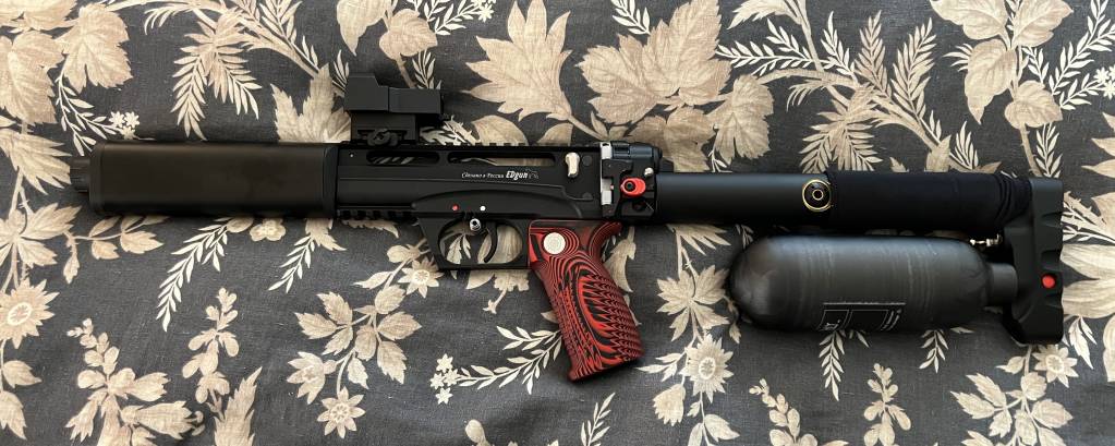

I think I have found a solution for my application.
I'm pretty sure I need the foot pounds of energy from the .30 caliber. I could consider slugs in a smaller caliber but I think I will stick with pellets for now.

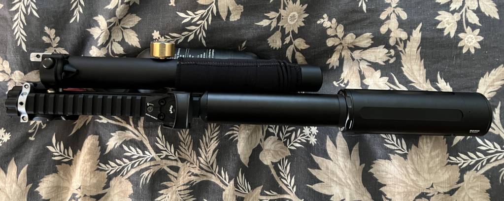

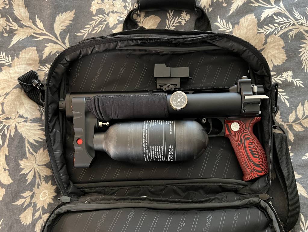

I like the handling qualities of the original shroud plus the butt stock folds up tight and locked. Using the 250 shroud allows the gun to be stored folded in an amazingly small bag.

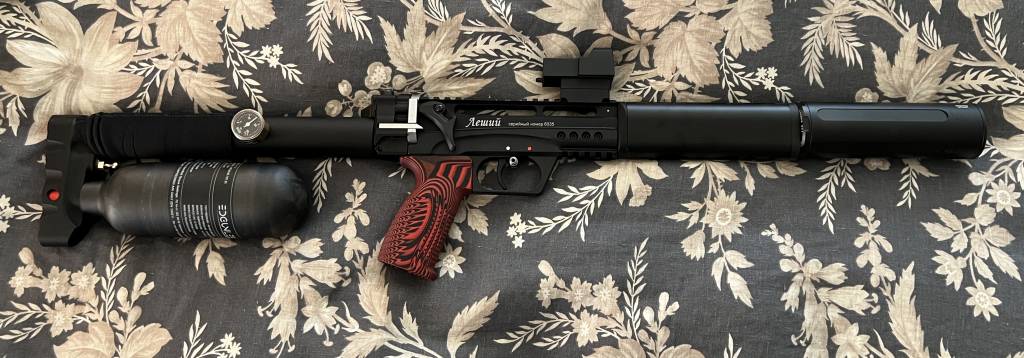

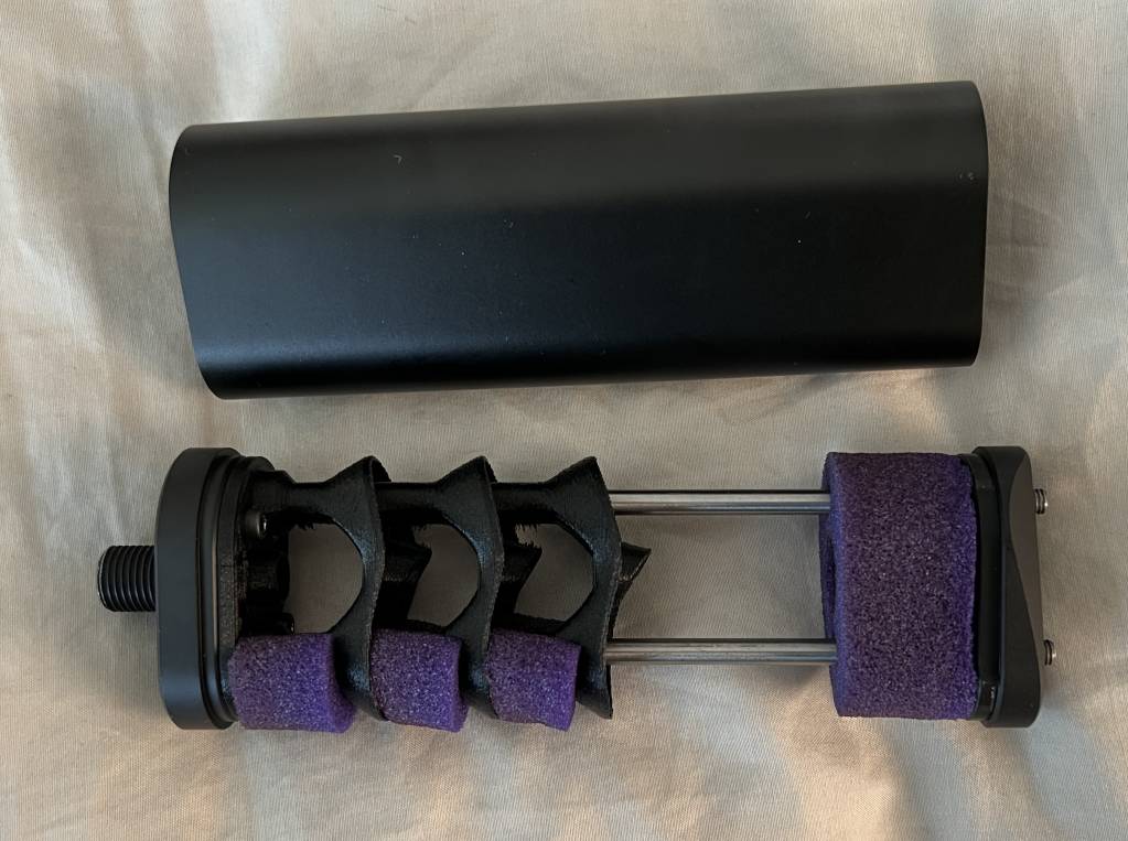

The problem is the 250mm barrel with 250 shroud has a serious bark to it in .30 caliber. I found the short silent thunder ordnance (STO) insert helps reduce this bark significantly but probably still not enough for back yard plinking.
Using the 250mm barrel with a 350 shroud and the long STO insert totally tames the bark of the .30 caliber. Problem is I loose the extremely small bag storage benefit. I could remove the 350 shroud and store the gun with just the 250 barrel but it is a bit of a hassle to R&R the factory shrouds.
The solution I came up with is to install a Striplin Custom Gunworks threaded adapter to the 250 shroud. This way I can store it in an extremely small bag and quickly add my Ronin if I need more suppression. Pretty slick and works great!
With an open reflex red dot the gun is perfect for quick handling on rapid moving targets at 35 yards. The combination of the STO insert and Ronin is very quiet even with the 250 barrel in .30 caliber. Right now I have the reg at 150 BAR and shooting 44.8 gr FX @ 760 fps. That's about 23 ftlb and seems the most stable. I can move it up to 160 BAR but loose some stability and mostly adds noise with the 250 barrel. I have not messed with the jets yet, I assume they are both .3.
Certainly a fun gun to shoot, extremely handy and powerful yet quiet.

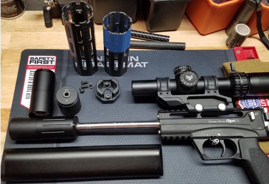

I'm having some issues with a Valkyrie Carbin Fiber handguard for my Leshiy2. So I was wondering if any of you ran into this issue before.
The CF handguard is not cut correctly in a 90 degree angle on the end that connects to the adapter. So if I mount the handguard it will push against the Huma LDC depending on the orientation. In other words it looks crooked and pushes the LDC.
Is it normal the have to go and sand of the CF handguard to get a correct straight alinement?
The ordering also went a bid strange so I'm thinking this is a returned product.

I was cutting and squaring my carbon fiber arrow tubes for two decades and I can say it is very easy job to square a larger OD (or hex or oct) tube maybe 5 minutes of sanding if you know what you doing. btw if you go that path don't breed in that dust but good enough to move your face away for arm lengths, if you don't have a shop vac.
